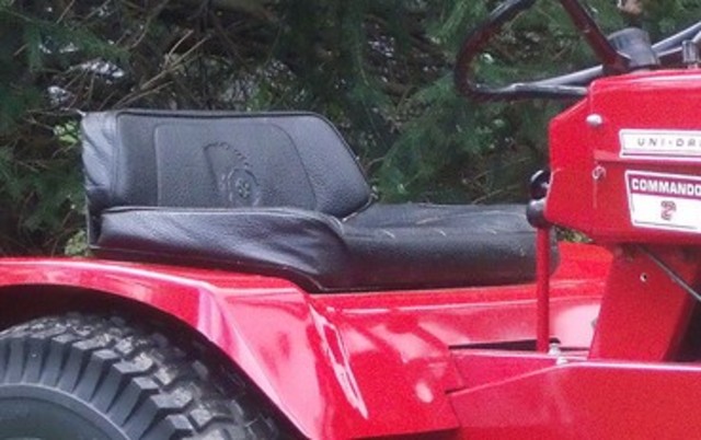

Not to jack your thread up, but I'm always looking for a good condition, or restorable factory '68 Commando seat. :popcorn:
They looka likea thisa one...
Fun Engineer
No problem Craig. I feel your pain. I'm looking for a newer seat with the 7 inch by 7.5 inch bolt pattern for this Commando. I have a seat pan but the vinyl is shot Non of the neweer seats have the same bolt pattern and I don't want to drill any new holes in the fender pan. I don't have the time to try and find another good original. I currently have a friend at work that does boat upholstery making me a seat for my 67 Ranger. If it turns out I thought I would have her make a seat or two for my Commando and any future short frame I work on. My 857 had a beautiful seat on it when I got it. I had another family friend replace the very top panel on it. Cost me $40. Way too much to spend now a days. The friend at work thinks she can do the whole seat for under $50. We'll see. I'll let you know if your still interested in a reproduction.

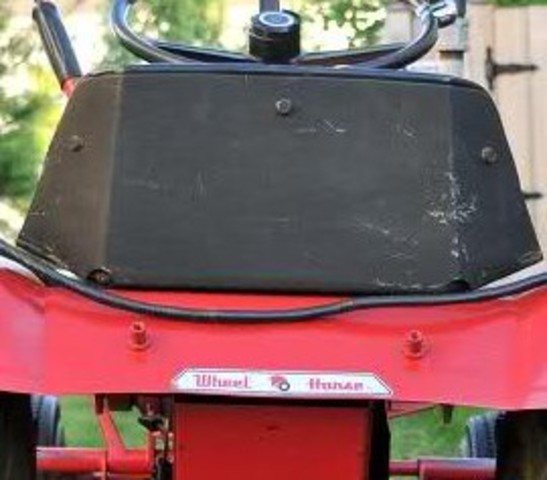

Where did you get the white front plastic emblem thingy? I desperately need one and the things to hold it on.
Also, I kinda need a new seat, I don't know that an upholsterer could make one with the emblem and fancy pattern.
Great work BTW!
rmaynard
In case you're interested, the rears are Carlise 23x8.5x12 and the fronts are Deestone 4.8x8. I've had the rears for about 10 years waiting for the opportunity to use them.
Arendtsville, here I come.
Dave,
If you have your camera handy, can you post a shot of the front tires taken from the front, not side? I'd like to see how the width of the 4.8 tire look on those 3.5" rims.
rmaynard
Great work BTW!
If you are talking about the escutcheon plate that covers the hole where the lights go, it and the mounting nuts are still available from Toro.

Fun Engineer
How's this Bob? I actually had this in my photobucket.
I had my originals all cleaned up and ready to reinstall but I decided that since everything else is either rebuilt, repainted, replated or new including the rear tires, I better put some new treads on the front so this one will last another 44 years. I also looked at the 5.7x8 but thought it was too tall and didn't like the way it looked on the wheel. Not saying that there is anything wrong with the 5.7x8 for those using it. Its just a personal preference.
Here's another angle.
rmaynard
Thanks for the pictures. Your tractor looks fantastic. :thumbs:
