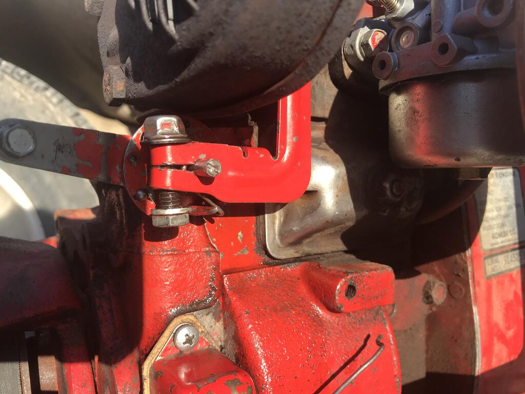

KSU_COWBOY*$ 0 #7 Posted May 3, 2020 I have a 161T on a trobuilt Horse. We replaced the carb, but couldn't get it to stay running we started the tiller blades running. Wasn't in dirt yet just on the bracket, so free wheeling. Looked like the pin was above the arm so we moved the pin below the arm. With the spring inthe tab slot, seems the governor is all the way open. we moved the pin until it is one hole away from teh spring tab, hoping to take compression off the governor arm to allow it to slow down. Just need a little guidance. Please and Thank you. Picture showing teh the pin, sporing tab and placement of of throttle cable in the disc would be appreciated. Share this post Link to post Share on other sites
