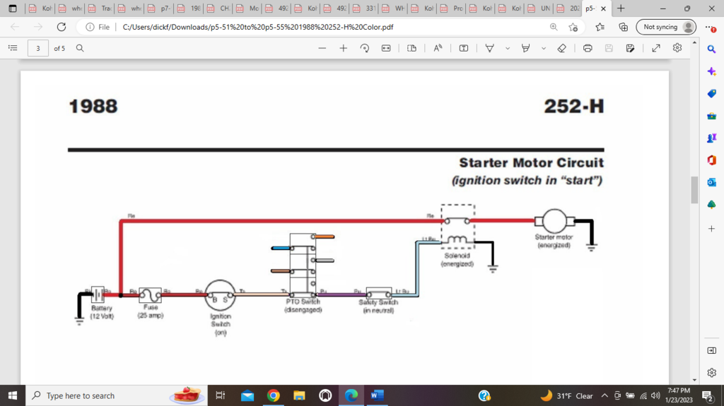

mike avad 60 #12 Posted January 23, 2023 is there power in them wires for the seat switch and brake switch? sorry am new to this wheel horse.on my 252-H if that brake not down it wont start. how to tell if they go bad? 1 Share this post Link to post Share on other sites
953 nut 66,056 #13 Posted January 24, 2023 On 1/22/2023 at 7:03 PM, mike avad said: is there power in them wires for the seat switch and brake switch? sorry am new to this wheel horse.on my 252-H if that brake not down it wont start. how to tell if they go bad? The seat switch isn't involved with the starter wiring but the PTO and brake switch are. Download this wiring collection for your tractor. Share this post Link to post Share on other sites
