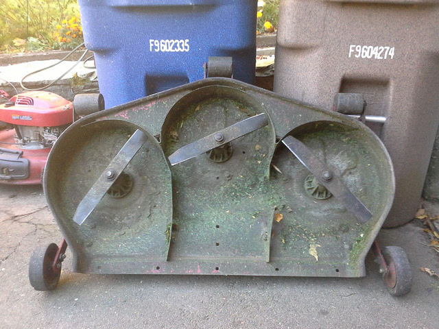

ScottCT 15 #21 Posted October 20, 2013 (edited) Hello all, I was searching for mulching options for my 42 RD deck when I stumbled upon this. I realize it’s been 2 years since the last post but I hope one of you can help. I’m interested in purchasing one of the mulching inserts but wasn’t sure if you can ad it to any 42 RD or if it only fit certain ones. I have a 95-42MR02. Thanks for any help. Edited October 20, 2013 by ScottCT Share this post Link to post Share on other sites
gwest_ca-(File Mod) 12,511 #22 Posted October 20, 2013 The 86001 will fit the 1986-1988 05-42MR04 deck but not listed for anything older. The 95-42MR02 is a 1979 deck. The kit may fit with modifications - don't know. It could be impossible or may require a few holes drilled. Garry Share this post Link to post Share on other sites
ScottCT 15 #23 Posted October 21, 2013 I removed the deck today to refresh my memory as to how the deck is configured. It has welded in factory baffles so it look like it would take heavy modification to make the insert work but I think I might be able to fab something up based on the picture poster above. Share this post Link to post Share on other sites
