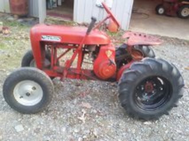

Suburban 550 28 #37 Posted August 22, 2011 Sadly, I missed the Dover, Pa. show this weekend due to insurance issues over the wrecked camper, but it gave me some time to spend on the 701. Got tired of lookin' at that hinged hood and yesterday was the day to get it done. So far I got the front end all tightened up, engine all tuned up, redid the wiring and startin' to reassemble it to make sure everything is ok before it is all takin apart for paint. Here are some updated pics. Hood all welded and fishplated from behind with no more hinge Slots were cut in the rear of hood to slide down over the bolts in gas tank Hood all fitted up with some reassembly being done Share this post Link to post Share on other sites

Suburban 550 28 #44 Posted November 13, 2011 After a long time away from here and the garage, I finally made up my mind while I have some free time, today would be the day I would get out there and clean up the garage and get started back on the 701. Tractor parts and tools all over the place and no time to get anything done. Haven't done anything to it since August or September and hopefully by the end of the day I have at least a clean garage and a rolling chassis. If anybody has an original picture of what the side drive belt cover looks like I would appreciate it. The cover I have is missing the bracket where it mounts on to the engine and was wondering if it had belt guide tabs on it or not. :wh: Share this post Link to post Share on other sites

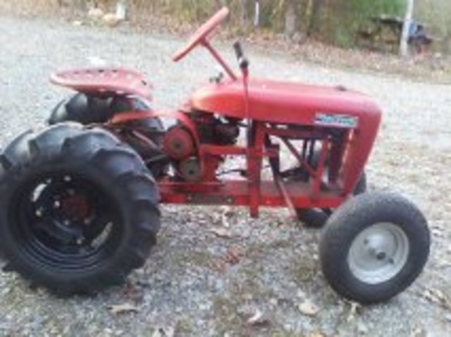

Suburban 550 28 #45 Posted November 13, 2011 Well, I got alot more done than I expected today. Got the garage all cleaned up, replaced all the seals and keys in the transmission, new drive belt, and never have driven this tractor since I got it back in June. I decided today was the day it would make its maiden voyage. I bolted on all the sheet metal and the new seat I bought at the show and without a belt guard ( I had to shut it down to shift gears) I took it for a run. It ran like a clock with no issues what so ever. I'm startin' to like the rustic look it has. Here are some updated pics fom today Gas tank will be relaced with this one due to the holes for the hood bolts are messed up Original belt guard needs some fabrication work Why that section of the belt guard was cut out is beyond me. Wonder if it was the same guy who cut the hood? :wh: Share this post Link to post Share on other sites
Suburban 550 28 #46 Posted December 4, 2011 Got a little more done between last weekend and this weekend to get it back in shape. It turned out to be a real sweet runner that I'm glad I didn't pass up the opportunity of buying. I got the original belt guard all welded back together and fitted up and primer on all the bare metal spots until I get time to finish them all off. I also got the lift handle, lift cable and rear hitch back on (special thanks to Denny Clarke for sending me the pin for the rear hitch and Duke for the pics of what the 701 belt guard should look like). The only thing left to do is replace the gas tank and make the tough decision of what to do with it ( to tear it all down and repaint it or to repair the bad areas and leave it alone for now). They are only original once and other than the repair areas on the hood and belt guard, it's in pretty decent shape. Here are a couple more pictures of the progress from the last two weekends . Share this post Link to post Share on other sites

WHRNaddict 5 #49 Posted December 4, 2011 IMO I'd leave it as rustic as you can. The hood on my 55 some one painted green, then tried to grind it off, I striped it did a minimal repair, primered w/ red oxide, a thin coat of AC orange, then a thin coat of valspar IH red, misted it w/ red primer, all this while wet, let it dry then went over it w/ fine steel wool. Not perfect but close. I'd try it on a small part 1st. Just my two cents. Share this post Link to post Share on other sites
