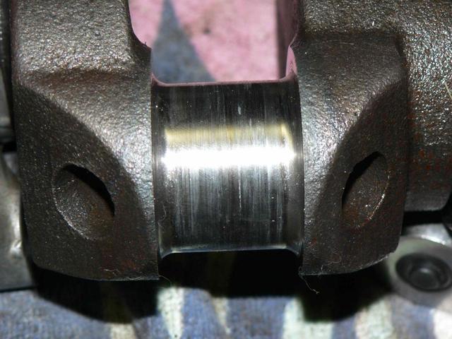

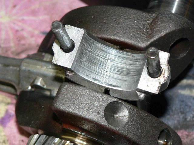

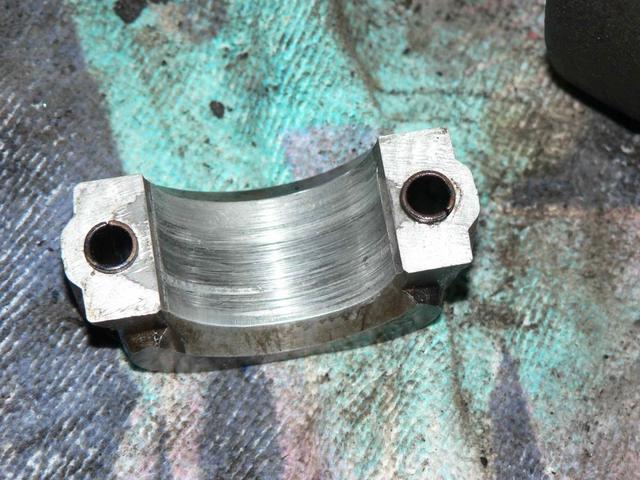

whalenkm 0 #30 Posted December 15, 2011 I've got no experience on that engine, but an engine is an engine. If the connecting rod was seized, there has to be a reason. Penetrating oil is not a fix. I would pull the cap from the bottom of the rod and see what's going on. Lack of lubrication can cause the connecting rod to fuse aluminum to the crankshaft journal. If that is the case, you've got some rebuilding to do. OK, so with some persuasion I managed to get the other set screw off, the sleeve and then used a puller to remove the drive pulley. I cracked the crankcase and removed the connecting rod. There is definitely an issue....so I suppose this means I have to get a new connecting rod (undersized) and have the crankshaft machined? Where does one get a crankshaft turned and how much would I expect to pay? Have a look at what I found.... Thanks to all for the advice getting this apart. Share this post Link to post Share on other sites
smoreau 658 #31 Posted December 15, 2011 In my area I like to use Car Quest machine shops as they have a good reputation with the car quest name. Make sure that what ever machine shop you use, make sure they have done small engines before. I have a friend that had a briggs engine bored by a friend of his that does automotive block boring and has never bored a small engine block before and it was bored at a slight angle for a .010 piston.witch caused premature rod failure. My car quest shop found and fixed the block with a .030 piston. and a .010 undersized rod. Share this post Link to post Share on other sites
Rooster 192 #32 Posted December 15, 2011 That crank is not real bad, you MIGHT get away with polishing it. Many times on theses engines the crank is not scored at all, but rather just the aluminum is galled onto the crank. Remove the aluminum and they will polish up fine. I would try that first, or have the shop try it...I have saved many engines this way. Too many guys see a galled rod and immediately grind the crank. If you do have to have the crank ground price varies by Shop. I just sent my race crank off to be offset ground, More Power Inc in Sparta Michigan is doing it for $150, other shops wanted $300... Like Smoreau mentioned, find a shop that has 2 things;Experiance with Small engines and a good reputation. I am a machinist, do almost all of my own engine work, but I send Cranks and Cams to the guys who have the equipment and knowledge to do them right! Share this post Link to post Share on other sites
whalenkm 0 #33 Posted December 15, 2011 That crank is not real bad, you MIGHT get away with polishing it. Many times on theses engines the crank is not scored at all, but rather just the aluminum is galled onto the crank. Remove the aluminum and they will polish up fine. I would try that first, or have the shop try it...I have saved many engines this way. Too many guys see a galled rod and immediately grind the crank. OK, so having no experience here, can you try and talk like you are explaining to a third grader. How/What would I polish it with? How do I remove the aluminum? Should I get a new connecting rod or can this be saved? How would I do that without damaging it? If I get a new one, should it be original size or oversized? Thanks! Share this post Link to post Share on other sites
Rooster 192 #34 Posted December 15, 2011 What ever machine shop you choose could do it for you . If you want to do it your self. To remove the aluminum there are a few options....the best of which in my opinion is acid. Every other method involves some type of scraping, scrubbing, grinding or brushing which improperly done could scratch the crank. You simply brush the acid on and it eats the aluminum off of the crank. Someone help me with the type of acid...I always forget the name. I have had the same bottle for several years, lol! To polish the crank, you need some Emery cloth, The easiest way is to use a lathe...but if your not experienced with that have someone show you how to do it. There are special procedures for polishing on a lathe that make it safer. You can do it by hand, it just takes longer, simply wwrap the emery cloth around the crank pin and polish it up. Now, the crank pin needs to be VERY round and within size tolerance, so if you do not own a set of mics, this makes it really hard to do. I have seen it done with plasti-gauge...but I am a machinist...I hate plasti-gauge, lol! If done correctly, you should be able to use a standard size rod. As for your rod, no it cannot be saved. Share this post Link to post Share on other sites
