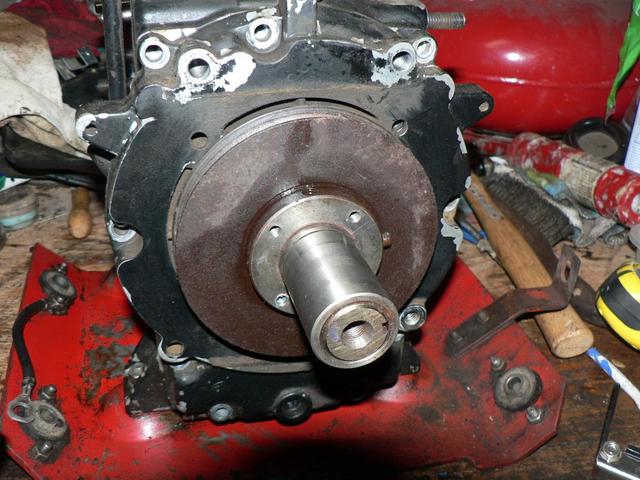

whalenkm 0 #23 Posted December 14, 2011 OK, so I have removed the flywheel but I am stuck. How do I remove the PTO drive from the other end? There are two set screws (you can see one sticking out that I unscrewed). One of them is stuck right now so I am soaking it but I am not convinced this is all that is needed to be able to get the closure plate off. This is my first time doing something like this so pretend you are describing the process to a 3rd grader! Share this post Link to post Share on other sites
tunahead72 2,662 #24 Posted December 14, 2011 This is my first time doing something like this so pretend you are describing the process to a 3rd grader! Man, do I know THAT feeling! Backing up half a step, did you notice anything unusual when you removed the flywheel (just thinking about Scott/smoreau's comments)? Share this post Link to post Share on other sites
whalenkm 0 #25 Posted December 14, 2011 Backing up half a step, did you notice anything unusual when you removed the flywheel (just thinking about Scott/smoreau's comments)? No, I had already removed the heads and it was apparent that one of the connecting rods was seized. Everything looked normal during flywheel removal. Share this post Link to post Share on other sites
