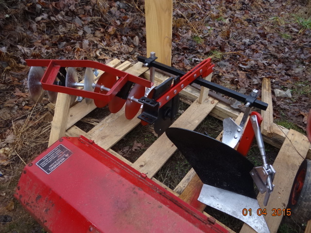

donnie crawford 1 #8 Posted January 10, 2015 (edited) I have a set of the plows there great brinly website shows how to set up. you can flip that bracket for the straight and angled side to adjust the width of the furrows you will see on brinly site in directions. I have pictures or can help you with how to hook up the rest of the plows. but brinly site shows really good. Edited January 10, 2015 by donnie crawford Share this post Link to post Share on other sites
