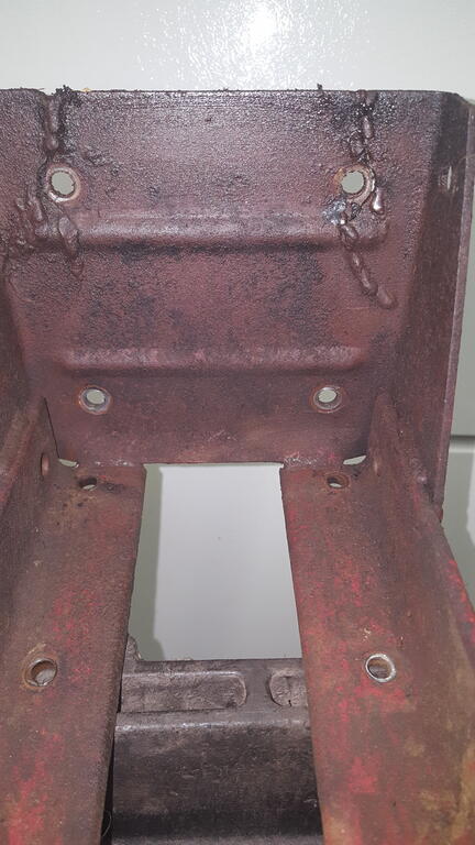

sorekiwi 761 #4 Posted December 8, 2010 Like Steve said, the rear transmission mount sometimes cracks, mainly on the older frames, the factory added some doublers here on the later models. I have seen a couple broken above the cross tube on the front. The frame is notched out here for the crosstube. They should have drilled a hole instead. 520-H: (the crack has been welded) 1 Share this post Link to post Share on other sites

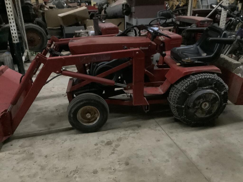

ilovemy1974b80 28 #8 Posted May 7, 2021 i need help, can a wheel horse b80's frame with stand a front end loader 1 Share this post Link to post Share on other sites
Pullstart 71,522 #9 Posted May 7, 2021 1 minute ago, ilovemy1974b80 said: i need help, can a wheel horse b80's frame with stand a front end loader I believe it can. My 1056 frame is about the same as a B80 Share this post Link to post Share on other sites
ilovemy1974b80 28 #10 Posted May 7, 2021 thank you so much 1 Share this post Link to post Share on other sites
ilovemy1974b80 28 #11 Posted May 7, 2021 I may not put one on it because of the money, but if i had the money i would Share this post Link to post Share on other sites
ilovemy1974b80 28 #12 Posted May 7, 2021 that is all most the same setup i have but i have a swisher atv bucket on it Share this post Link to post Share on other sites
ilovemy1974b80 28 #13 Posted May 7, 2021 you can see it if on youtube you look up my b80 wheel horse Share this post Link to post Share on other sites

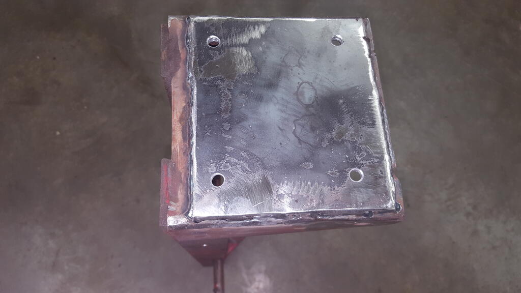

Gregor 4,848 #14 Posted May 7, 2021 On 12/7/2010 at 10:02 PM, stevebo said: I think the weak point (if you can call them weak) are the flange that bolts to the tranny has been know to crack This is where the frame bolts to the trans. Some where in it's life, someone attempted a repair. I had it fixed. 2 1 Share this post Link to post Share on other sites

kpinnc 19,063 #16 Posted May 7, 2021 I can't remember the year, but later model horses came with a reinforcement across the bottom bolts of the tranny mount. My 87 doesn't have it, but my 91 does. 2 Share this post Link to post Share on other sites
