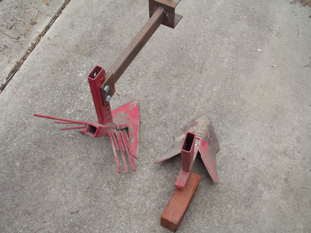

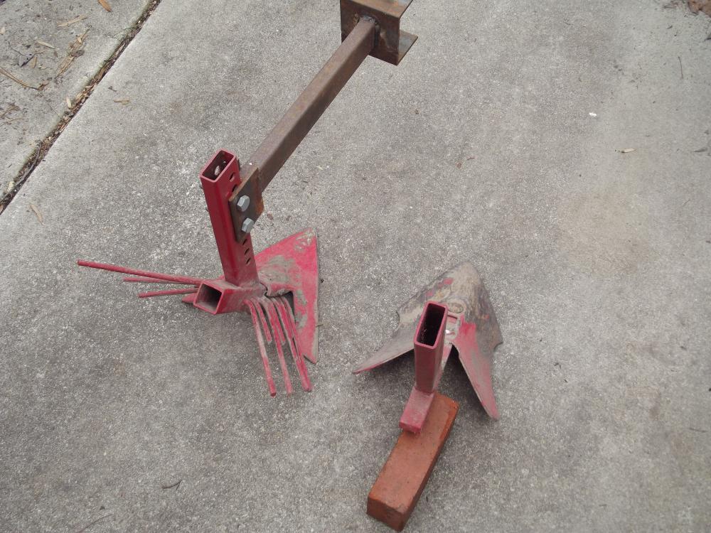

JAinVA 4,636 #10 Posted January 17, 2017 (edited) I never saw the original post but I do have some pictures of my potato implements for the WH. These tools are based on standard agricultural parts.One is a middle buster that I use to dig the furrows and the one with the tines is based on a 10" cultivator sweep.Never going back to hand digging ever again.I know these should be placed in implements and if gets moved I understand.I only posted here to at least give the posters some assistance. Edited January 17, 2017 by JAinVA 5 Share this post Link to post Share on other sites
obone 142 #11 Posted January 17, 2017 @JAinVA that is the same setup I am looking into getting. I also want to use the disk to make the hills. Anything to use the tractor more. Did you mode these yourself or buy them that way? Share this post Link to post Share on other sites
JAinVA 4,636 #12 Posted January 17, 2017 The mounts are built by me to fit my clevis hitch.Both plows can be used on the same basic holder.Thats be rusty looking part.You don't see the series of holes in the middle buster set up.The parts that actually do the digging are based on agricultural parts.The parts are available at the ASC company or from vendors on E-bay.You might get them from TSC but the store here is small and the selection of tillage parts is limited. 1 Share this post Link to post Share on other sites
