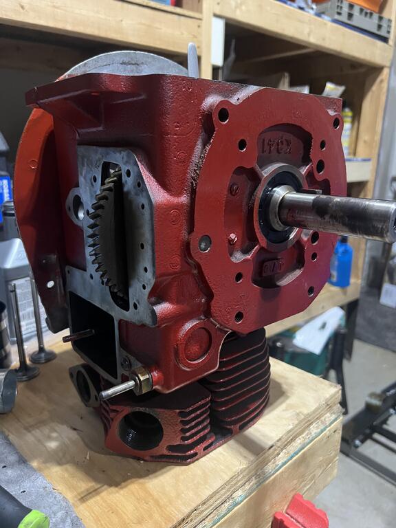

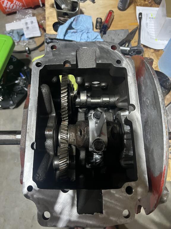

mflowers 86 #77 Posted August 8, 2024 (edited) The motor is back together! Thanks to pfrederi and his detailed instructions and for loaning me the tool, it really wasn’t that bad at all. I was a little surprised that even after correcting the end gap and installing the new bearings that there was still a small amount wobble in them. I hope to get the external parts on this weekend and get it started on the bench! Edited August 8, 2024 by mflowers 1 1 Share this post Link to post Share on other sites
oliver2-44 11,472 #78 Posted August 9, 2024 22 hours ago, mflowers said: I was a little surprised that even after correcting the end gap and installing the new bearings that there was still a small amount wobble in them. Did you check that the balance gear shafts were in spec. It’s been a while but I’m thinking they should be fairly wobble free. The shafts have a small wear allowance. Maybe @pfrederi has some more recent experience with this. Share this post Link to post Share on other sites
mflowers 86 #79 Posted August 9, 2024 7 hours ago, oliver2-44 said: Did you check that the balance gear shafts were in spec. It’s been a while but I’m thinking they should be fairly wobble free. The shafts have a small wear allowance. Maybe @pfrederi has some more recent experience with this. I did check them and they were .4998 and manual says min. is .4996. A new one is .5000. Share this post Link to post Share on other sites

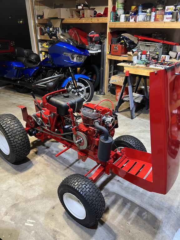

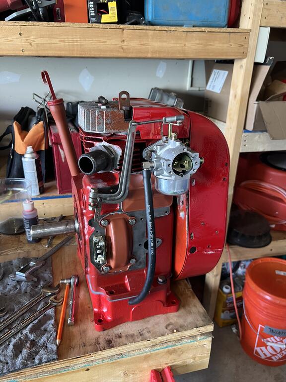

mflowers 86 #80 Posted August 15, 2024 Made a little more progress. New head bolts and fuel pump came in so hopefully over the weekend I will be be able to crank it up! 1 3 Share this post Link to post Share on other sites

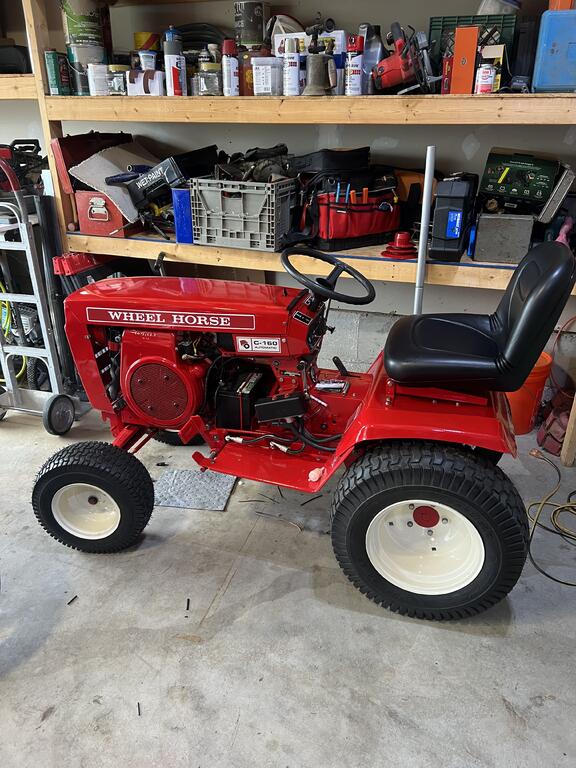

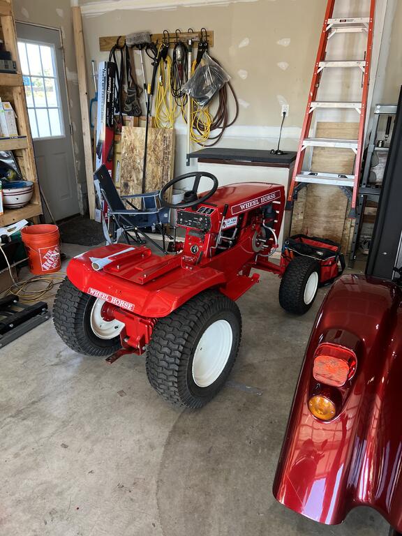

mflowers 86 #81 Posted August 22, 2024 My new gas tank bushing and shut off valve come in, so I was able to run it a little longer than the jar of gas allowed the past few nights 😂. I think I’ve got the points set right and the carb dialed in, and was able to test the hydro - so far so good! 1 6 1 Share this post Link to post Share on other sites

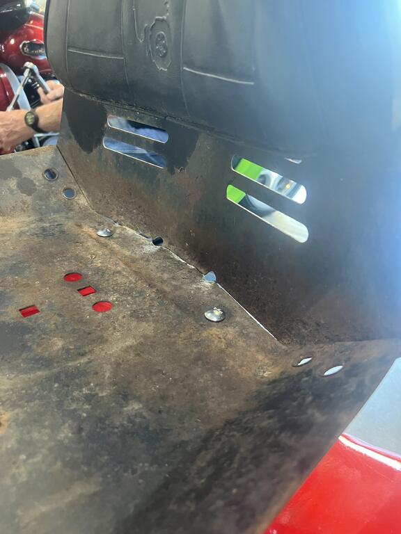

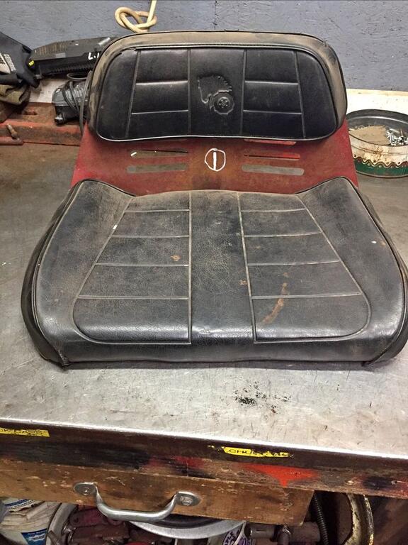

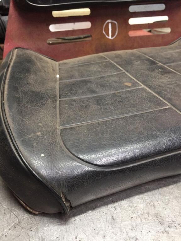

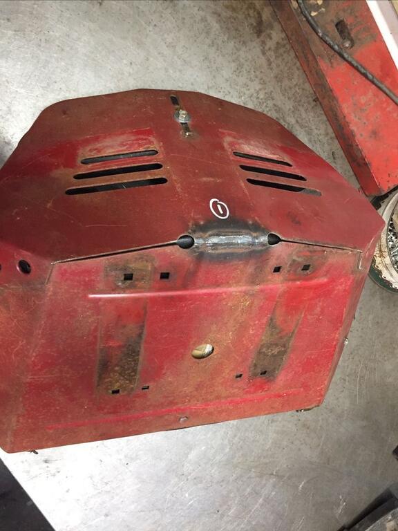

mflowers 86 #83 Posted September 11, 2024 I found a seat pan that is getting reinforced with a few welds on the corners and then off to powder coat so I can mount up the great looking setup I got from Matt! 5 Share this post Link to post Share on other sites
Bar Nuthin 2,479 #84 Posted September 30, 2024 On 9/11/2024 at 7:15 AM, mflowers said: I found a seat pan that is getting reinforced with a few welds on the corners and then off to powder coat so I can mount up the great looking setup I got from Matt! What is a reasonable price for a decent seat? I'm a newbie, so I'm trying to avoid frivolous purchases. I have a lead on this one but it's about a 4 hour drive. Share this post Link to post Share on other sites
mflowers 86 #85 Posted September 30, 2024 I have $50 in the seat pan, another $225 for the upholstery and will probably be $50 for powder coat, so not cheap compared to a replacement from Tractor Supply. I guess it depends on your goal for the tractor. Personally I plan to use the reconditioned seat for shows and parades, then put a more comfortable cheap seat for when I’m actually using it. 1 Share this post Link to post Share on other sites

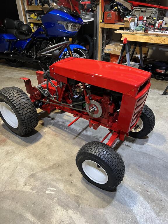

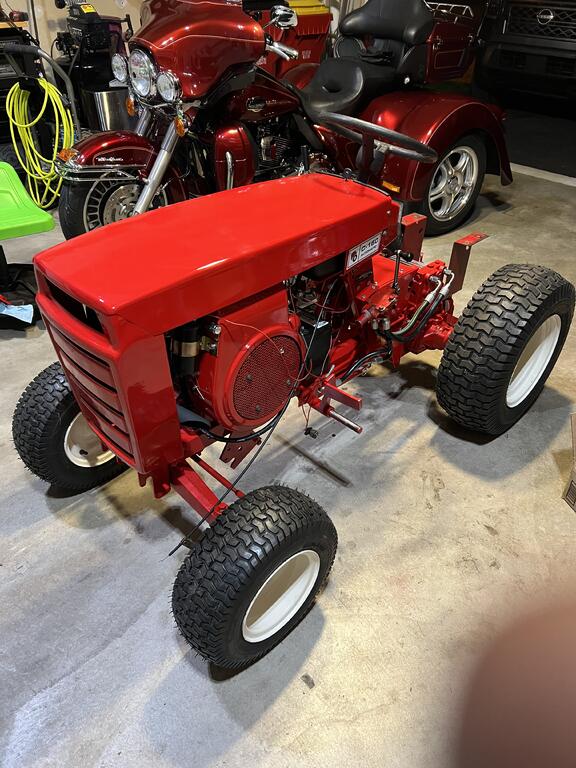

mflowers 86 #86 Posted October 1, 2024 This day has been a while coming. While there a few minor things I’ll probably update or change, it is finally finished!! 12 Share this post Link to post Share on other sites
SylvanLakeWH 31,342 #87 Posted October 1, 2024 Looks fantastic!!! 1 Share this post Link to post Share on other sites
rjg854 13,024 #88 Posted October 1, 2024 Beautiful 1 Share this post Link to post Share on other sites
Brockport Bill 2,327 #89 Posted October 1, 2024 spectacular!!!!!!!!!!! 1 Share this post Link to post Share on other sites
Brockport Bill 2,327 #90 Posted October 1, 2024 is it going in the Living Room or corner of bedroom? 4 Share this post Link to post Share on other sites
mflowers 86 #91 Posted October 2, 2024 1 hour ago, Brockport Bill said: is it going in the Living Room or corner of bedroom? 😂 don’t think didn’t occur to me, but I have a feeling the wife will recommend I put a sofa in the garage (sleeper sofa😂)! 3 Share this post Link to post Share on other sites
Bill D 2,838 #92 Posted October 2, 2024 1 hour ago, mflowers said: 😂 don’t think didn’t occur to me, but I have a feeling the wife will recommend I put a sofa in the garage (sleeper sofa😂)! Very nice. As long as it doesn't smell like gas, what's the problem 😁. 2 Share this post Link to post Share on other sites
kpinnc 18,126 #93 Posted October 2, 2024 7 hours ago, mflowers said: This day has been a while coming. While there a few minor things I’ll probably update or change, it is finally finished!! That looks beautiful! Makes me wanna go paint something! Happiness is red in your handkerchief! 2 1 1 Share this post Link to post Share on other sites
