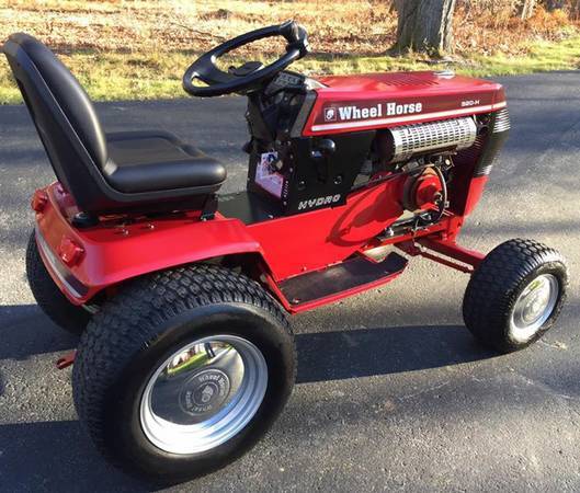

BaySide1 138 #40 Posted March 2, 2017 6 hours ago, bmsgaffer said: If you do a search on here for "powder coat", there have been several whole tractors done in powder. @Martin is the resident expert as far as I am aware. I think the consensus is that if the prep is done thorough and very well then it is very durable and will last a long time. There is not usually as much shine or gloss to it and the surface may not be as smooth, some people like it others don't. Personally, I have my wheel powder coated and then if I do any tractors ever it will probably be in epoxy with hardener, but I dont have access to cheap powder coating either... My 1991 520H has had the sheet Metal Powder Coated. Pic Below 2 Share this post Link to post Share on other sites

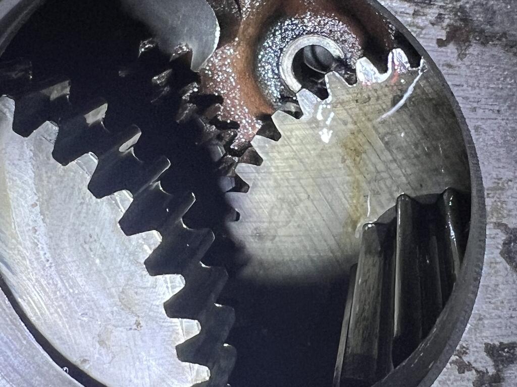

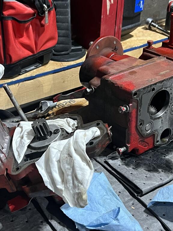

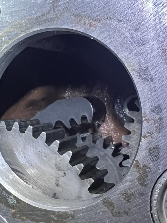

mflowers 86 #41 Posted April 23, 2024 (edited) Well, after another lengthy absence I am back at it again! I did end up sending almost all of the parts to the powder coating guy, should have them back this week. The Hydro Trans was split apart, and it looks great inside, I'll put a new gasket on and get it painted sometime this week too, so hopefully in a week or so I'll have a rolling chassis. Edited April 23, 2024 by mflowers 2 2 Share this post Link to post Share on other sites

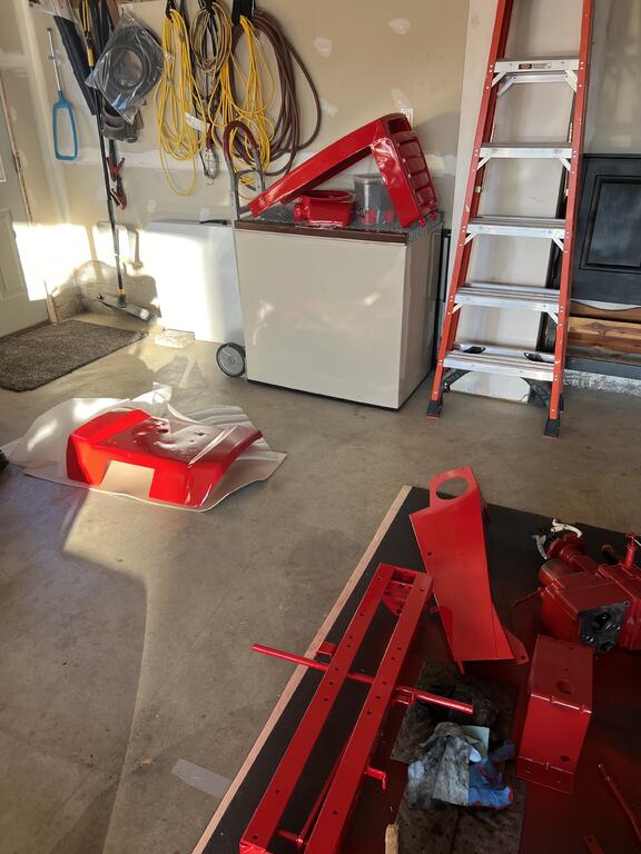

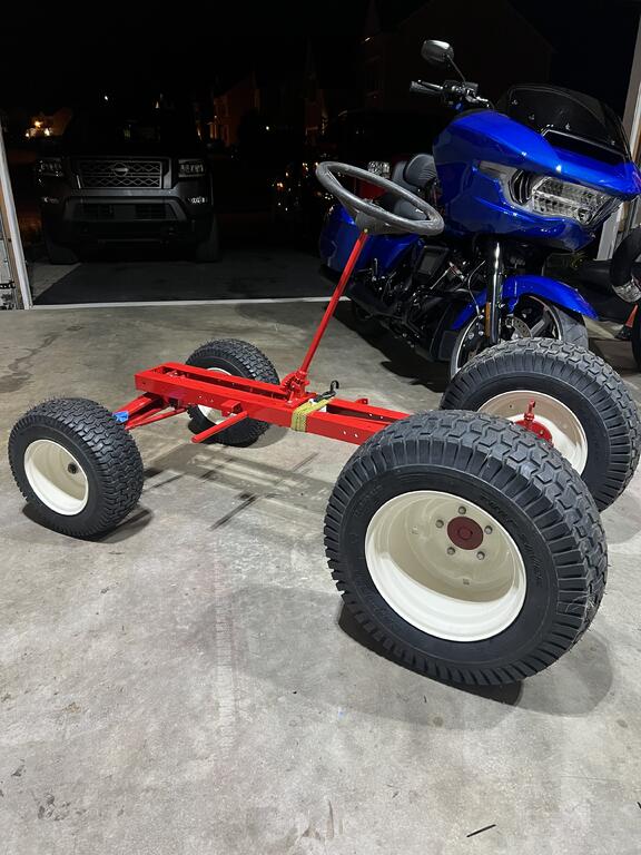

mflowers 86 #42 Posted May 2, 2024 Parts are back from powder coating! Now it’s time to get to work! 1 4 Share this post Link to post Share on other sites

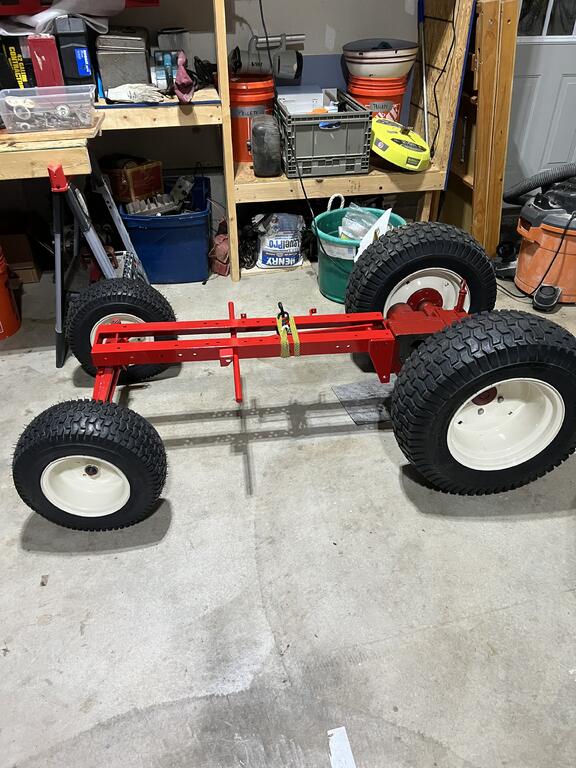

mflowers 86 #43 Posted May 12, 2024 I’ve got a rolling frame! I did run into something I wasn’t anticipating with the powder coat on the axle shafts, it had to be removed before they would go together. I hope this isn’t too big of an issue with other parts. I think I’ll be fine with bolt holes but anywhere there is a tight tolerance it could be. The color is a little brighter than the Regal Red I used in the hydro case so I’ll need to tape that off and put a coat of the new color I picked up that matches, cherry red I think. 1 2 Share this post Link to post Share on other sites

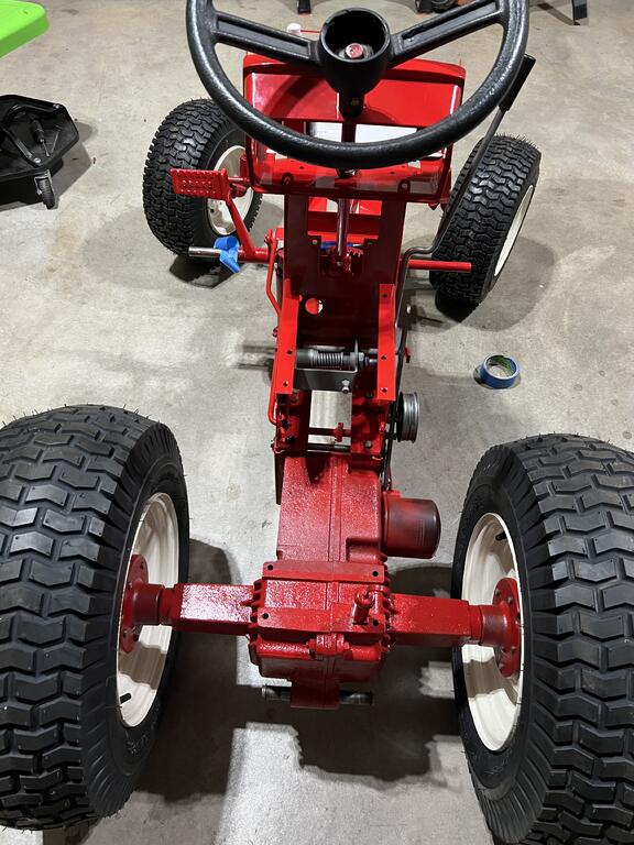

mflowers 86 #44 Posted May 23, 2024 It’s steerable now so I can easily move it around the garage. I’ll put on a few more parts to get the steering assembly rigid and then start on the motor! 4 Share this post Link to post Share on other sites

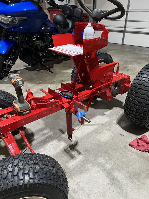

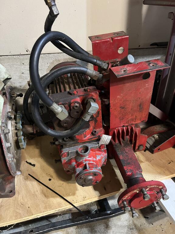

mflowers 86 #48 Posted June 17, 2024 More progress made on the chassis. One I get the hydro pump and motor bolted back on, I’ll move on to the engine. I need to get disassembled and measured before ordering my kit from iSaveTractors. 2 Share this post Link to post Share on other sites

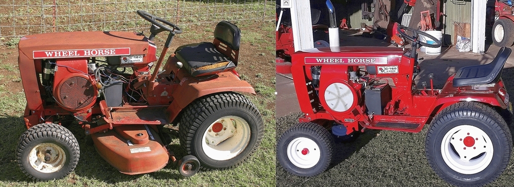

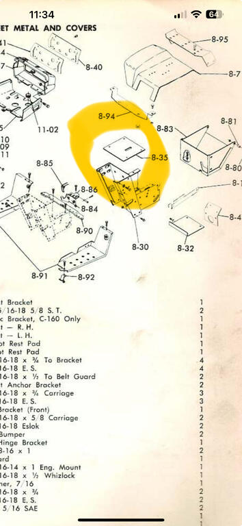

mflowers 86 #49 Posted June 19, 2024 (edited) I seem to have lost a piece along the way. Does anyone know where I can get the console cover shown here? Edited June 19, 2024 by mflowers Share this post Link to post Share on other sites
rjg854 13,360 #50 Posted June 20, 2024 A Z Tractor would be a good place to start, unless you're coming to the Big Show Share this post Link to post Share on other sites
