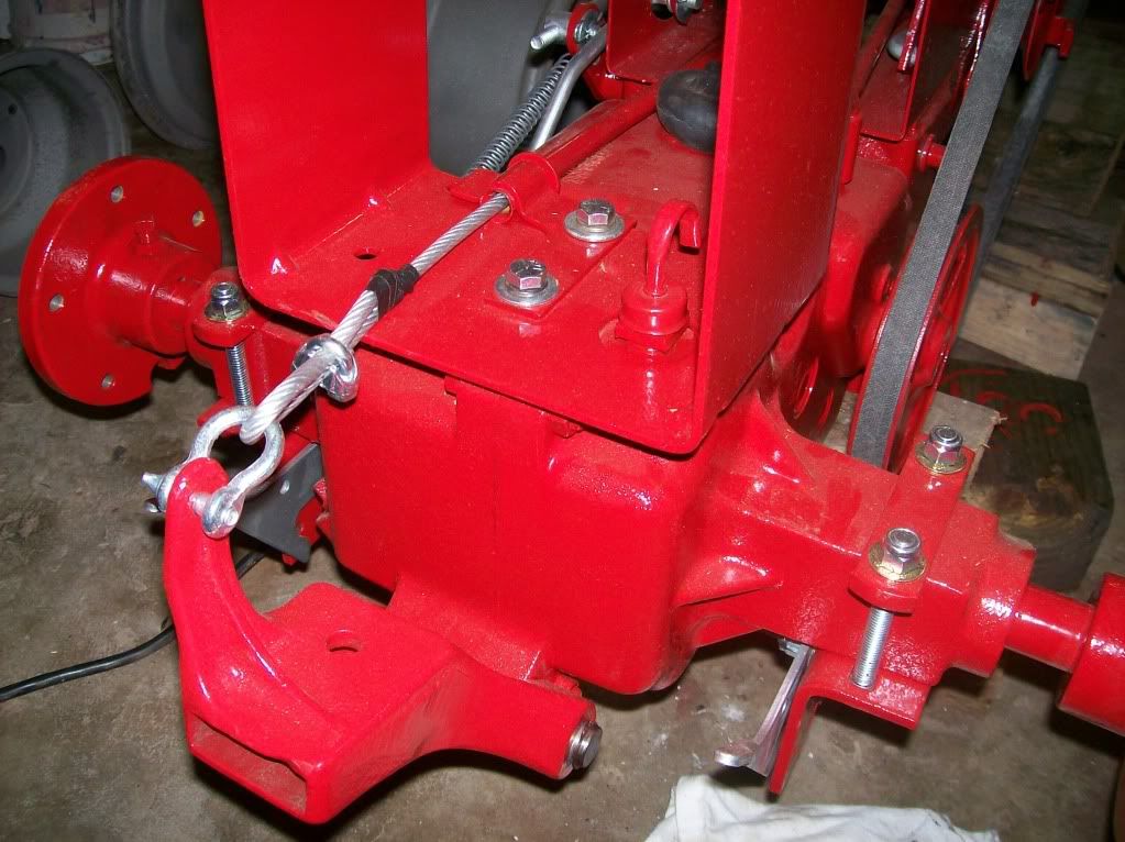

blaster 0 #12 Posted March 6, 2010 This cable construction using hardware store materials would be a good tutorial item for a lot of Red Square members with photos provided. I have not made one of these for any of my tractors but I have been thinking about doing so for a B-80 and adding a slot hitch for garden plow and disc use. If any member has some photos of making one of these and the parts that would do the job well I know I would appreciate the bump up in the learning curve. Securing the 3/16 cable on the hitch and lift and running thru the tube under the seat does take a few steps. Hi, Look at my post in work in progress. There's a pic of the cable I made. I think it was about 6 bucks worth at TS.....Glenn Share this post Link to post Share on other sites

Lane Ranger 12,094 #14 Posted March 6, 2010 Thanks Glenn! Real good posting of this information! Do you have a photo you can post of the way you hooked up the B-80 lift cable on the front of the tractor? B) Share this post Link to post Share on other sites
gwgdog66 23 #15 Posted March 6, 2010 This cable construction using hardware store materials would be a good tutorial item for a lot of Red Square members with photos provided. I have not made one of these for any of my tractors but I have been thinking about doing so for a B-80 and adding a slot hitch for garden plow and disc use. If any member has some photos of making one of these and the parts that would do the job well I know I would appreciate the bump up in the learning curve. Securing the 3/16 cable on the hitch and lift and running thru the tube under the seat does take a few steps. Hi, Look at my post in work in progress. There's a pic of the cable I made. I think it was about 6 bucks worth at TS.....Glenn Glenn has the newer style tube. It looks like he was able to use a thicker cable then I did. It shows a good pic of the clevis also. http://i895.photobucket.com/albums/ac158/g...49/101_1065.jpg Share this post Link to post Share on other sites
blaster 0 #16 Posted March 7, 2010 Thanks Glenn! Real good posting of this information! Do you have a photo you can post of the way you hooked up the B-80 lift cable on the front of the tractor? Hi, the front is just threaded through the tab on the lift arm and held with a cable clamp...Glenn Share this post Link to post Share on other sites
