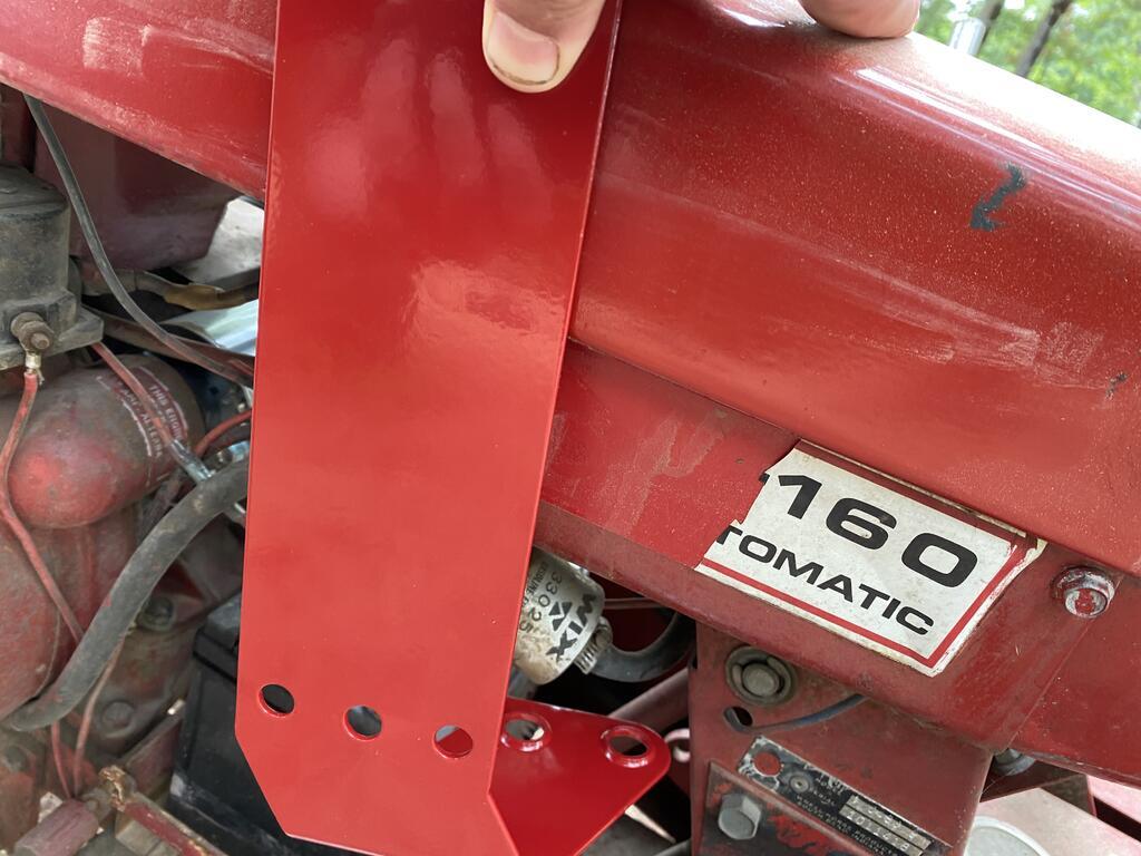

55reasons 171 #188 Posted June 21, 2020 (edited) Check RAL 3003. I just powder coated a bunch of parts and it appears to match almost perfect with my 74 C160 Automatic. Edited June 21, 2020 by 55reasons 1 1 Share this post Link to post Share on other sites

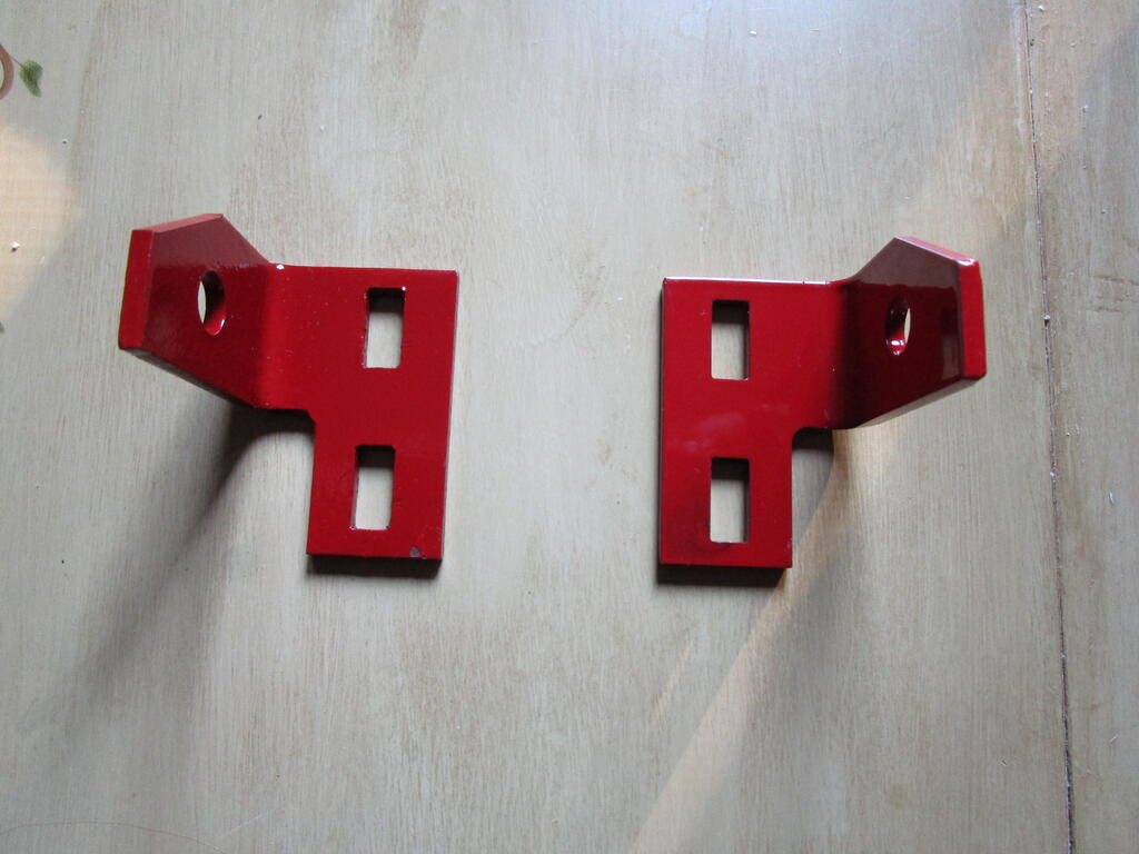

JCM 11,419 #189 Posted July 5, 2020 Ordered a Grill Pivot Bracket Toro # 109145-01 and picked it up yesterday. I was interested to see how close of a match today's Toro red was in comparison to Rust-oleum Regal Red. I know it may be difficult to see any difference but I think they are very close but the Regal Red appears just a shade darker.The one on the left is the Regal Red and the one on the right is Toro Red, should anyone be that fussy. FYI Share this post Link to post Share on other sites

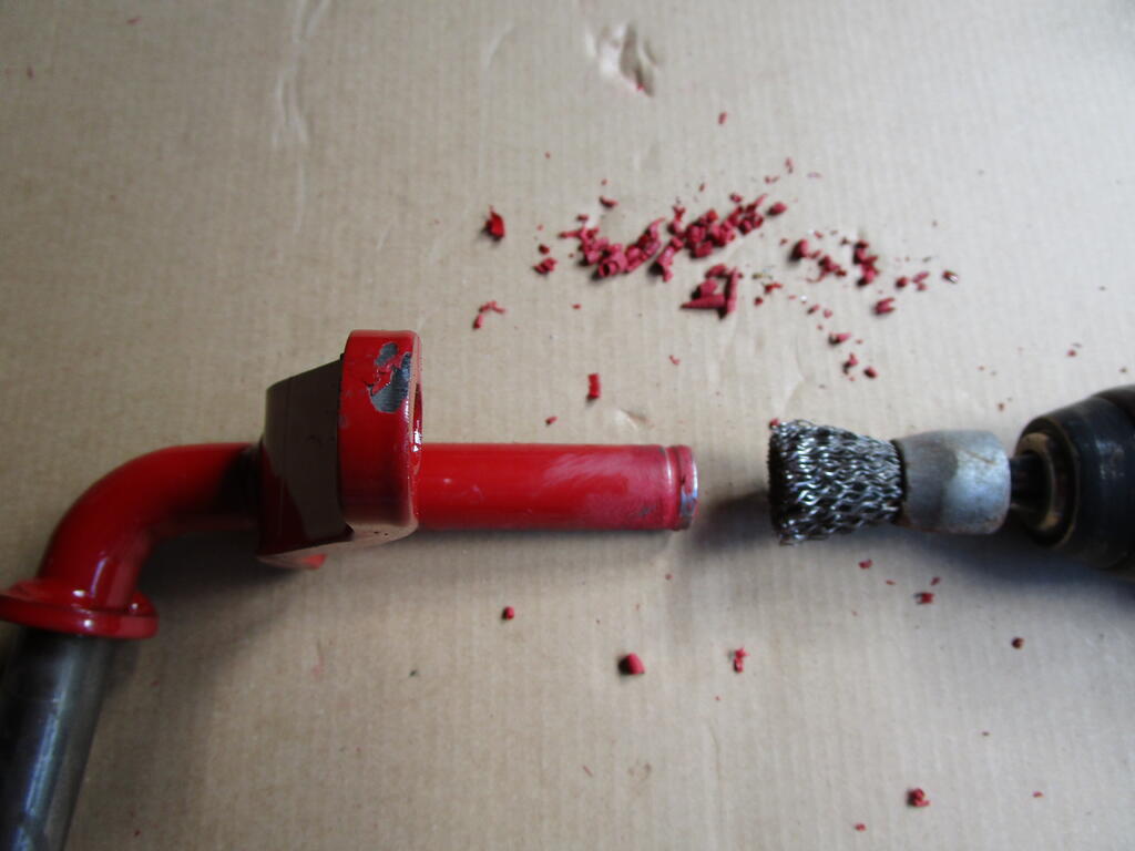

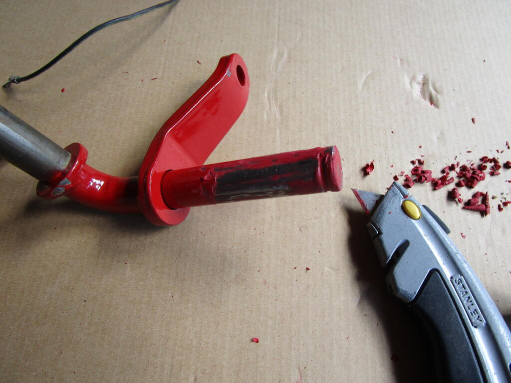

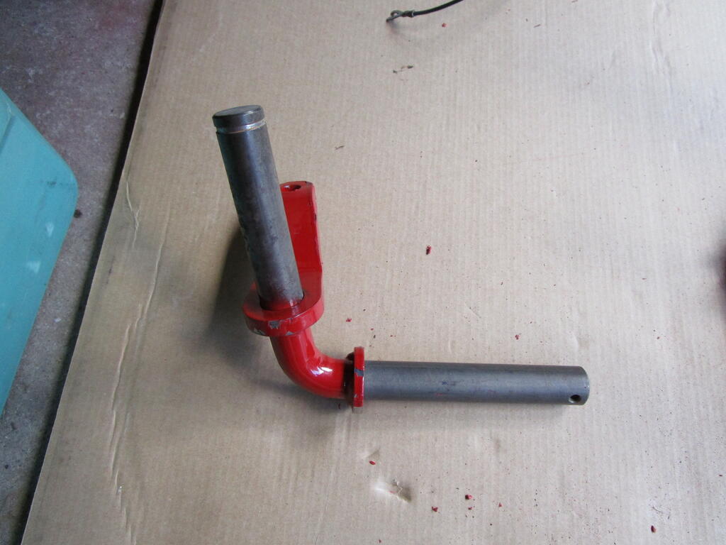

JCM 11,419 #191 Posted August 3, 2020 Purchased 2 OEM front spindles for the 420 from Toro last week and noticed one of them was painted on the upper part that goes up into the axle. Upon further examination the spindle would not go into the axle with out removing what I thought was paint but when I tried to remove it I had to use both a utility knife and a wire wheel and some elbow grease to strip it off, looked like it was dipped almost like the coating years back when you could dip your adjustable wrench handles etc. One question for the paint experts. What would be the close match to use on the front of the hood , hoodstand and rear seat pans to match the original look. I have been using Rust o leum semi- gloss black or would a satin black be more correct . Thanks Share this post Link to post Share on other sites
WVHillbilly520H 10,379 #192 Posted August 4, 2020 6 hours ago, JCM said: Purchased 2 OEM front spindles for the 420 from Toro last week and noticed one of them was painted on the upper part that goes up into the axle. Upon further examination the spindle would not go into the axle with out removing what I thought was paint but when I tried to remove it I had to use both a utility knife and a wire wheel and some elbow grease to strip it off, looked like it was dipped almost like the coating years back when you could dip your adjustable wrench handles etc. One question for the paint experts. What would be the close match to use on the front of the hood , hoodstand and rear seat pans to match the original look. I have been using Rust o leum semi- gloss black or would a satin black be more correct . Thanks I have heard satin is the better choice but I don't know definitely. 1 Share this post Link to post Share on other sites
oliver2-44 11,786 #193 Posted August 4, 2020 7 hours ago, JCM said: looked like it was dipped almost like the coating years back when you could dip your adjustable wrench handles etc. @JCM In recent years, I've been in at least two manufacturing shops where they dipped odd shaped parts in paint. They were very low tech setups, i.e parts suspended on a chain conveyor that dipped them down into a heated 55 gal drum of paint. As the part exited the barrel it ran over a trough for a distance that let the dripping paint run back into the barrel. Its kind of an old school way to minimize VOC's 1 Share this post Link to post Share on other sites
