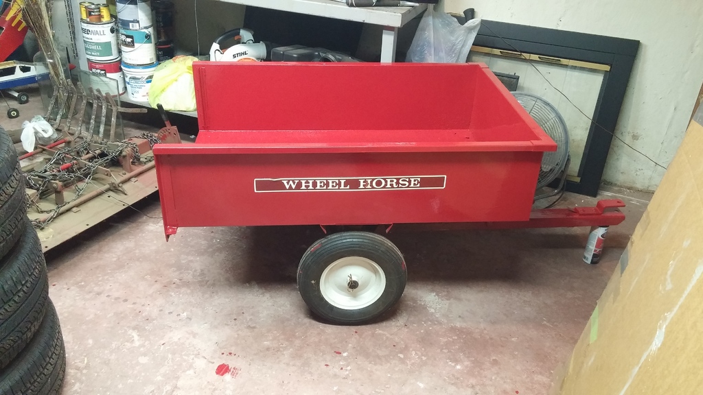

BigRed84 65 #152 Posted June 1, 2017 Just put a coat on my dad's old cart from either the late 70's or early 80's. IH red from TSC....brand was "Majic". Has anyone used this brand yet? 2 Share this post Link to post Share on other sites
rmaynard 17,614 #153 Posted June 1, 2017 Yes. And it all came back off. Never hardened. Search "Majic" in this forum and see what others have said about it. Hope you have better luck. 1 Share this post Link to post Share on other sites

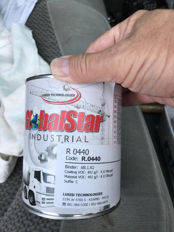

mc1960 43 #168 Posted June 28, 2018 This is the paint that I used, they could not cross match PPG numbers but used a color chart to match a part I brought in. This is a single stage paint, is suppose to be direct over metal, even though I shot it over high solids primer. 1 Share this post Link to post Share on other sites
