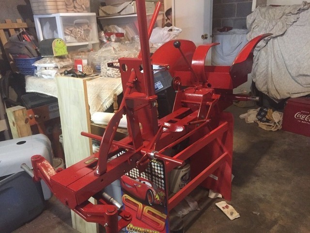

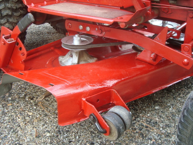

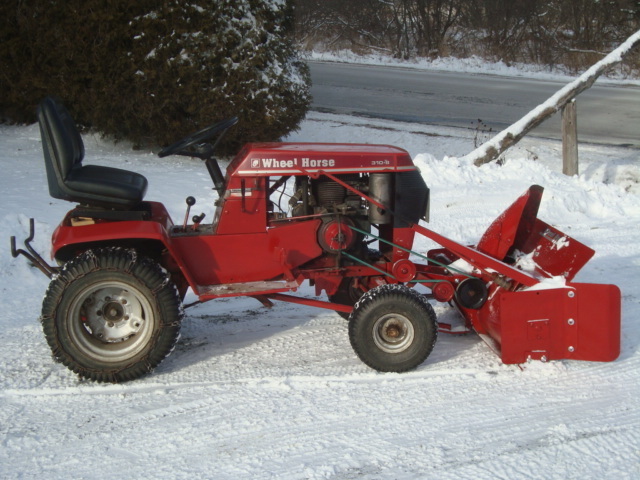

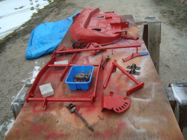

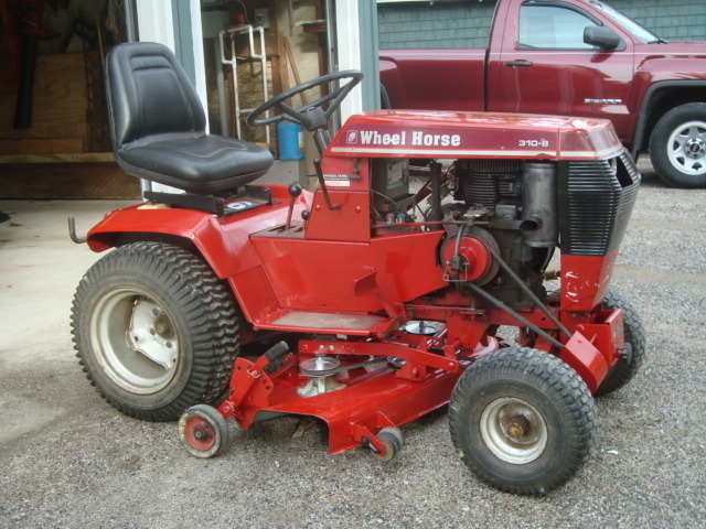

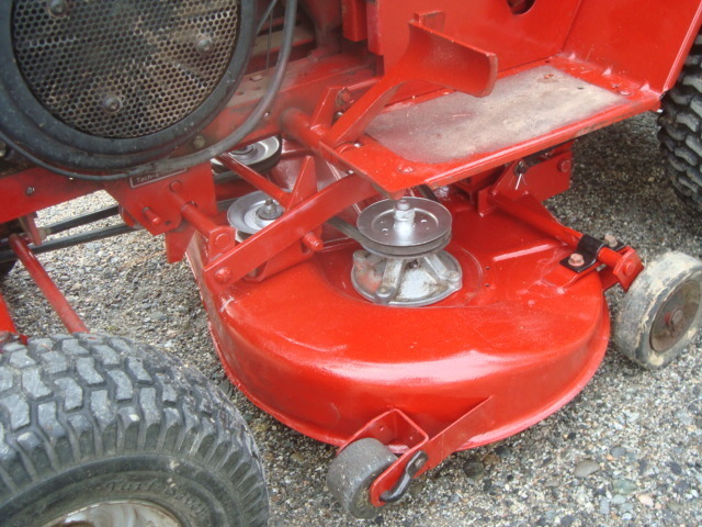

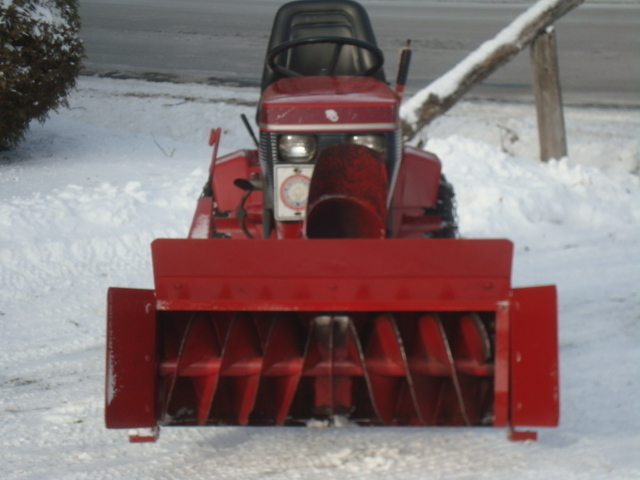

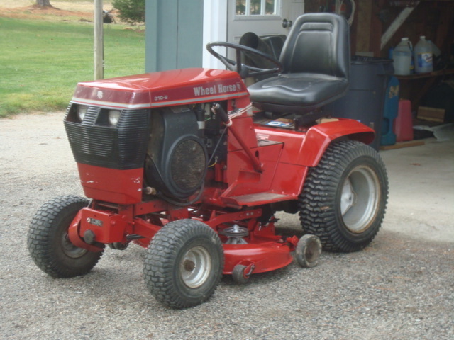

Retired Sparky 526 #128 Posted February 1, 2016 I used the Regal Red in my restoration too. I started with the mowing deck last fall before it got cold out doors. The tractor came next. The hood, seat pan and other removable panels got sanded and repainted in the shop that was heated. By the time I got to the snow blower, it was already freezing outside. What I couldn't unbolt, I had to paint in an unheated garage. I know you're supposed to paint below 50 deg. I painted it anyway. I can sympathize with those that paint and can't wait to reassemble. I was surprised, the next morning the paint was dry and I could start putting thing back together. Go figure. I'm not like some others. I only own one Wheel Horse. I didn't buy it to restore it. And that's not a slam, guys. I fell in love with '86 310 in the show room. It's been well cared for from day one. Pete 3 1 Share this post Link to post Share on other sites
jackhammer 553 #129 Posted February 3, 2016 What a great job it turned out to be on your 310 ,,, Very good , Retired laborer LIUNA Rick Share this post Link to post Share on other sites

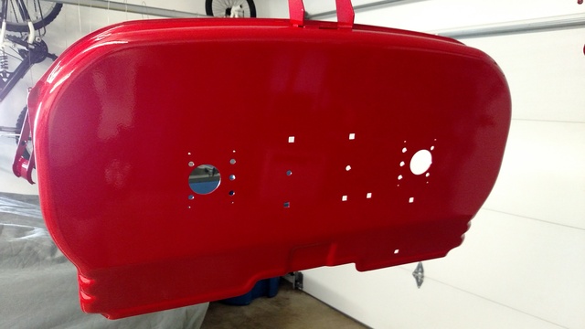

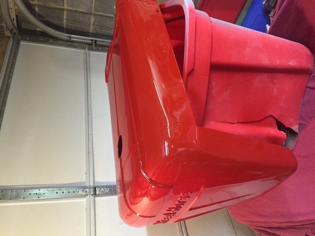

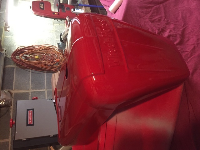

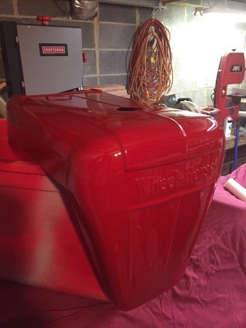

dells68 7,499 #130 Posted February 13, 2016 Been working on painting my son's 61 suburban. Used regal red and am very pleased with how it is turning out! Sorry for the rotation, not sure how to change it Share this post Link to post Share on other sites

dells68 7,499 #134 Posted February 13, 2016 Yup, you're right! I became a supporter and fixed my pic problem. Here are the pics again. Any idea how to rotate them? 1 Share this post Link to post Share on other sites

dells68 7,499 #140 Posted February 13, 2016 Thanks!! My son is not the most patient kid around. I promised I'd have it finished in time for his birthday in March - he'll be 8. 2 Share this post Link to post Share on other sites

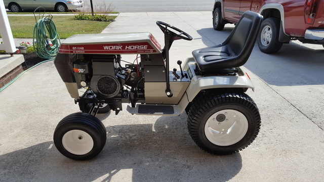

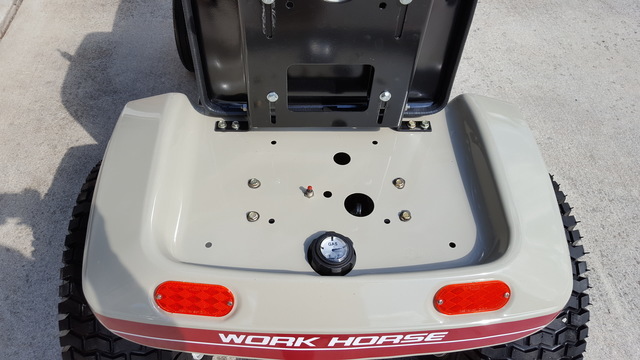

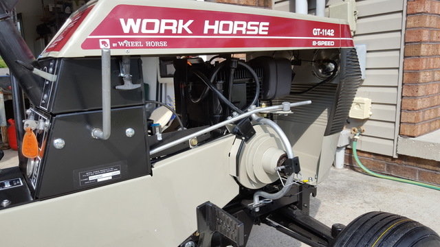

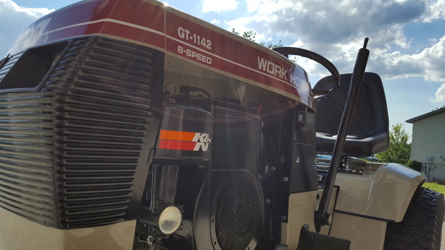

kdeatrick 170 #141 Posted July 13, 2016 I wanted to share what the body shop used on my Dad's 1983 GT-1142 Workhorse. He paint matched the color to a Subaru Color "Warm Gray" 88N. He painted it in Base Coat, Clear Coat. It looks dead on and better that the day it came off the show room floor back in May 1983. 9 1 Share this post Link to post Share on other sites

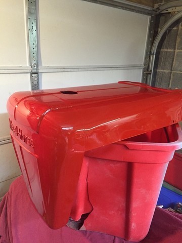

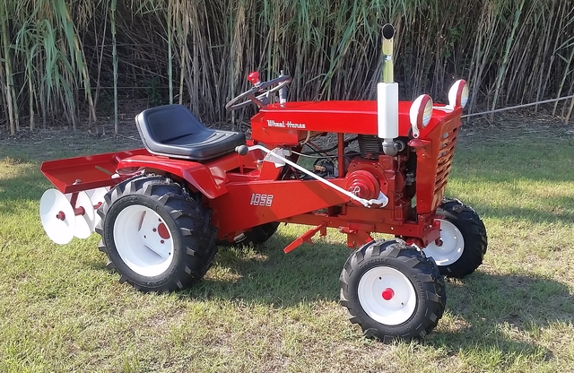

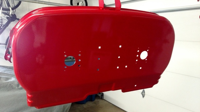

Texas Todd 1,026 #145 Posted September 4, 2016 I used Rustoleum Regal Red shot from a Harbor Freight HVLP gun with a 1.4 tip. This gun was not the bottom of the line gun, but the next one up, purple handle with pressure regulator attached. I liked the idea of being able to do some touch ups with the readily available bombs. Used the valspar hardener and reduced with acetone. Sprayed easily and dried nicely (tends to do that in the Texas sun in August). Primed with Rusto self etching primer bombs as well. Used the technique many describe here. Spray a light coat and let it flash for about 10-15 minutes and then applied another coat and sometimes two. Took 3 times to get the hood where I wanted it. Couldn't seem to get the top and sides uniform the first two tries. 2 1 1 Share this post Link to post Share on other sites
