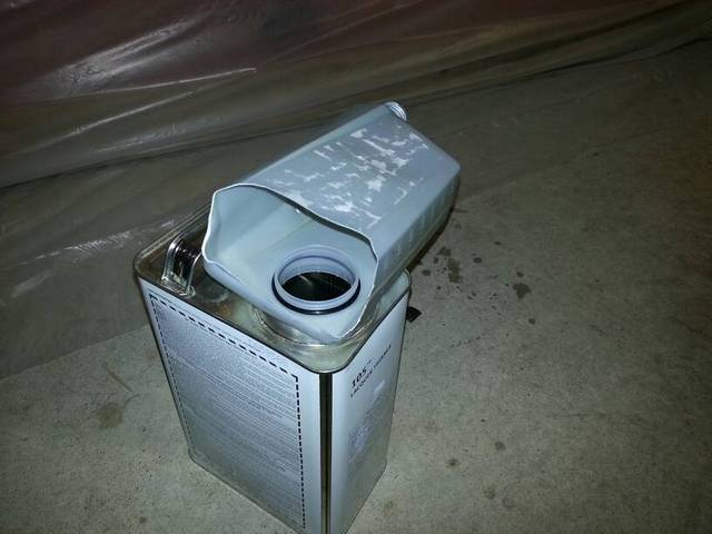

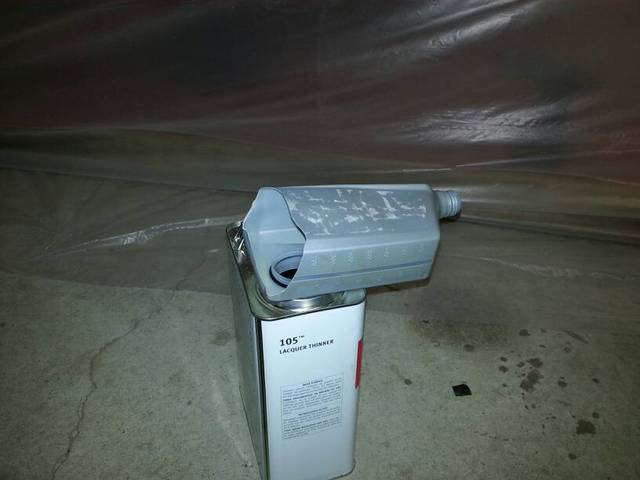

redrooster 83 #86 Posted February 26, 2014 If you are mixing paint and dont like to spill thinner from those hard to pour from metal cans I have a solution. I took a plastic quart oil container and cut a 2" hole in the side, cut out the bottom and sliped an o ring over the spout. Presto, hands free operation of funnel and no mess!! 10 1 1 Share this post Link to post Share on other sites
rmaynard 16,699 #87 Posted February 26, 2014 That is a great idea. Why don't you re-post this info in the thread ""? 1 Share this post Link to post Share on other sites

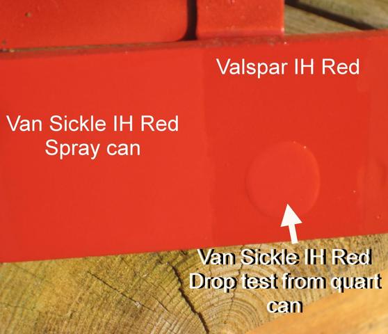

rmaynard 16,699 #93 Posted April 12, 2014 Just a follow-up to an earlier conversation concerning Van Sickle IH Red paint. Being that I am doing a refresh on my 857 and not a total "show queen" restoration, I decided to give Van Sickle paint a try to hopefully save some money. Although I thought that what I was getting was acrylic enamel, I ended up with alkyd enamel, which is what the old Valspar Restoration Series paint was. When the paint arrived, I did a spot test on a panel that I had previously painted with Valspar Restoration Series IH red. Results? No comparison. The Van Sickle is a much brighter (lighter) red with an orange tint. I'm not saying there is anything wrong with the color, it's just not the look I'm going for. I now have two quarts of paint, one pint of hardener, and a 12oz spray can of Van Sickle IH red for sale. 1 Share this post Link to post Share on other sites
