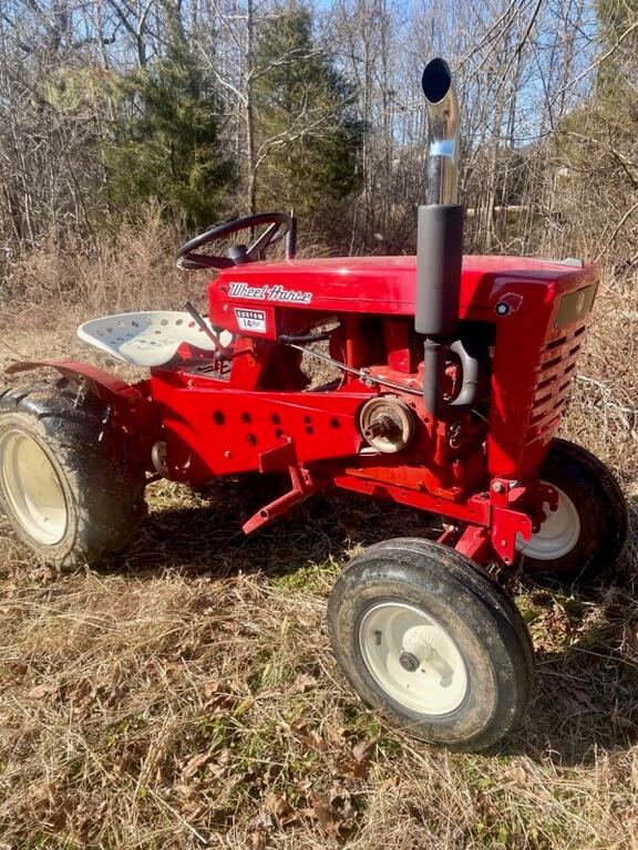

Greentored 3,220 #227 Posted July 19, 2021 day late and a dollar short, but this is Wimbledon white on wheels: 3 Share this post Link to post Share on other sites

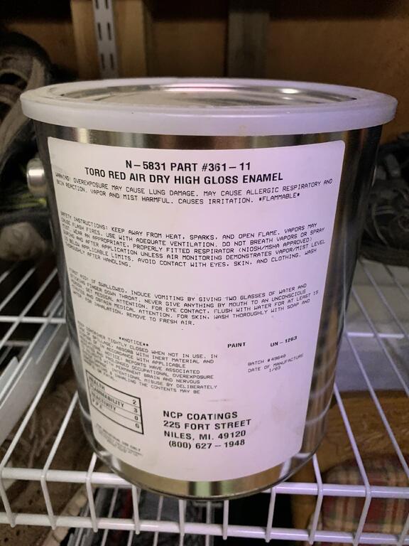

WH1618speed 543 #228 Posted July 21, 2021 Does anyone know the ratios of hardener and reducer to put in the Toro Red Enamel paint? We have 2 gallons of it but it doesn't say anywhere on the cans what the ratios are? 2 Share this post Link to post Share on other sites
PetesPonies1 119 #229 Posted July 21, 2021 You would be good at 8:1. 1 Share this post Link to post Share on other sites
WH1618speed 543 #230 Posted July 21, 2021 (edited) @PetesPonies1 Is that for the hardener, reducer, or for both? Edited July 21, 2021 by WH1618speed 1 Share this post Link to post Share on other sites
PetesPonies1 119 #231 Posted July 21, 2021 Hardener. Then reduce until it has the consistency to milk. Enamel and AE have changed over the years. The reducing has changed as well. But the consistency hasn't Think milk. 2 Share this post Link to post Share on other sites
WH1618speed 543 #232 Posted July 22, 2021 Ok, thank you I will have to try that! 1 Share this post Link to post Share on other sites

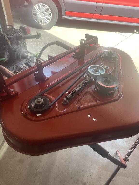

Heatingman 977 #248 Posted September 4, 2022 On 7/23/2021 at 1:06 PM, Crazyredhorse said: How you guys paint the little stuff like brackets and linkages.im thinking just getting a paint I can brush on.i have a gun but its overkill for painting a tractor and dont want to mess with reducers and hardners etc. keep cost down too.so I'm thinking rattlecan it and get matching paint to brush for the little stuff any paint you guys recommend. I use the spray gun mixed with a couple cap fulls of Penetrol and some acetone to thin, a little majic paints hardener to speed dry time. If your painting a bunch of brackets at once, its worth the effort. or if you just want to brush, add 10 to 15 percent Penetrol, and you wont see the brush marks. thin a bit less for vertical parts. I just sprayed this a couple weeks ago with Rustoleum - IH red implement with acetone and Penetrol, with a little majic paints hardener. I even brushed on a coat of strait Penetrol as a clear coat - with a chipping brush, and it still came out 3 Share this post Link to post Share on other sites
PetesPonies1 119 #249 Posted September 4, 2022 The hardeners don't speed dry time. If anything, they increase the time to flash over. What they do is chemically cure the paint, so the end result is much different than if you use uncatalyzed enamel. 3 Share this post Link to post Share on other sites
