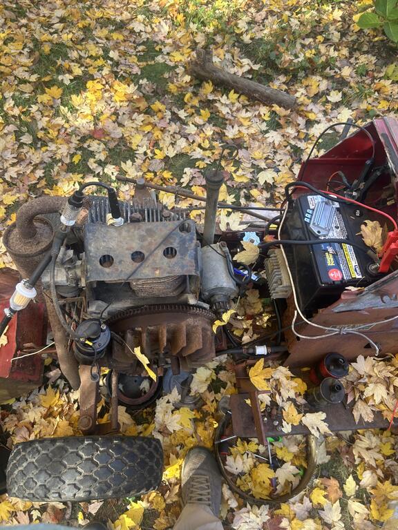

Hi all I have recently acquired a C-145 automatic and it is in good mechanical shape but it does not have spark I have replaced the starter coil and magneto coil as well as the key switch and the solenoid and eveything is up to spec what should I do

When replacing the key switch, did you replace it with the correct one. There is a difference between a switch for a magneto ignition, and a battery ignition. However, you said you replace the ignition coil and the magneto coil. There can only be one or the other. A magneto system has no ignition coil and vice-versa. So lets try to figure out what you have. Do you have the ID number for the C-145? What is the year? Which engine does it have? Do you have the spec number from the engine? I'm sure we can get you going if we have the right info.

That spec is a battery points ignition with a 15 amp Stator for charging.  The regulator you have sitting loose is not the correct one.. The finned one mounted on the hoodstand is.  Run a jumper from Battery+ to the + terminal on the coil crank it and see if you get spark,

First things first., the ignition coil needs to be bolted to the block to make a good ground.
Send back the voltage regulator that is sitting on the battery, it is not for correct for your :wh: and has nothing to do with your lack of spark situation.

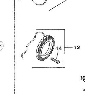

I am not sure I know what you mean by rectifier coil.  Is it the stator that is under the flywheel it has nothing to do with spark.(see pic)

Recitifer coil has nothing to do with spark and it  is called a stator
