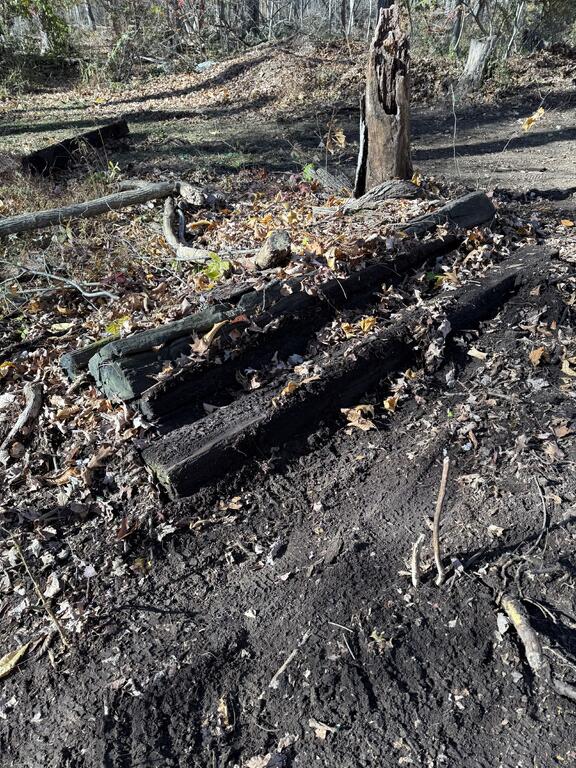

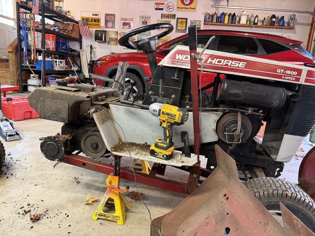

Sparky-(Admin) 26,502 #1 Posted 6 hours ago I know the WH isn’t a bulldozer (no I don’t) Just driving around looking at flowers (no I wasn’t) So there I was pushing railroad ties with my GT-1600 when it made a weird noise, moved forward another foot and then she went into “infinite neutral mode” . Towed her into the ER and the hubs are good, the trans drive pulley and keyway are good and of course the fluid is clean/full. Jack up and it makes some weird and horrible noises when it’s spun. And one time it actually locked up. Have a few (4 spares) transmissions here so it’ll get a new trans. Busted one is the original 1” axle unit with 4 pinions. I’ll install a trans with a 1-1/8” axles and 8 pinions. 2 Share this post Link to post Share on other sites

wallfish 20,665 #6 Posted 1 hour ago 4 hours ago, Sparky said: And one time it actually locked up. Something got caught in the gear teeth. Open it up because you can't break it any more than all ready broke. Interested to know what let go. Share this post Link to post Share on other sites
