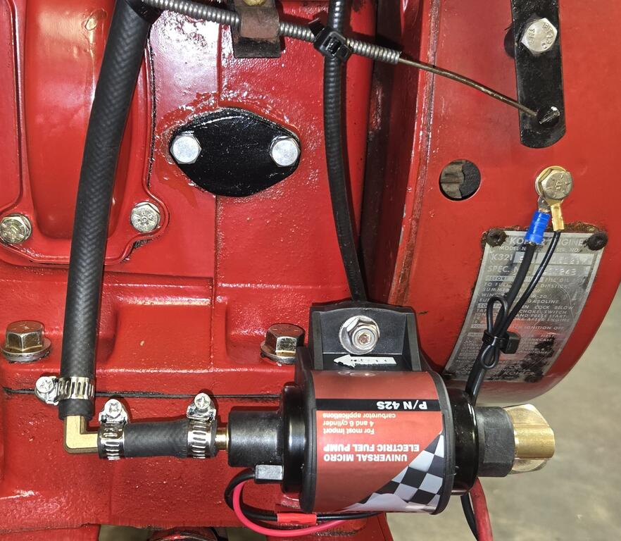

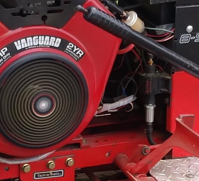

I personally use and recommend Facet brand pumps. There are less expensive models of other brands.
  • Like 1
pfrederi
15 minutes ago, ebinmaine said:
Go electric.
 Me Too  I have a Facet oin my 418A  turn switch on you can hear the pump clicking after a few seconds it gets quieter then yoo will have instant start up.
