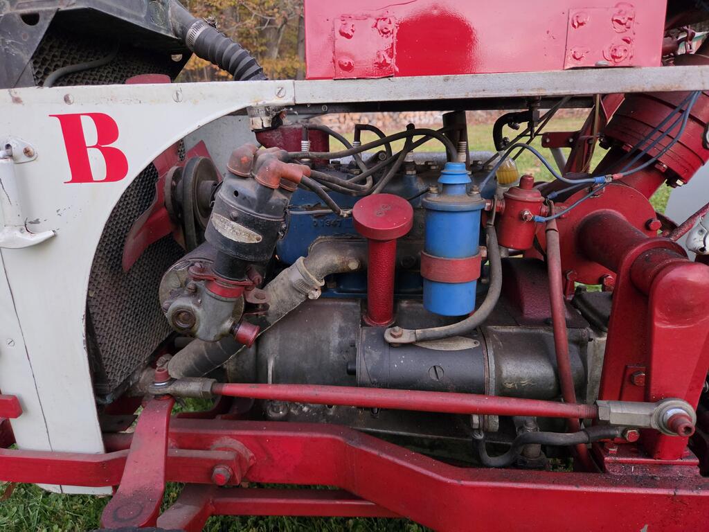

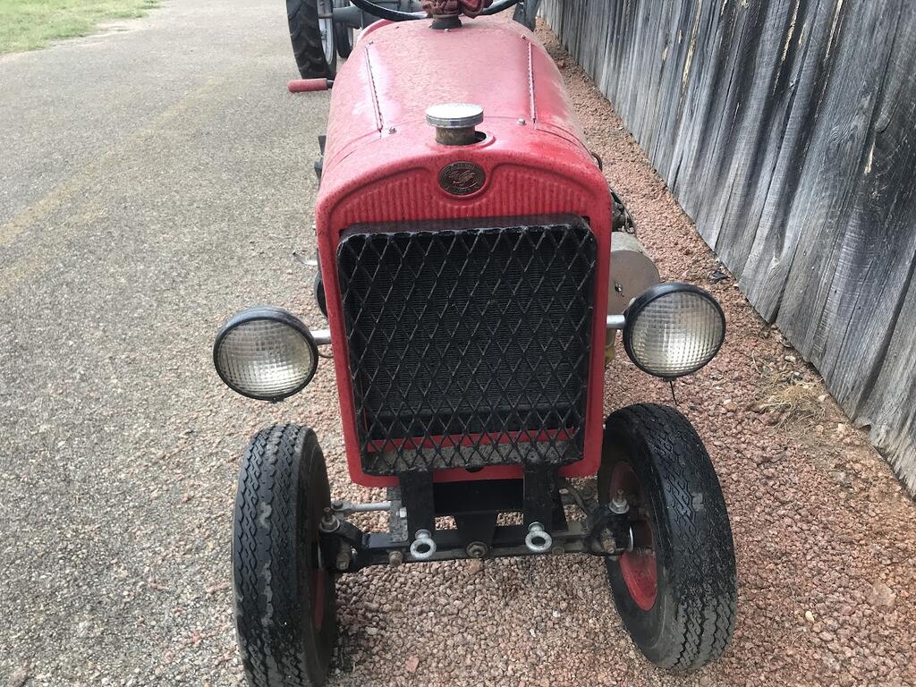

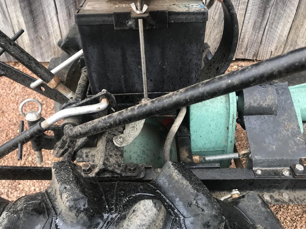

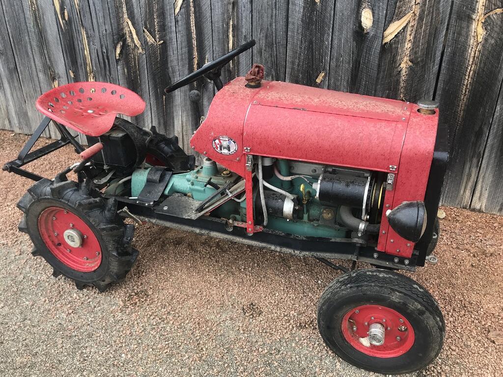

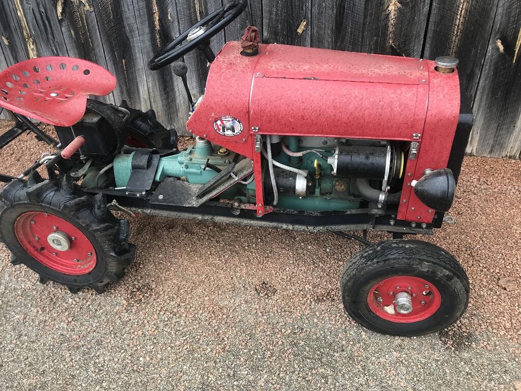

An interresting build. I must say that I have never seen a double lever steering setup where each wheel is steered by a common shaft and no tierod between them. Nice touch with the Heim joints - Pete would approve.... @peter lena ??

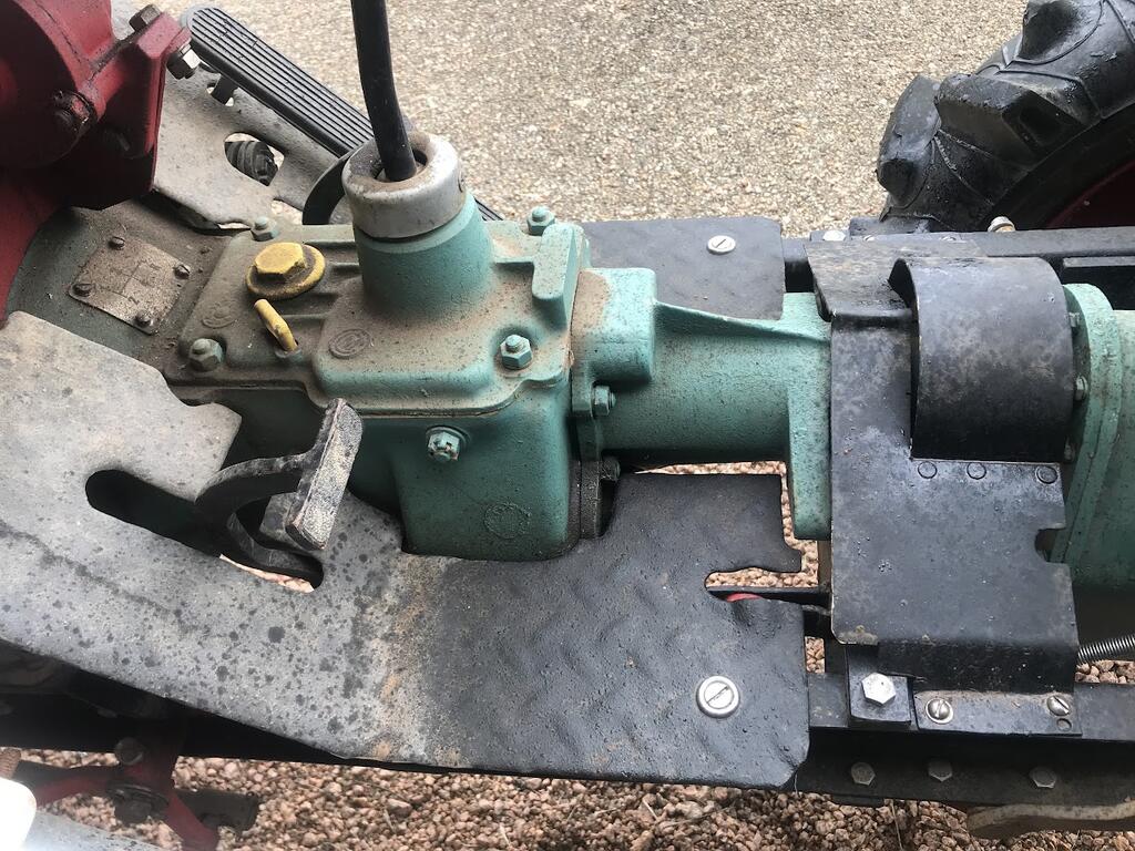

953 nut
10 hours ago, Mike'sHorseBarn said:
He made a gear reduction for it to keep the speed down.

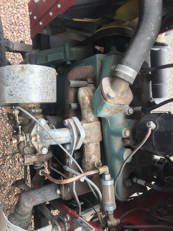

Is the speed reduction chain drive?

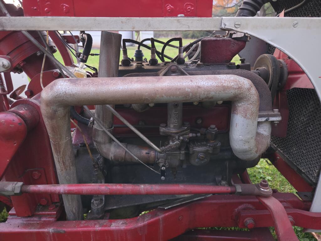

The Gear drive to the generator and gear drive to the distributer is a bit unusual,  I like it.
Ford used the double pitman arm steering for years, some others may have too.

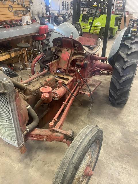

Something little different in shop. 8n ford in for steering box rebuildRebuilt Steering Box

Mike'sHorseBarn
3 hours ago, Ed Kennell said:
Made right here in Butler< Pa. from 1929 - 1941.      My neighbor has one that looks like a 3/4 size model A Ford.   If you have a specific question, I can ask him.
Does he know where parts can be had?

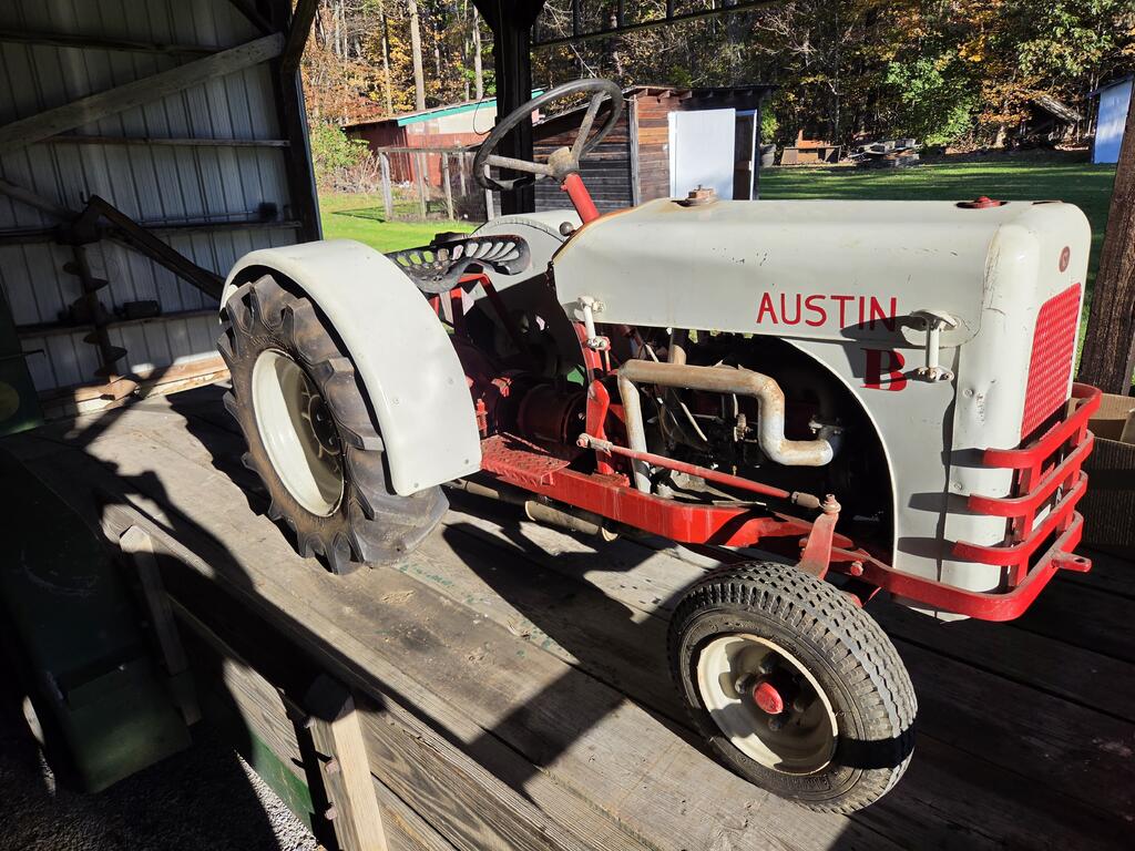

Side note for everyone. It was never wired up to charge, so I'm thinking of adding a mini 6v alternator, rather than try to rebuild the weird generator and add in some kind of voltage regulator. Then once I have that, I can add some lights.

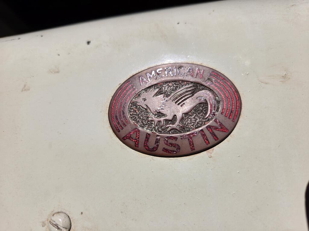

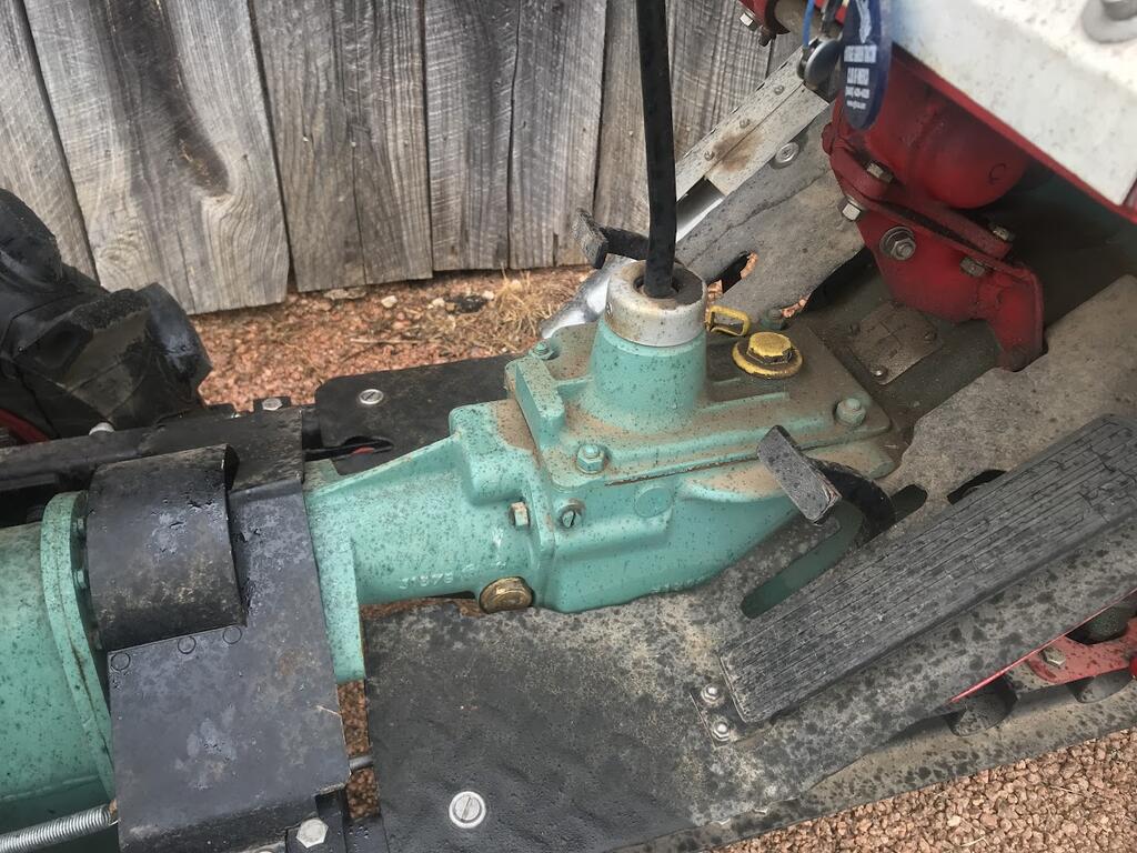

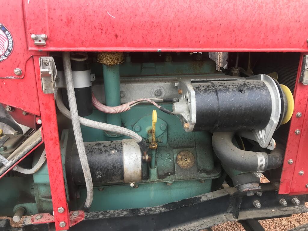

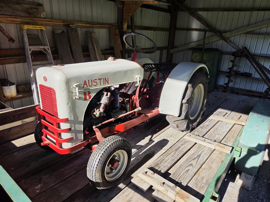

The Fredericksburg Tractor Club has an American Austin Tractor donated to it by a deceased members wife.
It is well built and reportedly was a prototype of a tractor that never made it to production.
It has a similar looking 4 cyl engine, and a gear reduction after the transmission.
Has the same "Austin" badge in the front of the hood
So interesting similarities.

4 minutes ago, Achto said:
Fun fact, this is 6V NEGATIVE Ground. Couldn't believe it until I was looking at it lol
Edited 5 hours ago by Mike'sHorseBarn
Possible to convert it to 12 volts?? Much easier to find a battery & lights...........
  • Like 1
Mike'sHorseBarn
I guess I could if I add an alternator. Just swap the coil as well and call it done.
  • Like 1
squonk

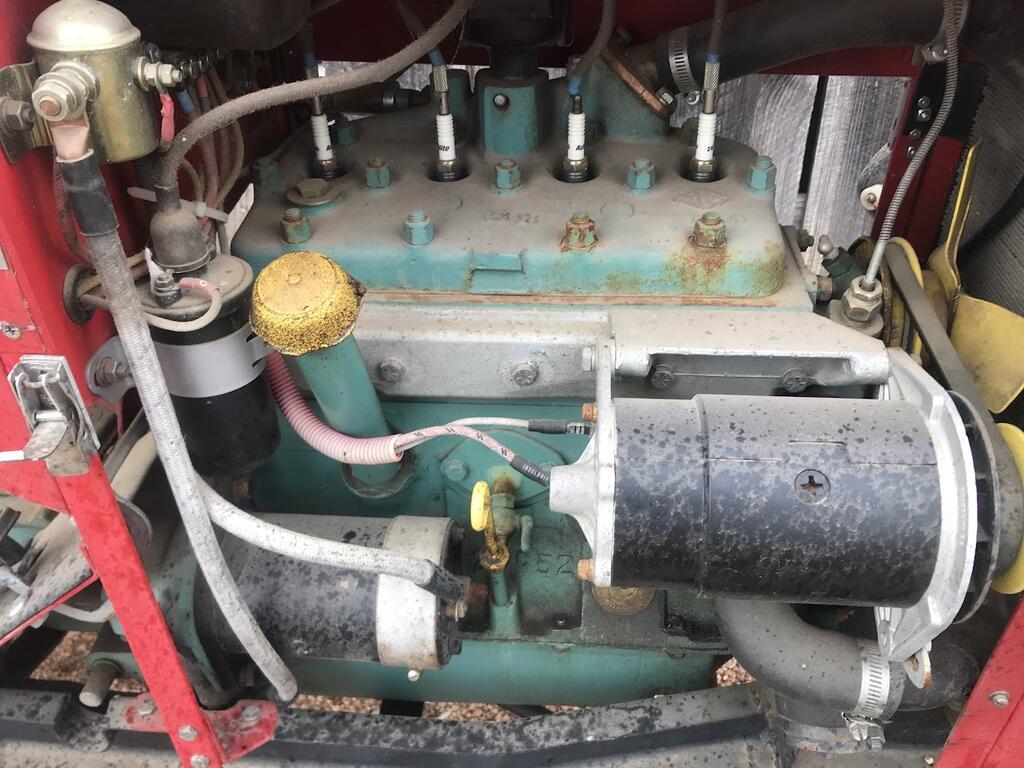

Diggin that starter solenoid! Good ol Delco Remy starter and distributor. Wonder who made the engine. Continental? Hercules? I guess Austin made their own!
https://en.wikipedia.org/wiki/Austin_Motor_Company
Edited by squonk
Mike'sHorseBarn
It's an actual Austin Engine.
Edited by Mike'sHorseBarn

My 1948 Ford was equipped with a 6 volt positive ground system. I removed the generator and voltage regulator replacing them with a GM one wire alternator, added an ignition resistor, changed out the light bulbs and put in a 12 volt battery with a negative ground and everything worked fine. The starter whipped over a bit fast but didn't overheat.

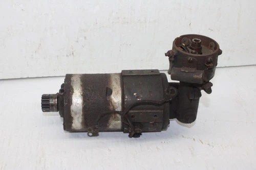

I've seen generator distributor combinations like that before somewhere.
Does anyone recognize it?
Four cylinder Indian Chief motorcycles from the late 30's early 40s had ones that look about like that. What information is on the tag on the distributer?

Mike'sHorseBarn
I'll get a picture of the tag tonight for ya.
