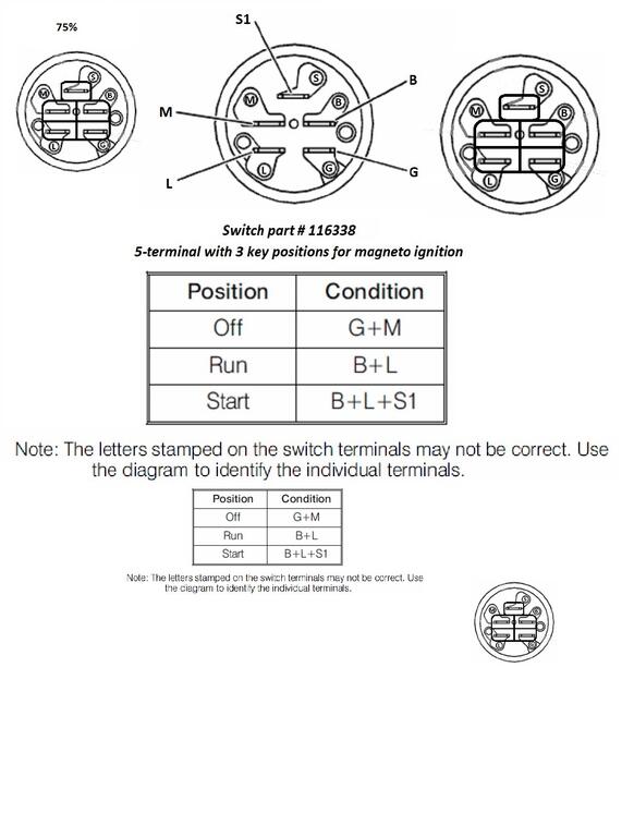

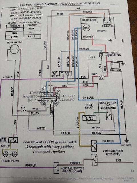

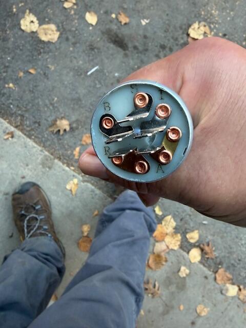

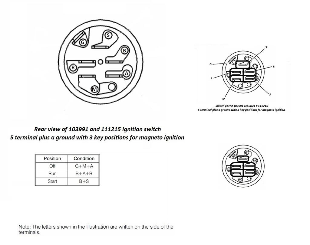

It was running yesterday!! It was running, I shut it off and then went back to restart it and no crank. I pushed it into the garage… took apart the key switch, with 5 pins. Normally. 6 pin on a magnum. I was confused! So, i took out a brand new 103990, but the Run circuit was wrong  B + R+ I+ A.
On the 94, the Run B+L. So, 116338 ignition switch, are there any other part numbers?

The switch in your hand has an I (eye) terminal for battery ignition and the 1994 312 has magneto ignition. The M terminal is required and it connects to the ground terminal in the OFF position. That is what kills the ignition.
If you can disconnect the blue wires to the magneto it should run. Do not allow any battery voltage to get to those blue wires. That creates magneto smoke.
