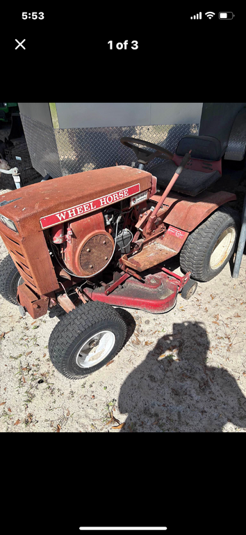

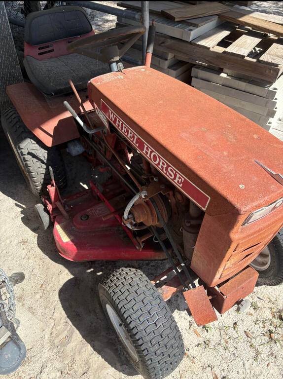

Evening,
Local listed.. Seller states all New tires,New battery, mower and tractor work. Asking $500 obo. What size engine of orignal? hydraulic lift hitch? Any weaknesses with these tractors?

  Originally a Kohler 12…manual lift (can see the lift arm in the pics)

What does the automatic refer to… as in did they make a manual shift Simialr to the ealrier 60s wheelhorses.. since the need to specify Automatic?
oliver2-44
Yes there was a 120-8 that had a 8 speed transmission.
The 120 Auto has the Sundstrand Hydro. To test the hydro Chain it to a tree and verify it will spin the tires forward and reverse.   They are good workers 1-18” rear axles.
From what can be seen in the picture that seat looks like it would clean in nice. Those seats are desirable.

Why the need to chain it and not just drive it forward backward?

Chaining it puts a load on the Hydro to help verify the pump is strong
