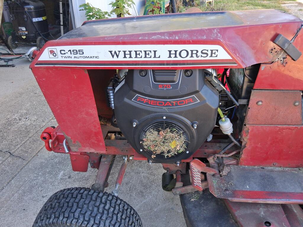

Does anyone else have this problem or better yet a confirmed solution? You will notice the foot pedal could interfere with a shield.

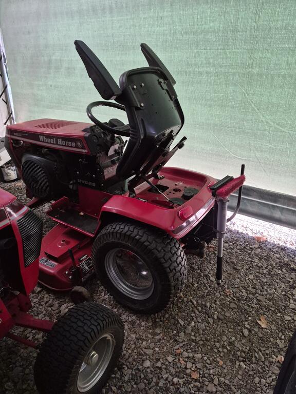

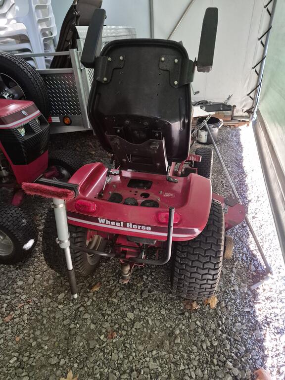

I have come to accept that is just how it is with leaves blowing around in the fall.

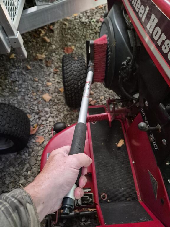

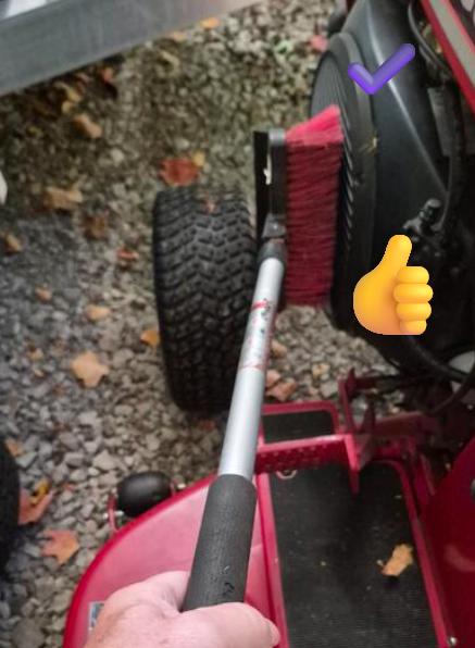

I made up a holder from a bagger bracket to hold a regular car snow brush
You can use anything to hold the brush.
But the main point is that I can use this brush to knock leaves and debris off of the screen while running the tractor.
