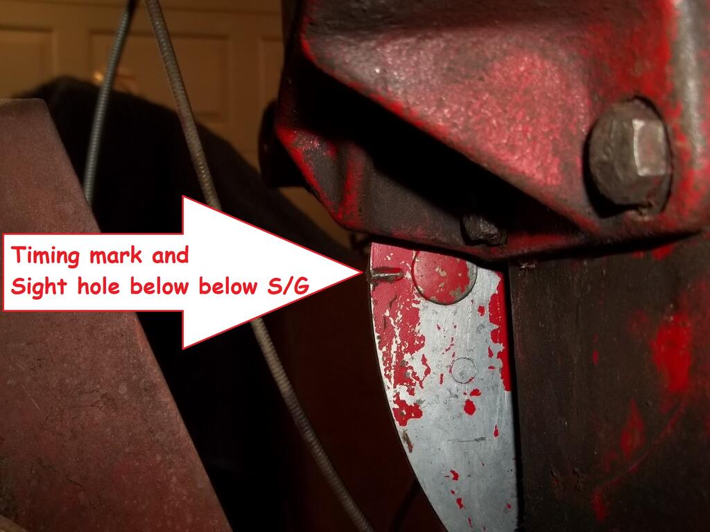

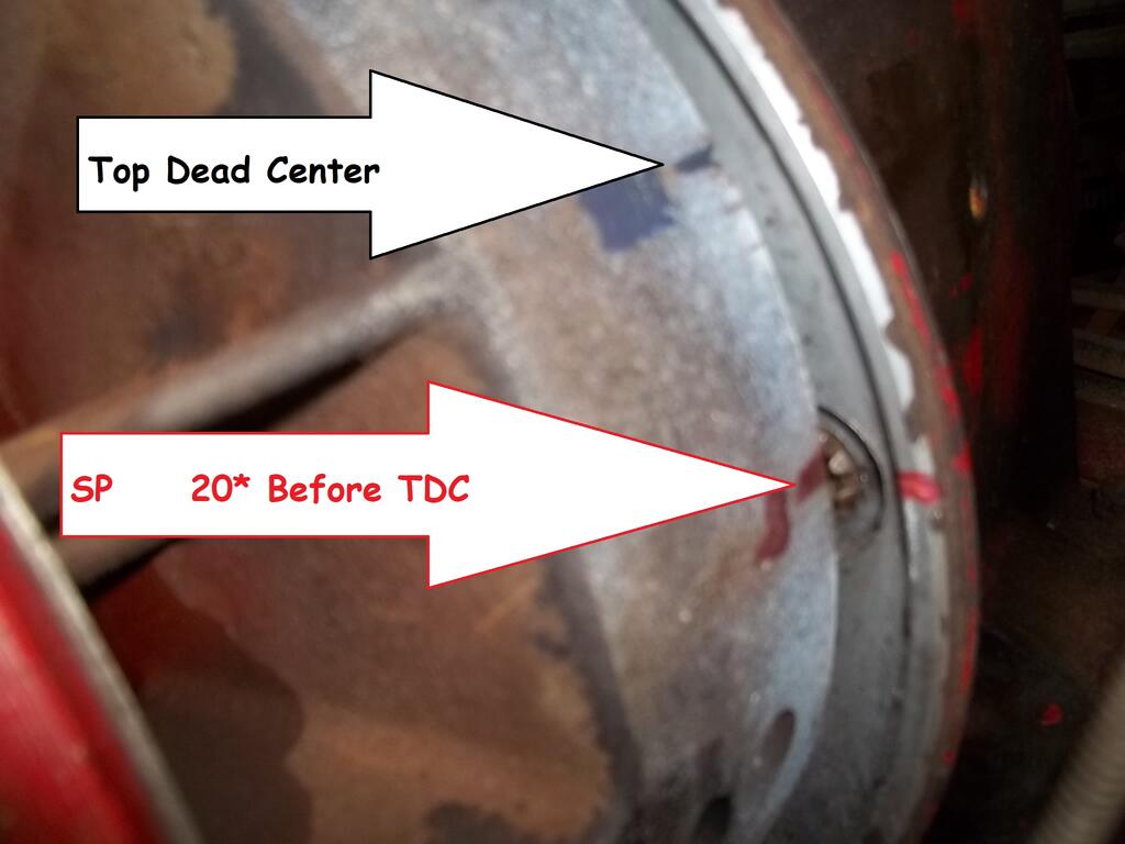

Is it normal for the breaker points to stay closed for over 1/2 turn of the crankshaft?    YES, the points remain closed about 88 % of the time if they are properly adjusted to .020" at the widest opening. You will want to clean the contact surfaces using a brown paper bag or a dollar bill to remove any corrosion. I feel that the most accurate method for setting points is "Static Timing. The points gap not only induces a spark when the points first open, but the points gap sets the ignition timing for your engine. I have attached a YouTube about static timing, To find the timing marks on the flywheel I have found it helpful to wrap some sandpaper over the end of a wood dowel placed through the timing hole in the flywheel cover and turn over the engine with the spark plug removed. you may need to do this more than once to find the marks. The marks will be near the point where the crank is at TDC. When the crank is at TDC the keyway on the PTO side of the crank will also be at the top so you don't have to sand off the whole flywheel, just rock it back and forth an eighth of a turn either side of TDC.

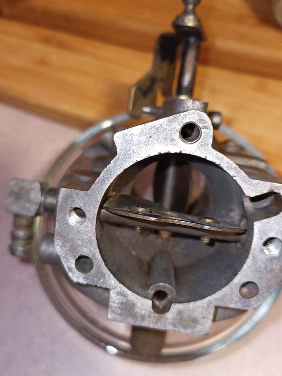

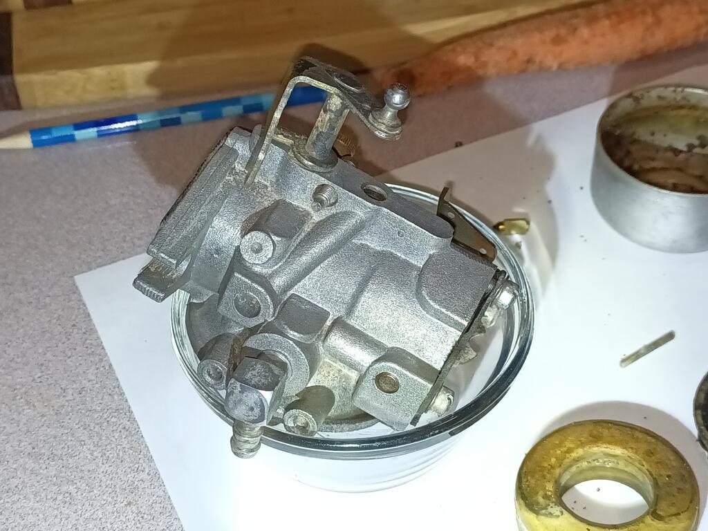

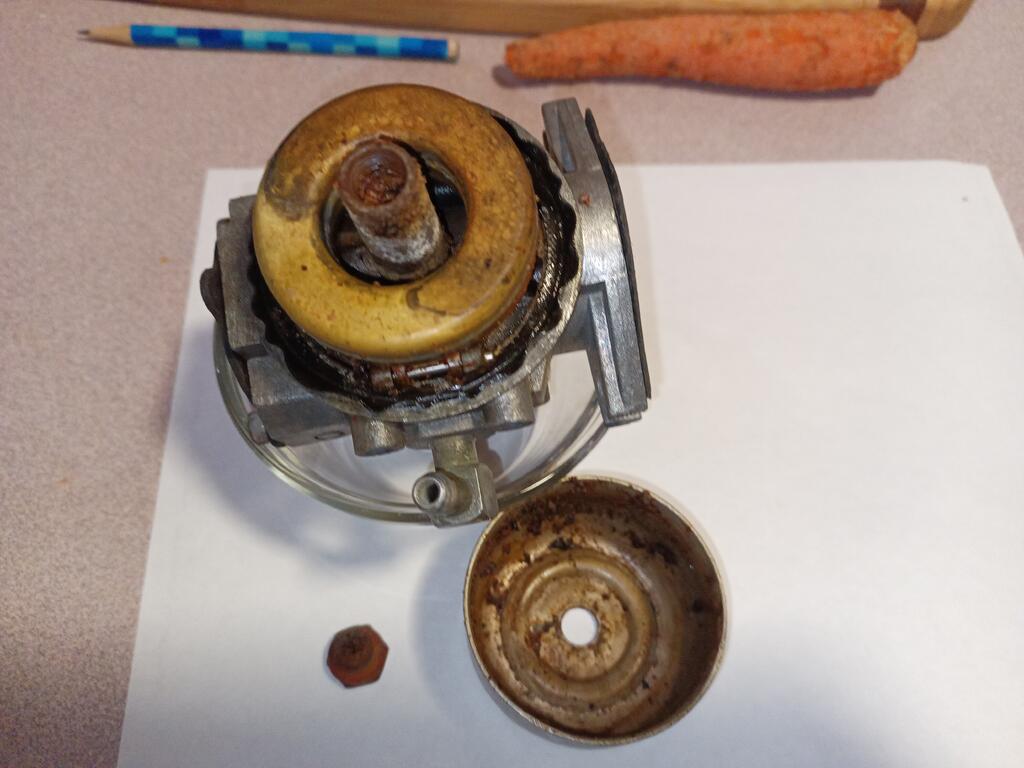

7 hours ago, Charrie said:
I am thinking that i need to remove the carb and disassemble it to see what shape it is in      Good idea, start out with a total clean up of the fuel system and use non-ethanol gas to keep it that way. The disassembled carb and all its parts should be socked in a carb cleaner for several hours. The small passages that can get plugged all need to be cleaned up. You may want to find someone who already has the cleaner and some experience if you don't intend to do more than just this one carb.

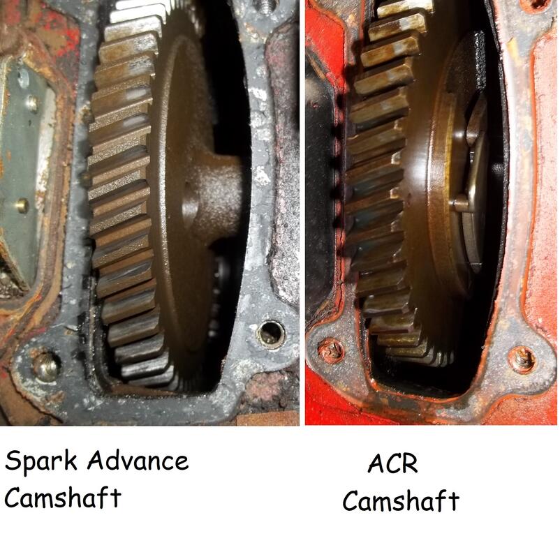

Just noting here that some early S/G K181s (and possibly other engines?) predate the compression release mechanism to help with starting. Instead, they use a mechanical system to retard the spark past TDC until the engine is running. On these, a static timing check is not definitive but setting the points gap is the same.
