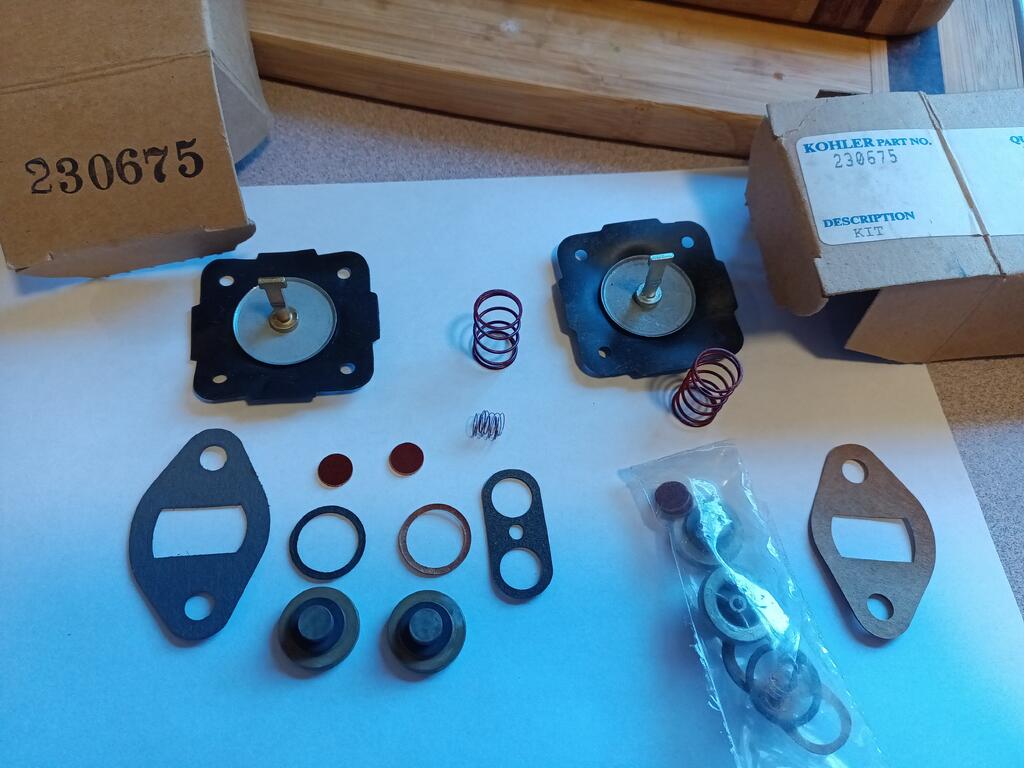

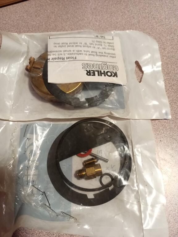

As to fuel pump, It still has the original metal pump. I picked up 2 rebuild kits that I believe fit this pump but I have no idea what all of the parts are for. Hopefully I can find some info on rebuilding the pump. #230675
I have rebuilt 4 of the original fuel pumps and they were all different on the inside but 3 of them looked alike on the outside. You just about have to take them apart to tell which one you have but they were all pretty straight forward to rebuild and they have been doing great ever since. I did have to go back through one of them because it seeped fuel between the pump body were it went together but a little more work on flattening of the two halves of pump body took care of it. I recommend Antique Auto Parts | Weymouth, MA | 781-335-8860 for fuel pump kits not the cheapest but have been the best in my opinion, and have always helped me if/when I had ????'s.

Thanks Sqrlgtr
Both of my pump rebuild kits are Kohler. If the kits don't fit then I do have a Kohler composite/plastic replacement pump I can use but was trying to save it if possible.

Your pictured fuel pump kit should probably work for 99% of the kohler fuel pumps out there    The one-piece valves and round gaskets go to one type of valve body and the one piece gasket, 2 disks and 2 little springs go to the other type.. The one piece valves are also used in early plastic bodied fuel pumps as well.   But first things first, make sure you have spark, then deal with compression issues (if such an issue exists)  , then figure out carburetion (dont need fuel pump if you can rig up a gravity fed drip to the carburetor)  and once those are solved, you should be able to get the engine to run. With that out of the way all the rest is just "support systems" to dial in.

When you disassemble the fuel pump, some have independent small valve disc and tiny springs under the valve aluminum keeper. Be ready they jump out or be stuck in place

Oliver2-44 , I saw those 2 small springs in the kit. I have on old 10gal fish tank that is great for taking things like this apart in. at least there is a good chance to catch anything that might spring out. I put a piece of cardboard over half of the top to block some of it.

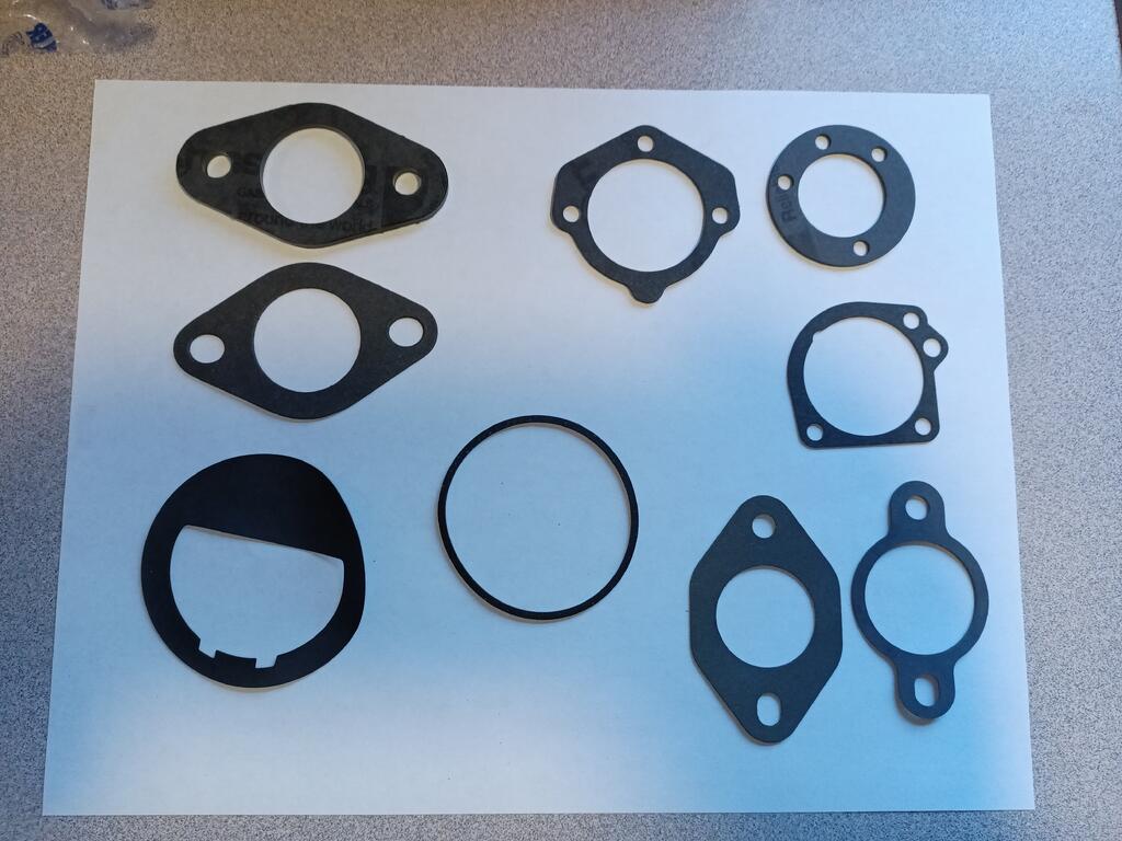

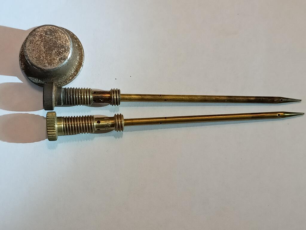

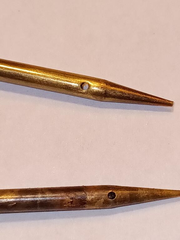

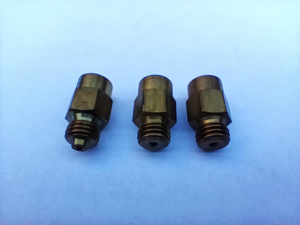

I picked up a box labeled miscellaneous carburetor parts at the hardware store that's closing and the guy gave it to me. Inside was some loose parts like needle valves and ect from kits that had been opened It was all Kohler parts. I managed to piece together what I believe to be a carter #30 partial rebuild kit along with a new float kit. According to the part numbers on the packages, they should work. There was also a complete Kohler kit for a walbro 25-757-11-s. From everything I have read, my carb should be a Carter #30.
Maybe one of you guys could look and see what you  think? Also there are 3 different I think (main jets)? 2 are the same while one is different and I see no numbers on them. The different one is smaller than the other 2 and has a tapered tip on it. I also found a package that was mostly intact and had the smaller jet in it. That package part number is 2575701 and google search says it fits a carter #30.
  The float kit #2575703s also is supposed to fit a Carter #30.
I know the carb parts are getting ahead as the carb may not even be any good inside but the box of parts was free.
Also there were several loose gaskets and i believe they may also fit. Perhaps one of you all might know.

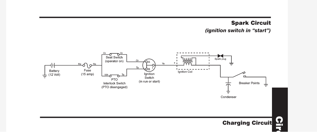

I am trying to understand the wiring diagram so I can test to see if I am getting spark. Right now when turning the key to the start position, nothing happens.
The diagram shows a rectifier I am not sure that my 1985 has a rectifier,  believe it is unregulated. I do have a Kohler 15amp 3 blade regulator but my understanding from recent reading, one would have to change the stator and do some rewiring. If it works fine like it is then why change it?
But here is how I interpret the diagram.  One thing that I do not understand is how the seat switch works. Why does it go to the A (Accessory) terminal on the ignition switch? How would not having power on that terminal keep one from starting the engine or kill the engine if you get off the seat?
Also i found the seat and PTO switch wires to be spliced together bypassing the switches. I have no clue about the pedal switch yet.
1- The PURPLE wire goes from the S (start) terminal  on the ignition switch to the S terminal on the solenoid. There is a pedal interlock switch in that circuit requiring the pedal to be pressed to close the switch.
2- The YELLOW wire runs from the I (ignition) terminal from the ignition switch to the positive terminal on the ignition coil. The negative side of the ignition coil is grounded through the breaker points and condenser.and when the breaker points are open, a spark is created at the spark plug.
3- So, how does the ignition switch receive its 12v power to power the I and S terminals? From the B (battery) terminal on the ignition switch right?
From the positive on the battery a RED wire goes to the starter solenoid B terminal. A second RED wire goes from the Starter solenoid B terminal  to a 15amp fuse where the RED wire splits  and one side stays RED while the other becomes ORANGE.  The RED terminates and turns into 2 WHITE wires. One WHITE wire going to what appears to be a diode that might come from the stator. The other WHITE goes to the PTO interlock switch.
From the PTO interlock switch, the WHITE wire now turns to TAN and connects to the B (battery) terminal on the ignition switch.
The ORANGE wire runs to the seat switch and then to the A (accessory) terminal on the ignition switch.
To hotwire, don't I just run a wire with 12 volts to the positive on the ignition coil and then jump out the solenoid to engage the starter? That should bypass everything and i should be able to see a spark on the grounded plug?

My suggestion is to download the "demystification guide" from the electrical section of our manuals.
Page 423 has the circuitry for your 416-8.
Here is a cut from the manual for your spark circuit.

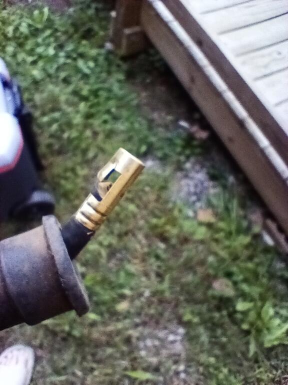

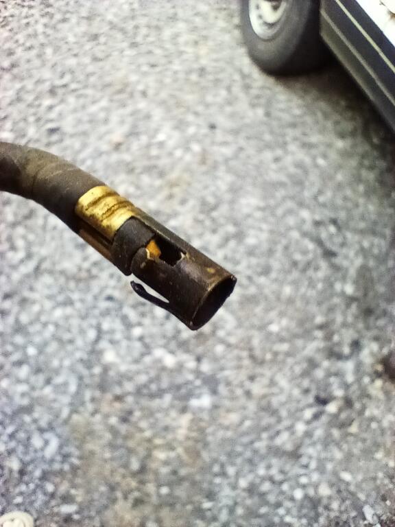

Thanks for the replies and help. GREAT NEWS, it tries to run with carb cleaner, that's all I had to use besides gasoline. Probably got a 3 to 5 second run time. Followed everyone's advice and found the reason for no spark was mainly the breaker points gap was too wide and they never closed.
Couple of questions though.
1- The side of the coil wire that goes into the coil was very black. The coil itself looked like new and the PO said that he had replaced it. What can cause that as it fit pretty snug into the socket? I cleaned it.
2- One of the 4 screws that hold the flywheel dust screen to the flywheel is turned out a few turns and works great to help turn the flywheel. Anyway, When testing the breaker points open/close with my ohm meter, the meter would give a tone when that screen screw was at about the 3 o'clock position. As I turned the flywheel clockwise, the tone stopped (points opened) at about 10 o'clock. Is it normal for the breaker points to stay closed for over 1/2 turn of the crankshaft?               AH, maybe this 1/2 turn is engineered for timing adjustments?   Did not attempt timing yet but great video. I couldn't find the timing marks on the flywheel through the peephole.

Gasaholic
Fairly normal - brass/bronze will naturally tarnish and turn black from oxidation , higher temps accelerate that, but unless theres signs of burning (from poor contact and arcing) its fine.
timing marks arent always obvious and sometimes rust./ corrosion over time obliterates them. easy enough to paint your own marks if you can precisely locate TDC and then use a protractor to back up the flywheel to number of degrees BTDC to make your timing mark where points should open. Note that SOME engines (not too many) had an actual timing advance built into the camshaft (often problematic, now obsoleted) but unlikely to have that in your engine.
Breaker points are normally closed LONGER than they are open - that's the Dwell time/ Dwell angle -  points closed means capacitor recharging so when they pop open (usually open just a few degrees) that sudden collapse of electrical flow is discharged from the capacitor which induces the voltage in the secondary winding to produce spark.

Ok, so I guess next is to get fuel to the engine. The tank is pretty dirty inside and I don't remember seeing a fuel filter yet. I am thinking that i need to remove the carb and disassemble it to see what shape it is in. Outside has some white powderish oxidation, I believe it is and looking inside the throat of the carb, it is the same. The choke cable will not move and I believe the cable is fine but the choke rod is stuck. I did pull out the high speed needle adjustment screw. It was a little hard to turn but did come out ok. ITs a little tarnished but overall looks ok "to me". Doesn't appear to be bent and no signs of being over tightened in the jet.
Yes will be taking the gas tank off to clean it as well as new fuel lines and filter.  The fuel tank cut off valve has a find screen on it. Should I attempt to remove the fuel cut off valve at the tank and clean it or leave it alone due to the rubber seal?
So where to from here?
I do have small fuel tank can use as an IV drip for testing.
Once running then I will remove the cylinder head and do that work. Also there is the water I found in the transmission. Both PTO pulleys were frozen along with at least one of the mower deck bearings. I am guessing that the idler pully for the clutch may be bad also.
Question about rebuilding the carb. I have rn across several articles and one that goes into great depth about rejetting these carbs or replacing the high speed adjustment needle. There is an article here on our forum I believe about drilling out the high speed adjusting needle. Does anyone know anything about this and what it does? I ask because in my carb parts there is a new high speed adjusting rod but it has a couple extra holes already in it.
Thandk
Charrie
Your high speed jet as pictured doesn't especially matter the number of holes and hole sizes. The hole at the tip of the screw supplied fuel up through the hollow tube and out the holes in between the threaded portion that supplies the idle circuit with fuel for idle (and high idle) fuel supply - restrictions to flow can lean it out - excess flow can be regulated by the idle adjustment needle for a smooth idle and transition through top no load - once the engine is under load the throttle opens and fuel is then controlled through the main venturi by means of the high speed adjustment needle.   With no load the majority of fuel is being sent through the idle circuit, since the throttle plate is too closed to pull (very much) fuel out the main jet.  Drilling out the high speed needle to larger allows more fuel to the idle circuit supply, but usually a good clean high speed needle is enough.
However if you find holes in the middle of the thin tube in middle of the venturi it's rather important to NOT alter those holes which are very precisely jetted unless you really know exactly what you're doing. Most carburetors had the main jetting in the center emulsion tube and amount of fuel controlled by the taper of the high speed needle adjustment.
Lastly if your points were adjusted so that they never closed, you might want to consider a closer look at them as the flat spring that closes them can weaken over time and allow points to "flutter" allowing a misfire .. if it was me, I'd probably plan oni getting a full tune up set (points, condenser, pushrod, box gasket, and box grommet - 220297-S would be that part number -) once you got it running reliably otherwise, then you should be set up to not need to worry about ignition (other than spark plug changes) for several years.
