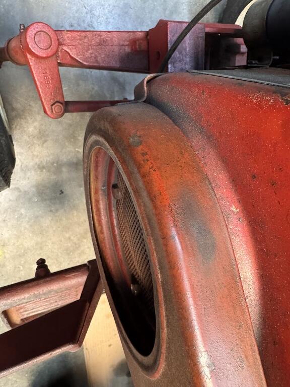

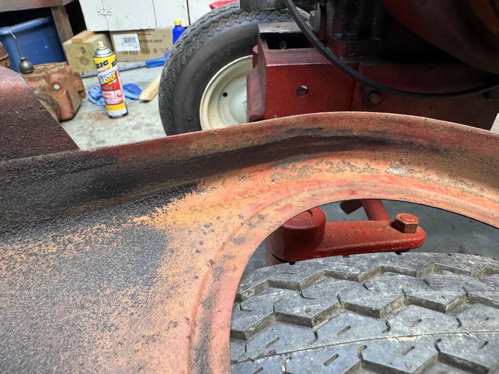

Bar Nuthin 3,611 #1 Posted October 11 (edited) This is my first tractor with a generator. It starts and charges good, but I'm wondering how quiet it should be. In my opinion, it is whining more than it should (if at all). Also, there seems to be some noise from the belt slapping the guard. I tightened the belt, but it still seems make some noise and there a black streak at the top side of the guard on the inside. Should there be any belt slap at all? Maybe the guard is just misaligned slightly? Ideally, it would be pretty quiet, but maybe I'm just wishing. I'm not sure if I can pick the sound up on a video, but I'll give it a try tomorrow. Edited October 11 by Bar Nuthin 1 Share this post Link to post Share on other sites
pfrederi 21,340 #2 Posted October 11 Does the guard get hot at the the area that has the black mark. Belt may rub on the guard can take some work to get the guard away from the belt.Things get bent misaligned over the years 3 Share this post Link to post Share on other sites

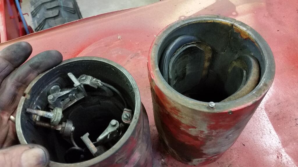

WHX?? 58,386 #3 Posted October 11 (edited) 22 minutes ago, Bar Nuthin said: it is whining more than it should Yep bad bearing if whining at all. Sometimes it will go away but then come back or I have had them whine ... go away then not come back. Strange had them that were not noisy when put away for winter but then whine when comes out. Easy enough to replace but be ready for black fingers when you open them up. Or wear gloves. Real common 6302 or ....crs ...6203 bearing. Get them on fleabay then do the Greasy Pete repack. Need any help I done zillions of them. Bulk of my tractors are SGs. Yeah belt guards are notorious for coming loose and rattlin around. Watch for pully burn marks too. Mostly on the SG. Edited October 11 by WHX?? 1 1 2 Share this post Link to post Share on other sites

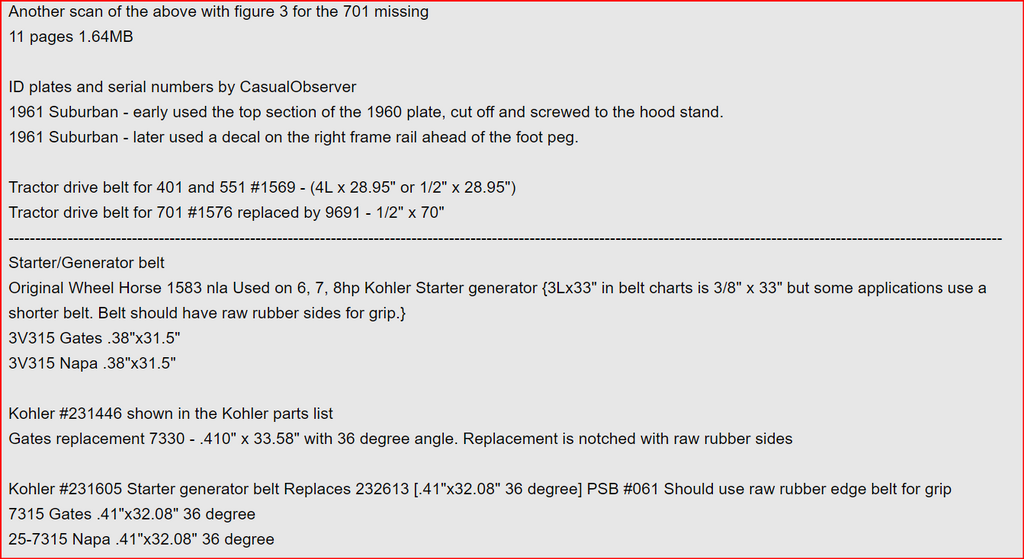

wallfish 20,742 #4 Posted October 11 to both of those posts. Any black powder from any belt is rubbing. Not sure what you mean by "black streak" but assuming it's belt powder. No belt slap on a SG. It's short enough and should be tight enough to be like a guitar string. Tweaking the guard position should solve any rubbing or you have the wrong belt. I prefer the 31.5" x 3/8 raw edge cog belts for the K181s. Something like this https://www.ebay.com/itm/200779063408? 6 Share this post Link to post Share on other sites
Bar Nuthin 3,611 #5 Posted October 11 25 minutes ago, pfrederi said: Does the guard get hot at the the area that has the black mark. Yep. Looking at it again, where it gets warm and has black streak on the inside - I just noticed that the paint is slightly discolored on the outside. 22 minutes ago, WHX?? said: Yep bad bearing if whining at all. That actually makes me feel better. Rather find a noise I can fix, rather than one I would just have to live with. 1 Share this post Link to post Share on other sites
Bar Nuthin 3,611 #6 Posted October 11 2 minutes ago, wallfish said: I prefer the 31.5" x 3/8 raw edge cog belts for the K181 Pretty sure what is on it currently is 1/2". I'll have to check the length tomorrow. It's a K161. 1 Share this post Link to post Share on other sites
wallfish 20,742 #7 Posted October 11 (edited) 6 minutes ago, Bar Nuthin said: Pretty sure what is on it currently is 1/2". I'll have to check the length tomorrow. It's a K161. Should be the same as a 8 The belt should be pretty skinny and fit down inside of the groove of the pulleys. 3/8" The cog belts grip tighter on the smaller generator pulley than a solid belt does. They should be raw edge too as you don't want any slipping of it A 1/2 belt would cause the issues you have Edited October 11 by wallfish 2 3 Share this post Link to post Share on other sites
WHX?? 58,386 #8 Posted October 11 8 minutes ago, Bar Nuthin said: have to live with. I have ran noisy SGs for a long time. Good intentions on fixing but then some other project pops up. then I hop on that tractor and mutter i really should fix that ... some day ... 'Fish is 100% 3/8. You ever order and get those belts John? Their almost given them away. Wasn't it @Sparky that paid way more for a NAPA? I'm always leary about ordering/getting belts online. never seem to get the right one. 2 Share this post Link to post Share on other sites

ri702bill 13,373 #14 Posted October 11 (edited) The early Kohlers used on the 1961 to 1964ish S/G's have two ball bearings and two external oil cups. If yours has them, try a few drops of light oil and see if the whining stops.... that only works with the original bearings. Those would have been an open style to allow the oil in - replacing them with modern double sealed bearings make the oil cups just an ornament of the past, The post 1965ish models use one ball bearing at the pulley end and a bronze bushing at the other.... Almost always, the noise is coming from the bearing at the pulley end. Use a Mechanic's stethoscope to verify.... Ditto on the 3/8 x 31.5 raw edge cogged belt. That is the one you want. Install a new one, run it a few hours and re-adjust (tighten) after the side edges settle in... Edited October 11 by ri702bill 2 Share this post Link to post Share on other sites

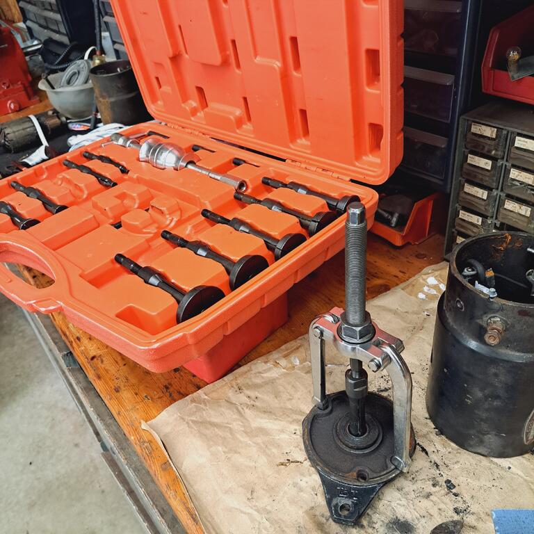

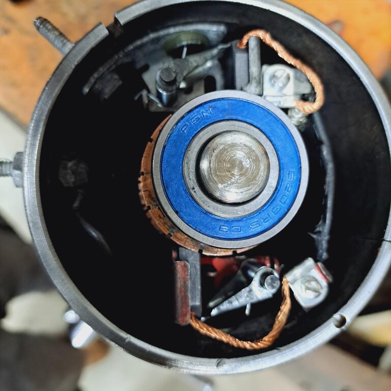

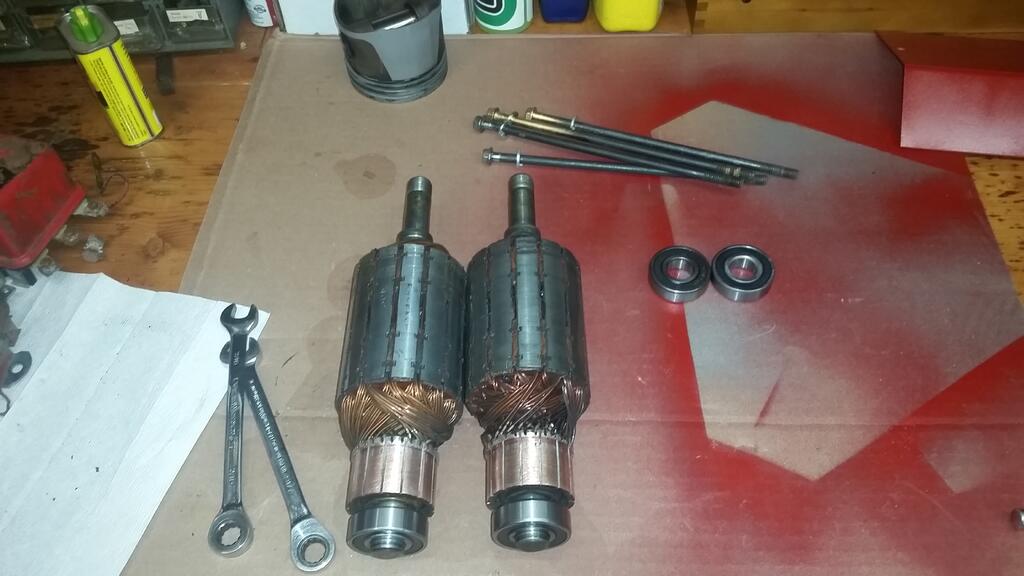

WHX?? 58,386 #16 Posted October 11 10 hours ago, Bar Nuthin said: telling my wife I was getting a tractor like this one. And sending the show HLs to WHX ... oh that's right I don't have one like that ... yet ... but when I do... 2 hours ago, ri702bill said: a bronze bushing at the other.... I have yet to pull one that had a bushing yet still had oiler cups. Very seldom had to replace brushes Richard 2 hours ago, ri702bill said: Use a Mechanic's stethoscope to verify.... Doesn't matter you have to perform surgery both are gonna get replaced. I really should do that SG instructional some day ... along with fuel pumps. Pics for motivation Bar. Note the black fingers ... dummy was too dumb to were gloves ... 4 Share this post Link to post Share on other sites
Bar Nuthin 3,611 #17 Posted October 11 2 minutes ago, WHX?? said: I really should do that SG instructional some day Your photos speak a thousand words! Thanks! Share this post Link to post Share on other sites

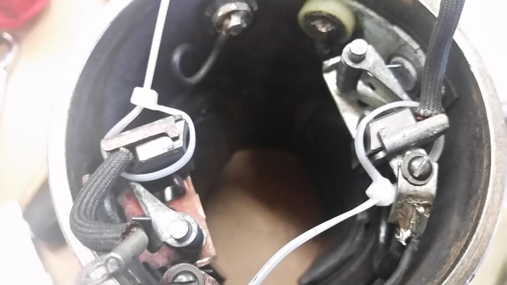

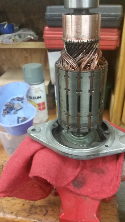

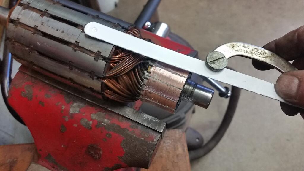

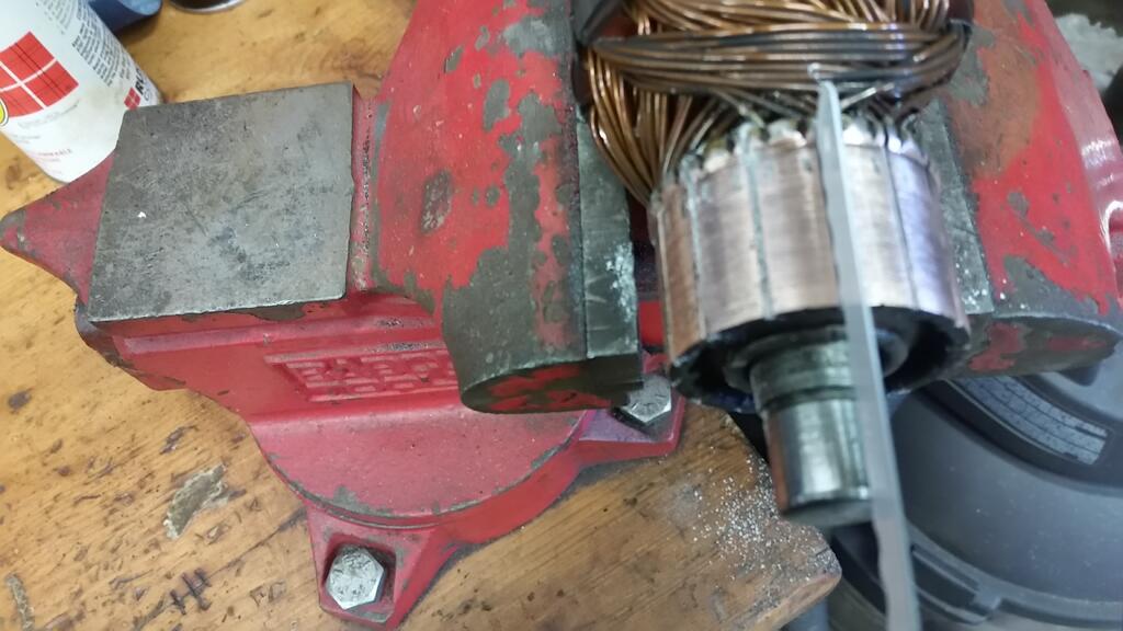

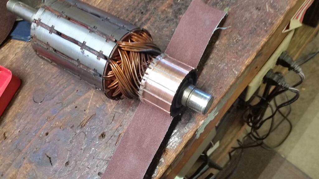

ri702bill 13,373 #18 Posted October 11 It is extremely important to undercut the mica on the armature, but must be done carefully. It not only removes the brush carbon that can short 2 adjacent contact pads, but gives room for more! 6 Share this post Link to post Share on other sites
WHX?? 58,386 #19 Posted October 11 3 minutes ago, Bar Nuthin said: Your photos speak a thousand words! Thanks! Your ... evidently I have the pics to do that instructional! 3 1 Share this post Link to post Share on other sites
squonk 48,423 #20 Posted October 11 I have several pieces of cardboard that look just like that! 5 Share this post Link to post Share on other sites
Bar Nuthin 3,611 #21 Posted October 11 (edited) 3 hours ago, squonk said: I have several pieces of cardboard that look just like that! Could be the start of a whole new thread. "Show us your Cardboard" - subcategories "paint silhouettes" and "grease and oil catchers" Edited October 11 by Bar Nuthin 1 4 Share this post Link to post Share on other sites

Bar Nuthin 3,611 #23 Posted October 11 16 hours ago, pfrederi said: Does the guard get hot at the the area that has the black mark. Belt may rub on the guard can take some work to get the guard away from the belt.Things get bent misaligned over the years The front tab seems to be the one holding the guard too low. Proceeding cautiously so I don't f**k it up. 1 Share this post Link to post Share on other sites
ri702bill 13,373 #24 Posted October 11 If you remove the guard (for test purpose only) is it still loud?? 1 Share this post Link to post Share on other sites
