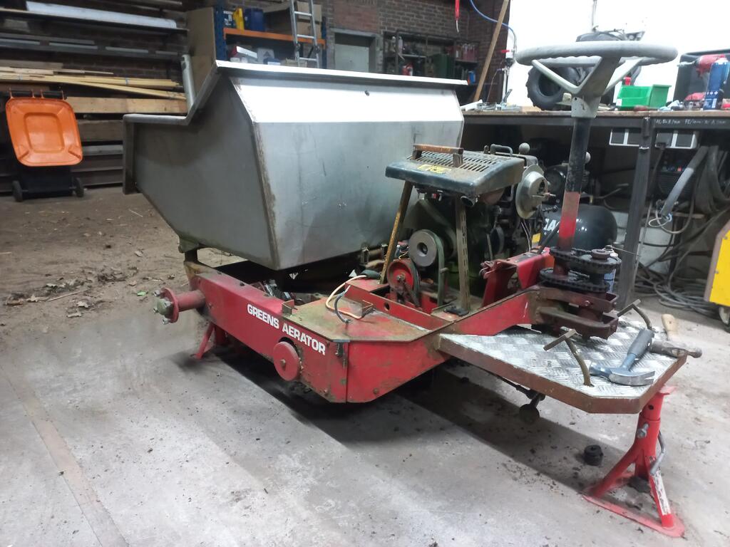

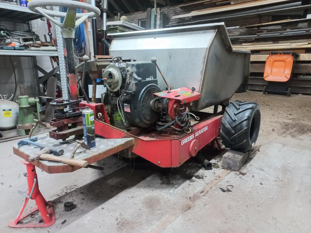

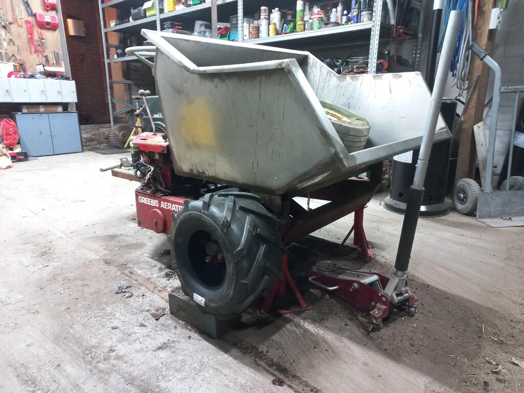

sjoemie himself 3,276 #1 Posted October 9 "Another topic!?" I hear you think.. yes.. this thing has been sitting in my yard for way to long. Now with the darker, colder and wetter weather coming up I would like to get it going. The idea is to use it around the house and for the better half to use it to rid the paddocks of horse crêpe.. Bought it off my neighbour a few years ago where it had been sitting long enough a small tree grew through it. "It" in this case is what started it's life as a walk behind Toro Greens Aerator. Kind of a coring machine specifically for golf courses. Somewhere in it's previous life somebody deleted the aerating part of the machine and put a dumping bed on the frame along with a seat. What you see below remains. Lots of stuff to do. Started to clean up the rims, ordered new tires, valve stems and a bit of paint yesterday. Took the fueltank which was full of water off along with the improvised hydraulic oil tank which was also full of water. I'm hoping the pump has survived, if not I might have to order one for it. Good news is that it has a Kohler 16hp engine which seems to be in good condition. Carbs' clean, airfilter Ok-ish, oil on the dipstick. Only thing is the starter does turn when connected directly to a battery however does nog engage the flywheel gear thingamabob.. might be a solenoid issue?? Stripped down a bit for cleaning/inspecting Other side. Note the hydraulic pump is driven off the flywheel side of the engine. New rubbah.. Quite a wide load. Thanks for reading! Greetings from the Netherlands, Mark 2 6 Share this post Link to post Share on other sites
ri702bill 13,344 #2 Posted October 9 Nice! The starter spinning but not engaging sounds like the starter drive Bendix is gummed up and sticking. It has nothing to do with the solenoid... Clean the drive, do not use oil or grease. Dry lube only. 4 1 Share this post Link to post Share on other sites
oliver2-44 11,837 #3 Posted October 10 3 hours ago, ri702bill said: Nice! The starter spinning but not engaging sounds like the starter drive Bendix is gummed up and sticking. It has nothing to do with the solenoid... Clean the drive, do not use oil or grease. Dry lube only. 2 Share this post Link to post Share on other sites
SylvanLakeWH 32,868 #4 Posted October 10 Very cool! That "seat" pedestal will keep you toasty warm!!! 1 2 Share this post Link to post Share on other sites

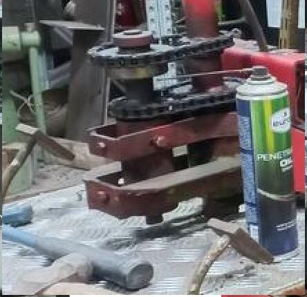

953 nut 70,504 #8 Posted October 10 I am a bit puzzled by the chain and sprocket setup on the steering. It appears to have to have a small sprocket driving a larger sprocket mounted to a shaft that has a smaller sprocket driving a larger sprocket mounted to the first shaft. The two chains would bind each other unless there is some sort of clutch that allows you to shift from slow steering to quick steering. 1 Share this post Link to post Share on other sites
sjoemie himself 3,276 #9 Posted October 10 3 hours ago, 953 nut said: puzzled Good eye! I had the same confused look at first. It works because it's not one continuous shaft but rather a multi piece shaft with bushings around it. Turns out it's a (small) gear reduction to lighten te steering input a bit or make it less sensitive. 2 1 Share this post Link to post Share on other sites
sjoemie himself 3,276 #10 Posted October 11 (edited) It's alive.. ALIIIVVEEE! Starter freed up on it's own.. or I might have had some wires switched around.. I guess we'll never know Took the oilpump, oiltank and gastank off, rinsed, cleaned them all thoroughly. Put them away to dry out for a few days. Made a tiny test gastank and after some fiddling around I found out somebody had put the wrong sparkplug in the engine. It poked to far into the cilinder and made contact with the piston. Luckily nothing got badly damaged and I found a better sparkplug laying around so put that in. Cleaned the carb and took out all kinds of gunk and nastyness from the floatbowl, freed up the float needle and hooked up my tiny test tank. After a couple of tries the Kohler started to cough and flung debris everywhere. Succes! After that I tested the transmission which worked perfectly fine. It's a bit quirky though. It's got one high and one low forward gear and one reverse. The drive is opposite of what you would expect, the drive engages when you step on the clutch pedal and disengages when you let go. For the intended purpose this might be rather handy cause when cleaning the paddocks it's a lot of stop and go/on and off the machine. With this setup there's no need to put the machine in and out of gear everytime you get off the machine. We'll see though, only time will tell. Edited October 11 by sjoemie himself Made vid work 1 3 Share this post Link to post Share on other sites

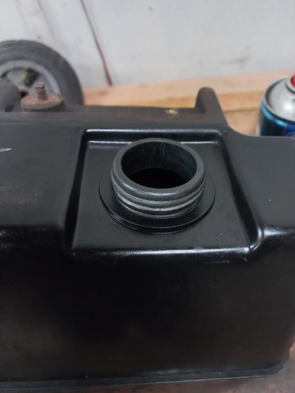

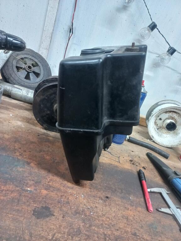

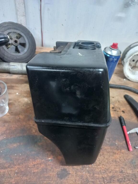

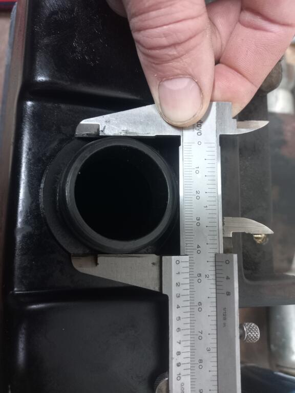

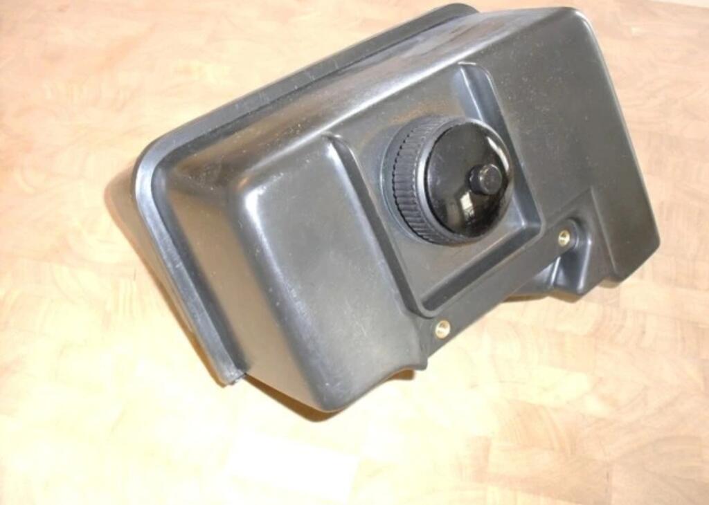

sjoemie himself 3,276 #13 Posted October 14 (edited) This is what tank and gascap (should) look like @ebinmaine and others Some pics of my actual tank. It measures about 44.6mm that's close to 1-3/4" Edited October 14 by sjoemie himself 1 Share this post Link to post Share on other sites
ebinmaine 81,211 #14 Posted October 14 12 minutes ago, sjoemie himself said: gascap @sjoemie himself Interesting timing! Just a couple weeks ago I made a thread on a Kohler Magnum 8 HP cap. The Ariens part number in the thread should be available on the market for a lot less than the Kohler and you'll have a guage! 1 1 Share this post Link to post Share on other sites
sjoemie himself 3,276 #15 Posted October 14 Thanks @ebinmaine I'll snoop around a bit. First results I'm seeing ship from the US of A and if I add up import fees, shipping and what not that amounts to a total of about $75,- I might try my local lawn and garden shop this weekend.. maybe they'll have something laying around. 3 Share this post Link to post Share on other sites

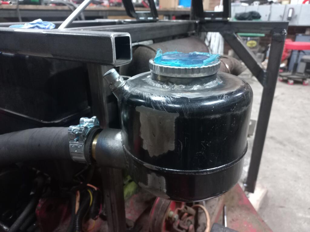

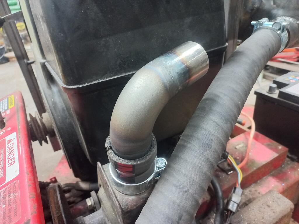

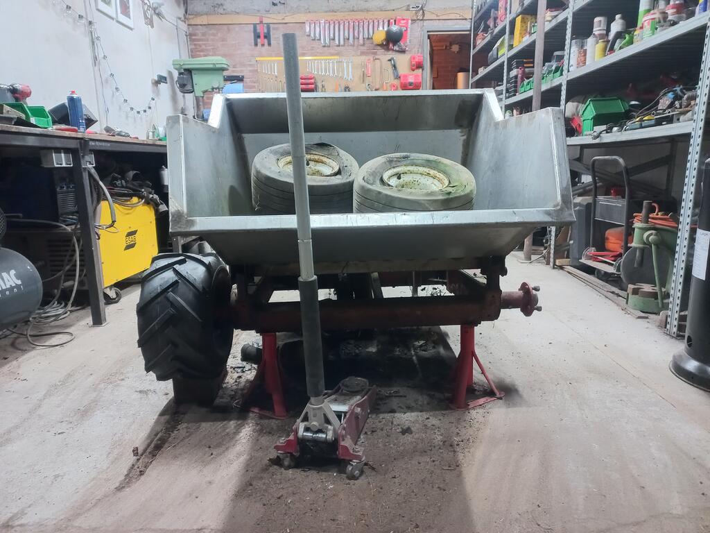

sjoemie himself 3,276 #17 Posted October 21 Update time. Went to the local mower shop and figured surely they should have something laying around. Well that was a no go. In an entire building filled with mowerparts not one cap that would fit my Kohler gastank I tried looking up several numbers on the Interwebs as suggested by @ebinmaine and others mentioned in several topics but all those caps once delivered to my doorstep cost $50 and upwards. Anyhow, enough with that. Here are some things that did work out. Made a new support structure for the seat. The PO welded pieces of shelving to the headstuds to place a seat. I could not bring myself to leave that as it was so made something else. Installed a new seat that flips up to access the fueltank, engine dipstick and newly fabricated and installed oiltank. New seat installed. Seat flips up to reveal the gastank, dipstick and oil reservoir. Even made a 'hold-the-seat-up-stick' to make life a bit easier. One thing I have to adress here is the way the exhaust ends. It's a bit too close for comfort to the right leg. Thinking about adding a (bit of) elbow to the tip to point it away from the drivers leg or adding somekind of mesh, maybe both. Oil tank made from a reservoir that's normally used for hand operated pumps on (car) trailers. Added a filler neck and cap, breather and a large fitting with barb to hook up the feed-line to the oilpump. New tank holds about 2L or ~0.5 gal. Made a elbow thingy that adapts to the original tiny oil-reservoir to the larger tank. Greetings from the Netherlands, Mark 3 Share this post Link to post Share on other sites
ebinmaine 81,211 #18 Posted October 21 1 hour ago, sjoemie himself said: One thing I have to adress here is the way the exhaust ends. It's a bit too close for comfort to the right leg. Thinking about adding a (bit of) elbow to the tip to point it away from the drivers leg or adding somekind of mesh, maybe both. Normally I try to remember to delete the pics from a "quote" but I left this one on purpose. Two things: 1. Was it me, I'd be prone to cut off most of that exhaust pipe and aim the heat oit sideways if possible. I do NOT know what other components are in that heat path/direction/zone. 2. Do you have the engine top cover? The sheet metal that goes over the cylinder head is pretty important for the cooling system as a whole. 1 Share this post Link to post Share on other sites
sjoemie himself 3,276 #19 Posted October 21 36 minutes ago, ebinmaine said: engine top cover Yes, I have all the sheetmetal including the exhaust cover/protection part. That kinda fits kinda doesn't.. the 'restoration me' wants to keep it in one piece/original but then it won't sit quite right. The 'getting things done' me says cut it and make it fit. Not 100% sure on that one.. Same thing about cutting the exhaust, it's in good condition and another one is 'Unobtanium' around here.. Third option for a shroud like cover would be to make something from scratch.. I do have some perforated sheet laying around. 1 Share this post Link to post Share on other sites
Handy Don 17,705 #20 Posted October 21 1 hour ago, sjoemie himself said: Same thing about cutting the exhaust, it's in good condition and another one is 'Unobtanium' around here.. A half-measure might be to pick up a tailpipe tip (as on many autos to make the end of the exhaust look nice) that has a slight curve to redirect the exhaust more sideways? 1 Share this post Link to post Share on other sites

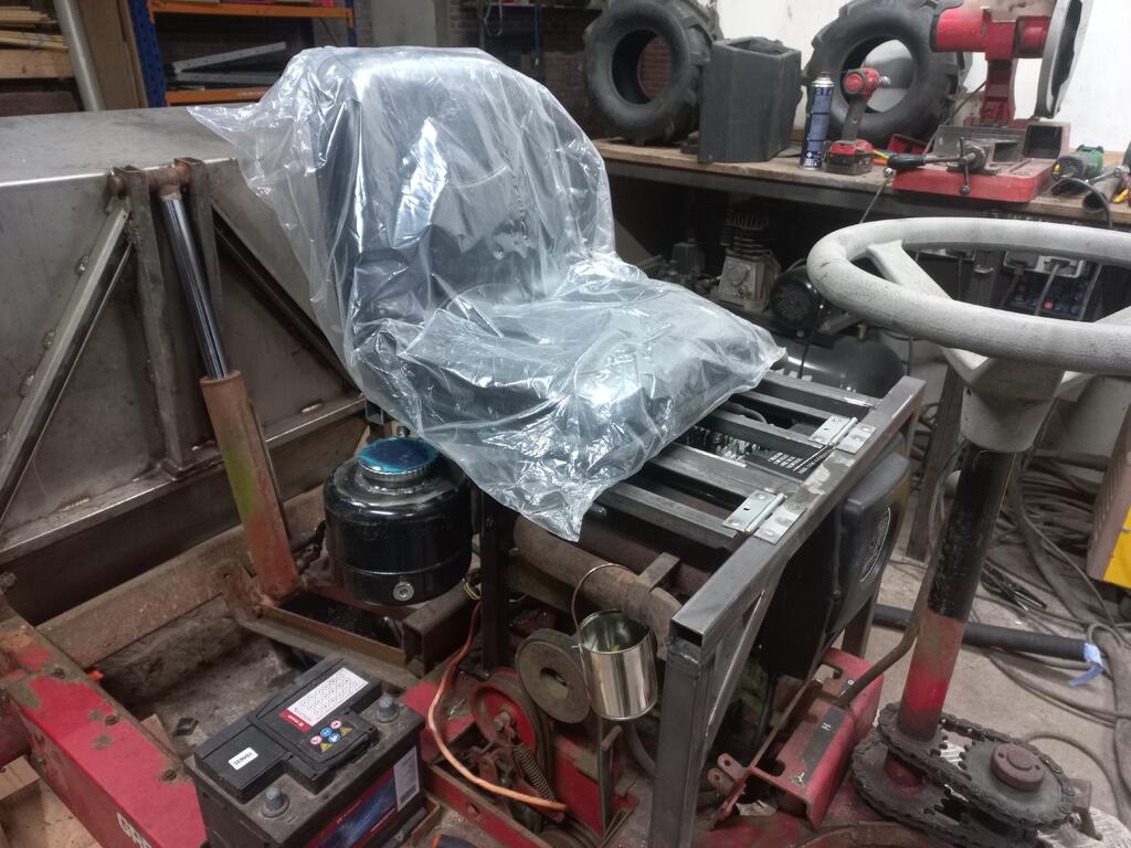

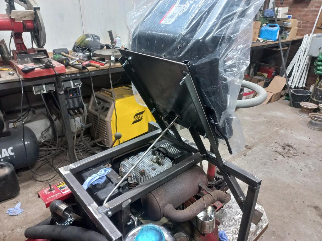

sjoemie himself 3,276 #21 Posted October 25 Buttoned up a bunch of small things. Welded some proper hinges to the seat, plumbed the hydraulic system, filled it up (no leaks!), installed new air cleaner elements, fitted an extra heat shield/mesh at the drivers station, added small exhaust tip (not sufficient unfortunately) installed new drivechains and put on all the engine cooling shrouds. Before testing the hydraulic system on full chooch I wanted to purge the oil-lines and hydraulic valves of old oil. To do so I hooked the belt on the oil pump pulley and the other end around the drillchuck of a battery powered drill. Gave it a spin and waited for the oil to make it's way through the system. Worked like a dream! Could even build a bit of pressure that way until the belt started to slip on my drillchuck. After that it was time for the real test. Fire it up and see what it does.. thanks to my SO for being the cam-opetator. Went pretty well and still no leaks Next up comes the 'fun' part of fitting some new rubber to the old rims and see what it does in the great outdoors. Now I do have a question for the engine doctors out there. As you can hear the engine runs okay but coughs a bit. I loves to rev and runs fine in the upper rpms but if I throttle it down past halfway full throttle it dies even when I re-apply full throttle, while still having good momentum going in the flywheel so to say. Is this a 'clean-the-carb-well-and-reassemble' issue or a tuning issue. Or perhaps something ignition related or valves etc..? 1 1 1 Share this post Link to post Share on other sites
ebinmaine 81,211 #22 Posted October 25 Have you cleaned the carb and fuel pump and replaced the fuel lines yet? Replaced the spark plug? Share this post Link to post Share on other sites
sjoemie himself 3,276 #23 Posted October 25 19 minutes ago, ebinmaine said: cleaned the carb Yes, but in all honesty it wasn't a deep clean, more of a in-situ quickie.. Fuel pump I thoroughly rinsed with fresh fuel (hooked up tank/feedline and let the engine run on an aux. tank) after installing new fuel lines. Sparkplug is new and freshly installed. Reading your reply gives me the idea that the carb is indeed the first place to carefully inspect and clean before anything else? 2 Share this post Link to post Share on other sites
ebinmaine 81,211 #24 Posted October 25 1 minute ago, sjoemie himself said: Yes, but in all honesty it wasn't a deep clean, more of a in-situ quickie.. Fuel pump I thoroughly rinsed with fresh fuel (hooked up tank/feedline and let the engine run on an aux. tank) after installing new fuel lines. Sparkplug is new and freshly installed. Reading your reply gives me the idea that the carb is indeed the first place to carefully inspect and clean before anything else? A thorough cleaning is certainly a matter of maintenance nowadays. Also check the top throttle shaft for looseness both side to side and fore n aft. The governor always pulls the throttle the same way so the shaft tends to wear the carb bore at the top. Do you have ethanol laced fuel there? If so, the carb is undoubtedly needing internal scrubbing. Share this post Link to post Share on other sites
sjoemie himself 3,276 #25 Posted October 25 2 hours ago, ebinmaine said: shaft tends to wear Good advice. Is there a repair kit available that you know of? 2 hours ago, ebinmaine said: ethanol laced fuel Yes, 95 (E5) and 98 (E10). We also have synthetic fuels like Aspen, Motomix and others but those are very costly, around €30/5L or around $25/gal. No, this is NOT a typo 1 Share this post Link to post Share on other sites
