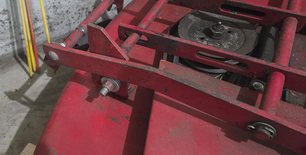

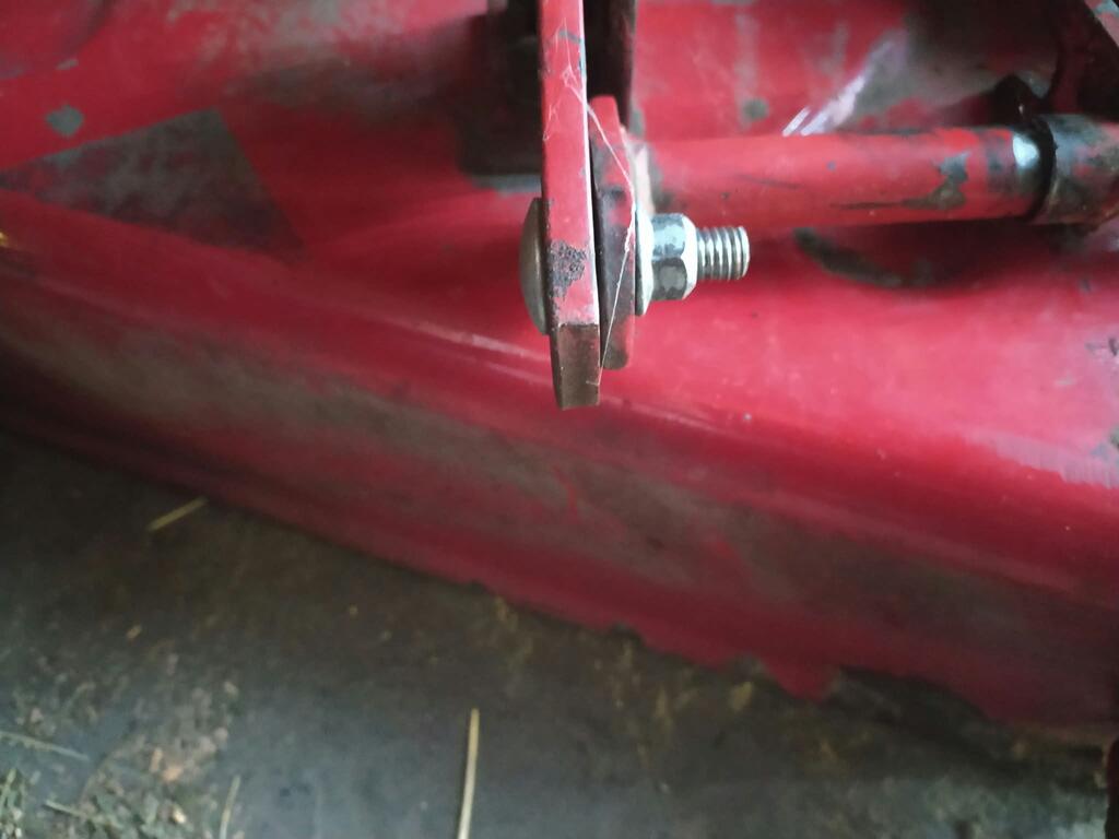

The lift arm on the right side of the tractor looks like it needs a spacer that raises the deck. Is that suppose to be like that??
Bar Nuthin
Should be tightened, but just enough to still allow the front bracket to pivot.
  • Like 1
slk
It would have to be tightened about 3/4” to even come close.
ri702bill
Posted (edited)
Download the manual for the deck - there is a steel bushing as part of that linkage - yours seems to be missing.

I do not even know what deck i have but I was thinking there should be a bushing of sorts in there as well. Are there manuals for the decks here on the site?
ri702bill
Absolutely - all free to download. In the Manuals section. under Implements - Mower Decks and Reels.
A storehouse of knowledge there. There may also be notes of interest on the download page - NLA parts and superceeded P/N's - those kinds of helpful things.
Disassemble one of the other ends of the linkage - check out the bushing...

Ok From what I saw there is a bushing on both sides of that mower deck. One side is bolted with just a washers clearance leaving the side in the pic with a 1” gap. So if I make up 2 bushings that will give me a 1/2” spacing that should equal out the deck alignment pretty good. So allowing the 1/8” thickness of the inside bracket and the 1/2” space I will make some up that are 5/8” long by 5/8” diameter. That should align the deck up pretty good.

No, It's not supposed to be like that.  There are some parts missing.
Should be a shoulder bolt or bolt and bushing.
Find the exploded parts list for your deck model.
If you have any trouble sourcing the parts, I probably have some used ones.

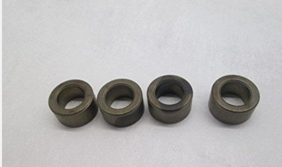

It's missing a 5/8" steel bushing with a 3/8" hole that is approximal 5/16" thick

From my measurements it should be 5/8” diameter with a 3/8” hole. The length according to what I am measuring needs to be 3/4” long. It goes in the one arm that is 1/4” thick and protrudes out 1/2” so those two together makes it 3/4” long total. I do not see any of the arms that are bent so that is how I came up with those detentions unless someone has one they have taken out and measured. I am not saying I am right at all but from what I am measuring that Is what I see.
slk
I do see that the part number is #3 and there are 4 of them. I suppose I could look at the rear ones and see what size they are. I would think all #3 parts would be the same detentions.
Rick3478
#2 is a flange locknut p/n 102809, you could use a locknut and washer.
#3 is a bushing p/n 102704, dimensions about what lee1977 said.
#5 is a carriage bolt p/n 900063, the square shoulders prevent it from turning loose.
Drawing doesn't show all of them, but yes four of each.  Looks like previous owner threw it together with whatever he could find.

Definitely needs a bushing there to allow the bolt to be snugged up and still pivot freely.
Something I do if needed is to increase the diameter of the bushing (usually with stacked washers) on the next bolt back. It allows a bit more lift so the deck rides better in the transport position.

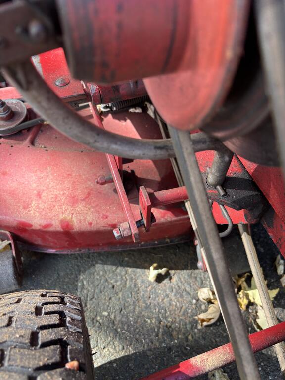

Ok guys I am seeing one issue I need to correct also. Part#1 “Hitch”. I need to be able to move it to the right side about 5/8”.   I also see in the parts diagram a forked piece welded to the hitch angling up. What does that do? I see it goes onto a pin that goes from one side to the other.  I also am seeing a pin of sorts that is spring loaded in front of the hitch. What does that do and how it it moved??I do not see that on the parts diagram for the mower deck.

Rick3478
The mid mount parts will be in the tractor drawings.
Yes the mower hitch fork goes over the mid mount hitch, and keeps the mower hitch oriented vertically.
The spring loaded pin, if you push in from the left side, unblocks the mid mount hitch (handle) to rotate clockwise/forward, which will release the mower hitch.
At this point, if you loosen the mule drive and unhook the belt, then lower the lift handle, the mower hitch will literally fall out of the mid mount and land on the deck shell with a loud CLUNK!
Re-assembly is the reverse.
Rick3478
It's probably possible to fix all that's wrong with it without removing the deck from the tractor, but it might be easier to see how it all works if you do remove it.
