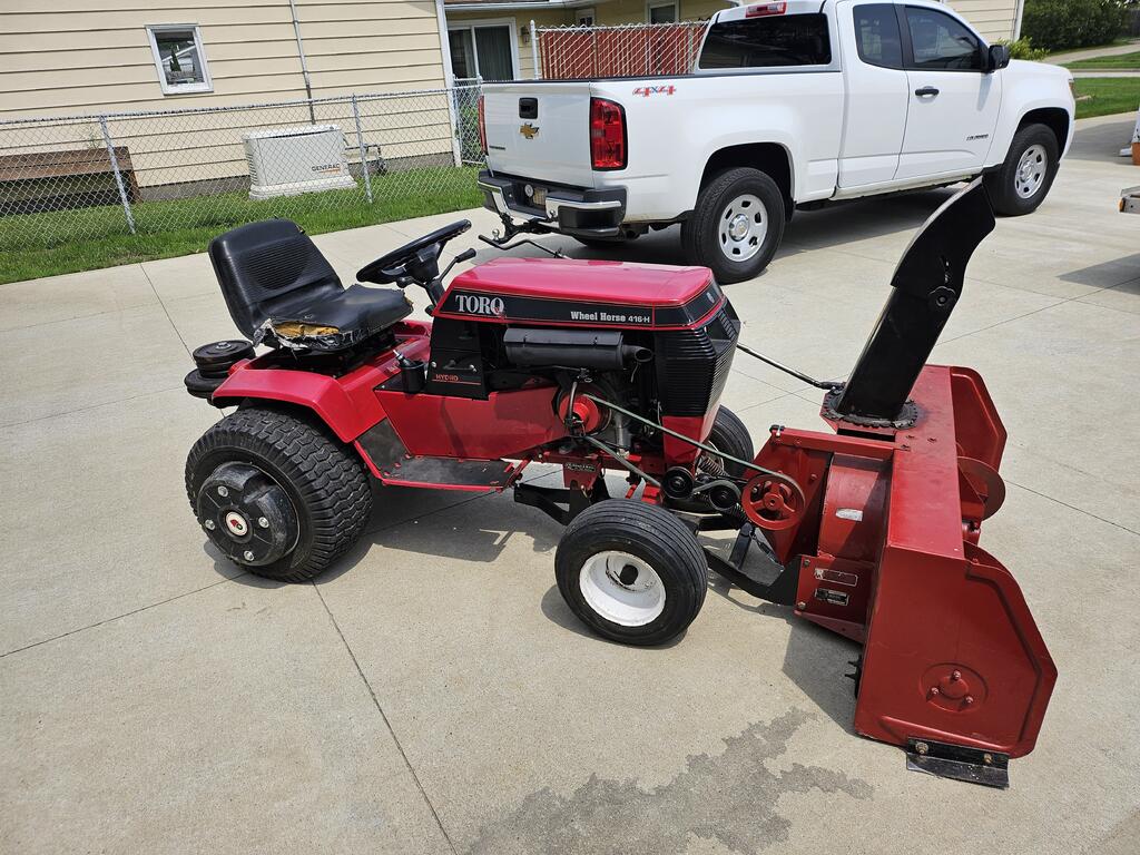

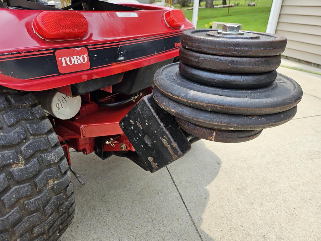

Looking for answers from others with real experience regarding how much counterweight is needed. Ber Vac installed on 416H. So far I have rear WH wheel weights & then another 100lbs on K&B receiver hitch. Put me on seat & thats another 200lbs🙄. Driveway is only 5yr old cement & pretty level with only a slight grade to the street.  I'm not going to use chains. I am considering the rubber chains if needed.

I am not a fan of adding weight on the frame / hitch areas, as that puts more load on the rear axle bearings. IMHO, the best place for the weight in on / in the wheels... AND, you get an added benefit from the liquid sloshing around inside - once it is in motion, it continues to do so - a huge benefit while plowing!
