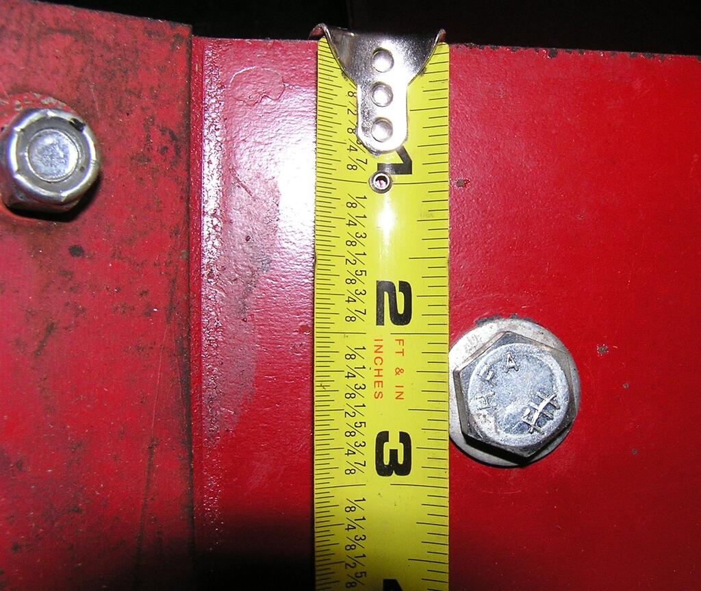

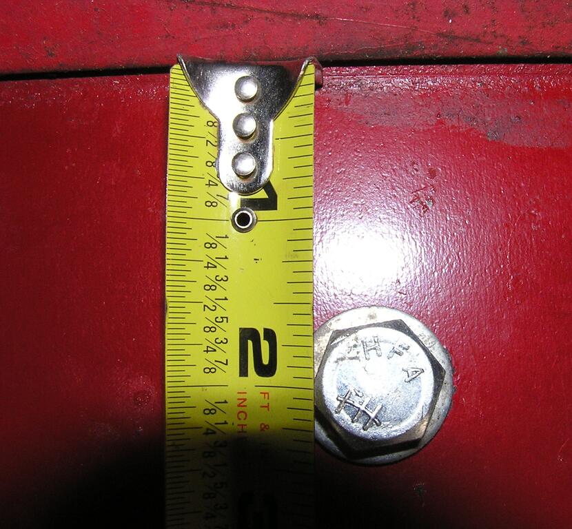

That logic should work... as I recall, the idler I added has the same number of teeth as the lower. It IS positioned directly above it as the run of the chain is parallel to the opening. My snowblower is burried in the back of the garage right now, facing the wrong way. If you can bear with me, I may be able to get your dimension in a day or two... Another larger project is disassembled in front of it now.
