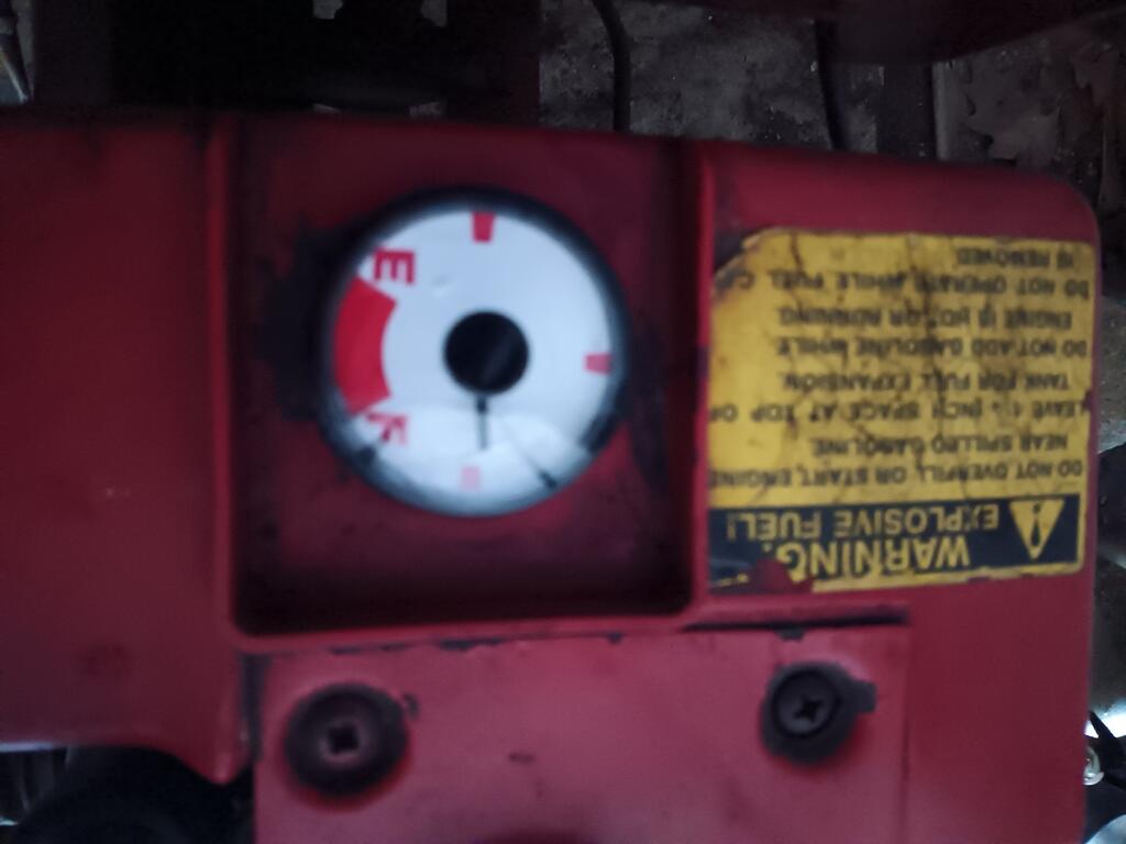

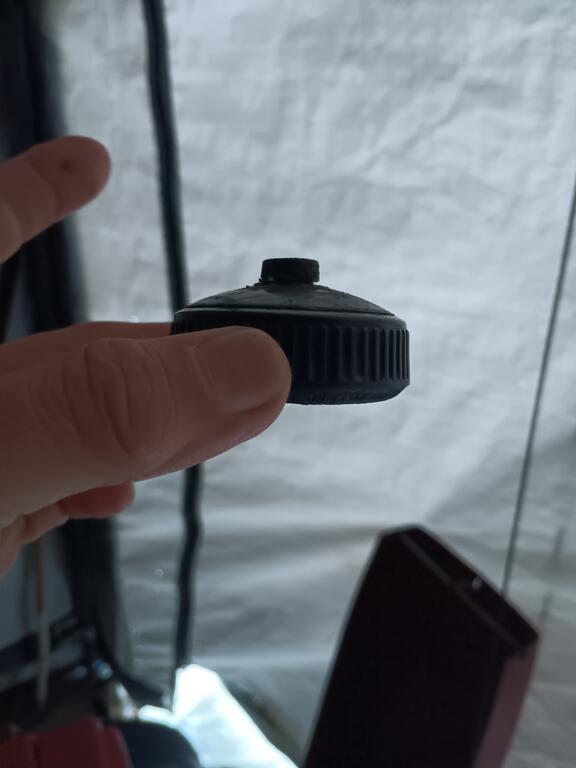

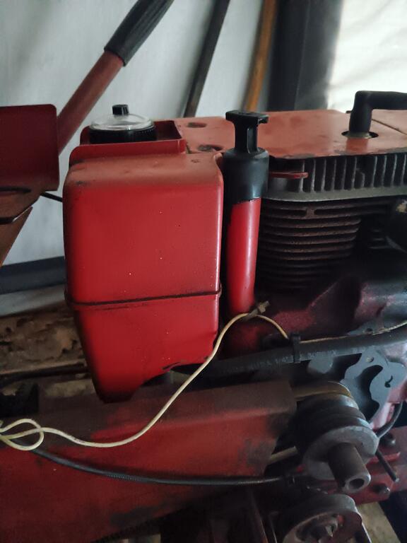

Several years ago I was contacted by a company in Plymouth New Hampshire called Small Engine Barn to help with some needed Wheelhorse parts. A few weeks ago they had a fella named Chris walk in looking for help on a mid 80s Kohler Magnum 8 fuel cap.
The industry standard caps are almost always 1.5 I.D. or 2 inch plus.
There are some variants of the M8 with a 1.7 or 1.75 I.D. AND a shallow 1/2" depth.
Chris was referred to me by the local shop and we texted back n forth a bit while both of us did some internet searches.
I did find a thread here that shows Kohler numbers that are expensive and tough to get.
Chris  came up with an Ariens part number of  03181900.
This cap has a built in guage.
Trina's Sparky tractor has that engine.
I got curious to know if it would fit so I could leave the info here.
Yes.
Now Trina has a working fuel guage.
I believe I'll order another one and try to modify it for use on the metal tank in my 1974 C160-8 Cinnamon Horse. The bottom would need trimming so "E" wouldn't read right but the rest would be correct.

Fuel gage would be nice! Plus accurate since the fuel cell is a “block”. The fuel gage on the under seat fuel tanks is far from accurate with its goofy shape
  • Thanks 1
ebinmaine
Agreed.  The "bottom" of the OE tanks being at varying levels makes for an almost accurate 😛 guage reading below maybe a 1/4 tank.
I'd have a similar issue with the roundish oval shaped tank in Cinnamon Horse if that adaptation goes. But at least I'd have a rough idea.
  • Excellent 1
Sparky
  Even the dashboard fuel gage in my 520-8 isn’t accurate. It’s really just a float still so shouldn’t expect any better accuracy from it.
  • Excellent 1
  • Thanks 1

squonk
I would think the "E" reading accuracy would be more important than any other reading. :confusion-confused:
  • Like 1
  • Haha 1
ebinmaine
Your logic is sound and I agree but I can just remark the gauge once I know how tall it will be. F for full will stay where it is.
