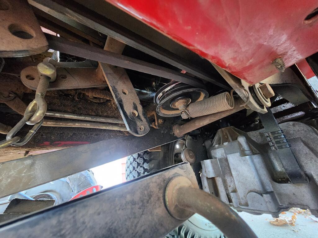

Struggling to properly route the 87 inch drive belt on my 417xt. The old belt broke, so I have no reference to go off of. I removed the PTO belt, the clutch bracket, and idler spring. Anyone that could take a picture of their routing or have any tips would be appreciated

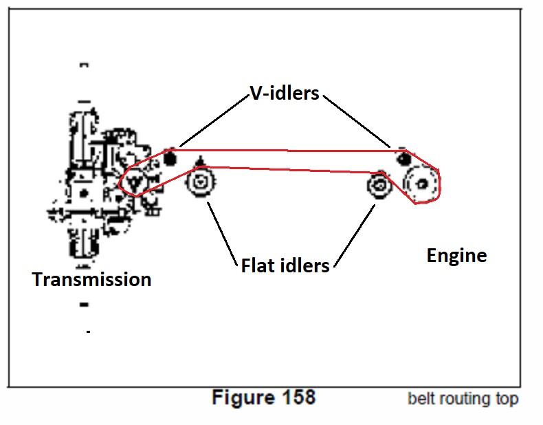

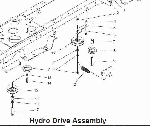

Service manual help?
