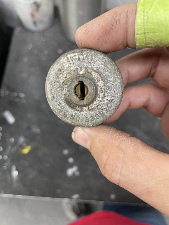

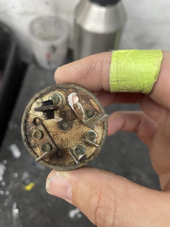

I’m in need of a new key switch for my Raider 10 with Tecumseh with no starting solenoid. Any have a replace ment that worked well for them.. here’s a pic of the old one.

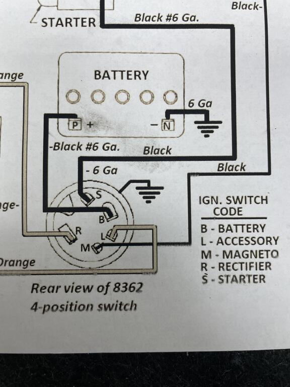

953 nut
1 hour ago, Achto said:
If you were to add a starter relay, then you will be able to use most any key switch that has an M terminal. :twocents-twocents:
:text-yeahthat:

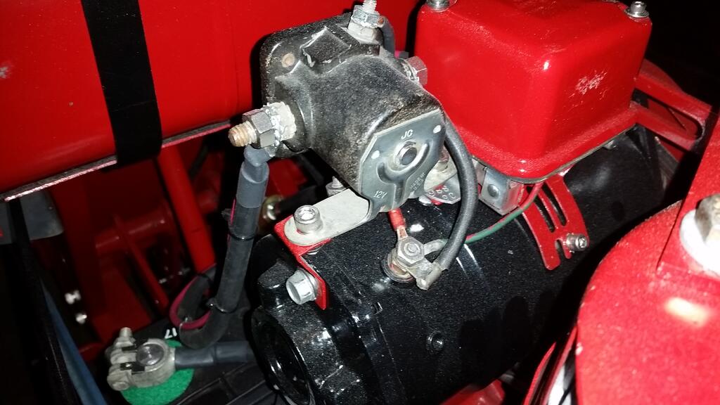

Less expensive, more reliable and gets the high amperage wires out from behind the gas tank. This drawing uses the 103991 ignition switch which can be found at any auto parts store.
  • Excellent 1
WHX??

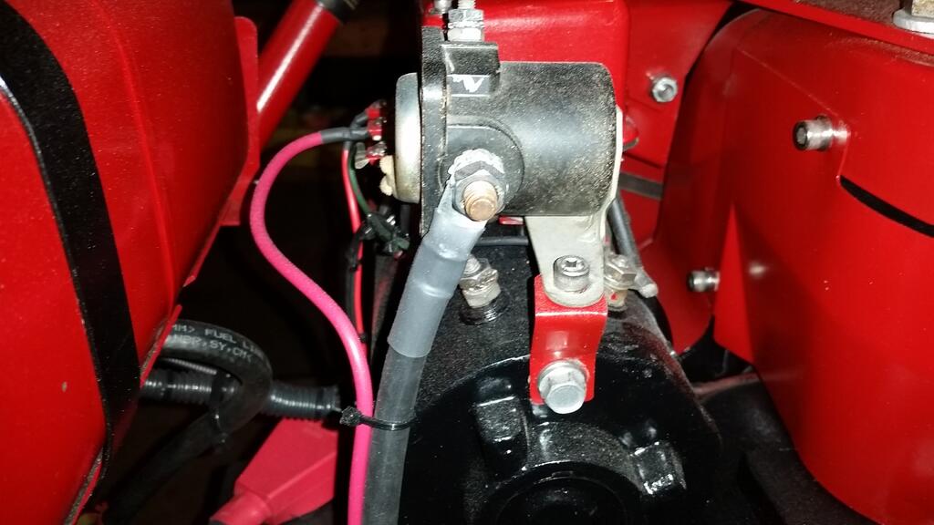

When I restoed a 1067 PO had converted it to solenoid. I was on the fence about going back to original since I am a purist but what the heck it was considered a custom anyway so just cleaned up with new wiring. Good decision since it's a go to tractor.  Can then use the very common $10 four term switch and they last forever.
Edited by WHX??
more pics
  • Excellent 3

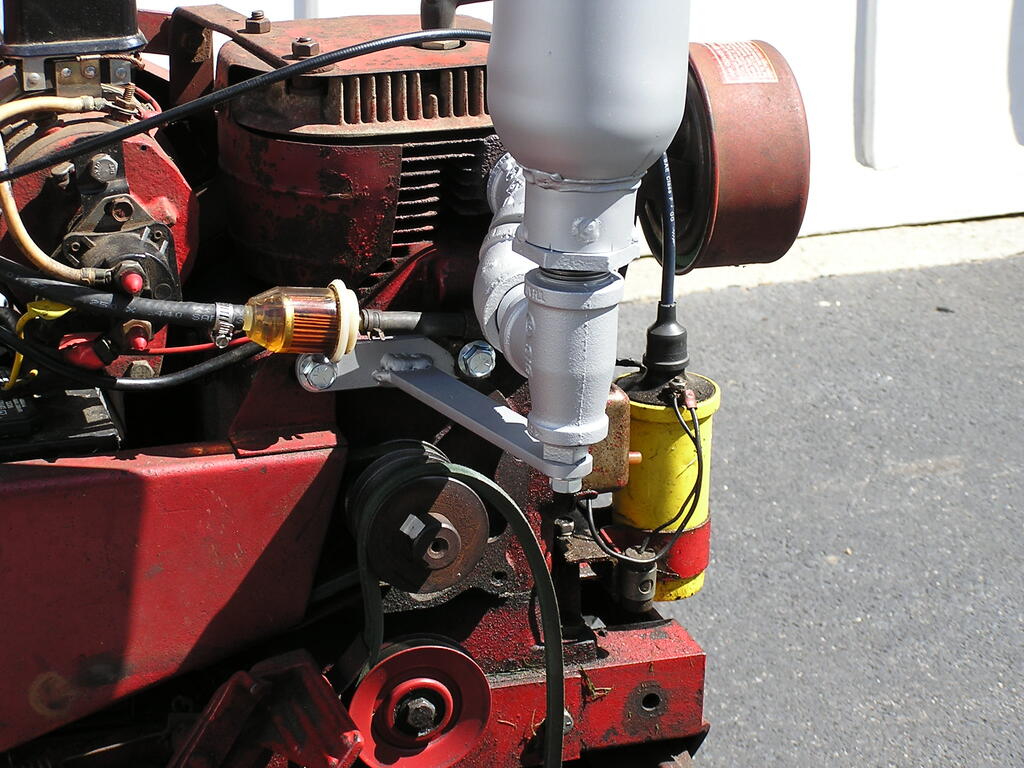

I added mine on the 854 by making up a plate and mounting to the tail of the S/G...
Edited by ri702bill
