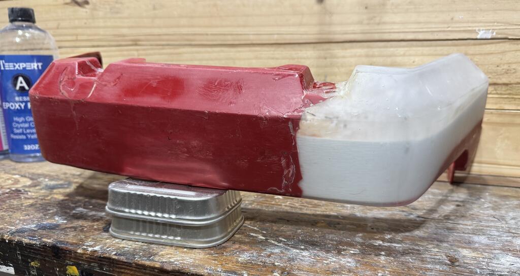

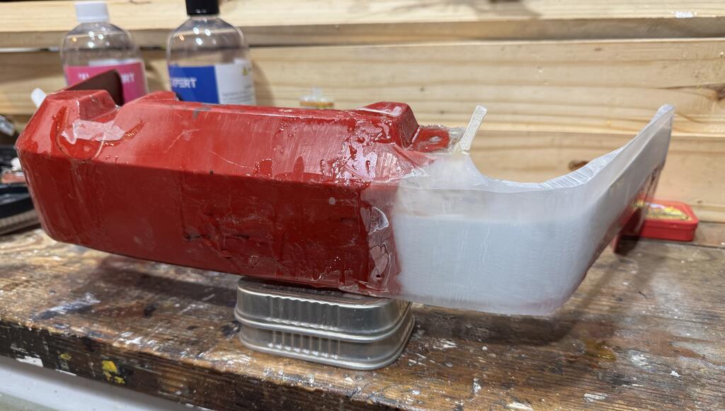

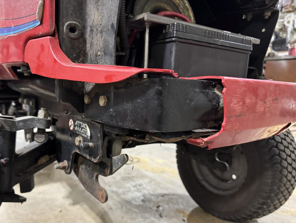

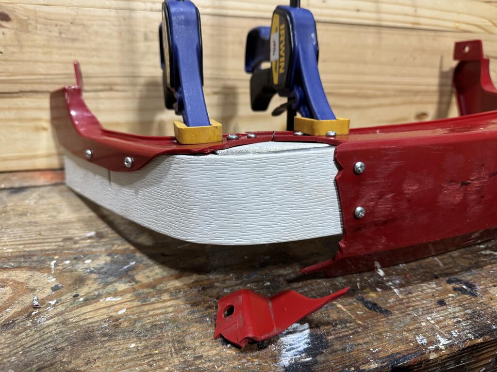

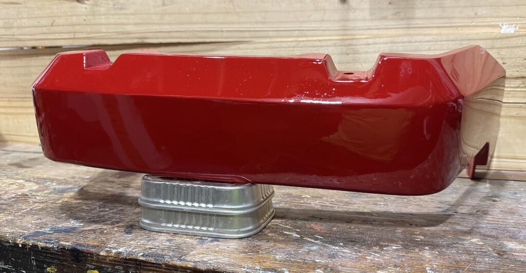

Bugzilla46310 28 #1 Posted 10 hours ago (edited) First I screwed the pieces together on the tractor. Then I used superglue to attach 2 small broken off pieces, then deep pour epoxy to rebuild it one section at a time. Used aluminum duct tape to form each section I poured the epoxy into. Then grinding the back side to get a good fit and glazing / sanding the front. Painted it with Ace International Red. Overall, I’d give it a 8 out of 10, but way better than how it was or no bumper at all. Edited 9 hours ago by Bugzilla46310 More info 3 2 Share this post Link to post Share on other sites
ri702bill 12,937 #2 Posted 48 minutes ago Like fixing a battered Corvette! "Bumper" in name only - do not bump! Share this post Link to post Share on other sites
