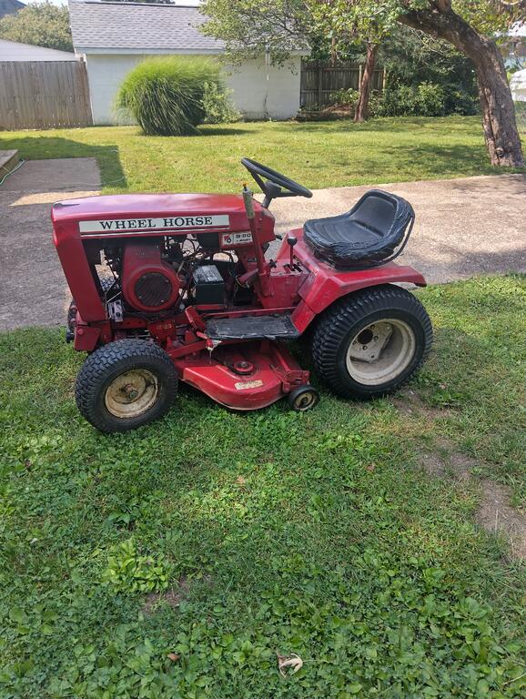

Just purchased this from my neighbor. Always wanted one since I was a kid, and seeing my grandpa with older tractors. Came with a plow, and mower deck. Neighbor said it hadn't ran in 3 years. Changed fuel, oil, and transmission oil, new spark and fired right up. Did just recently clean the carb. Only issue I'm having is, it seems like it's surging. Any ideas? Thank you all. Wanting to tear it apart this winter and restore it.

I just picked up a B-80 myself! Great little tractor!
Did everything you did as well. Had to soak the carb 3 times before it ran. Change entire fuel line, filter, and the fuel shut off / rubber grommet at tank. Clean out the gas tank - a couple times... Replace the whole petcock / grommet etc. Old fuel line will keep feeding the carb a steady stream of gunk...
Also, adjust the governor. Surging went away for me when I did that.

Post the model and spec # for the tractor and engine. Download manuals from this site and look through them. Verify that the governor is adjusted correctly and focus on the fuel system to stop the surging. Other advice will be coming...

Surging is likely a fuel to air ratio problem. I have had success eliminating these problems by using alcohol-free gas https://www.pure-gas.org/ and adding Berrymans B-12 fuel additive at double the recommended rate for a couple of tanks of gas to get the small passages in the carburetor clean.

After cleaning carb,I have found most fuel related problems can be attributed to this. I will add fuel pump is often full of gunk also which will keep filling carb up with junk untill cleaned up/rebuilt.

I've concluded over the last decade that a total cleaning and replacement of the entire fuel system is a necessity on a tractor (or any machine) that's new to us.

I can agree to that Eric. Ever since I started using non-ethanol fuel things have changed for the better. Quicker starts nice smooth running engines. I give it an A+.

@CSB80   since cleaning out my tanks ,and related years ago , new hoses , filters and check valves , and adding  STA BIL ,AN OUNCE OR TWO to every tank top off ,  guess what ? no  fuel hose break down  or related debris , also  have a clear end to  carb  short hose , with a check valve , and filter , ?  so I can see clear standing fuel up to carb ! carb bowls have ZERO  DEBRIS IN THEM , like all my TRIALS , ELIMINATE A REPEDITIVE ISSUE  !   in my own opinion , using this  mind set as applied to other issues , break them down at every stage , enhance / verify  continuation of action . BTW  lubricated , choke and throttle  cables , come to  easy  life with  light spring pull to  close/ stop  point , that way any usage , has pull assist ,  pete
