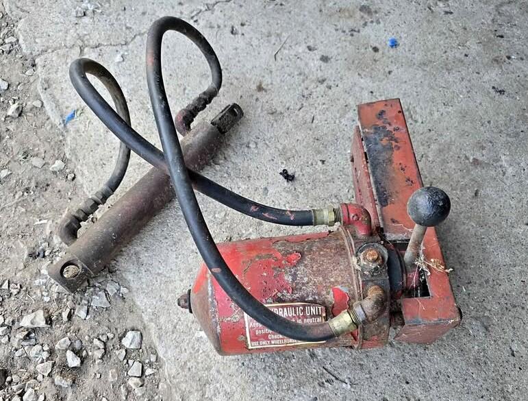

I found a decent deal on a HY-2 setup - but I'm not sure if it is compatible with my 1964 - 754.
If it is, does it require a different rockshaft?

51 minutes ago, 953 nut said:
YES, read the manual.
Okay, so may take a little creative fabrication on my part but certainly looks doable!

Is what you have in the picture all you have of it? I do not see the lift bellcrank weldment. And that part is the difference between a HY-2 and a HY-3... It is the HY-3 setup that you need.
To use the HY-2 setup, you hould need the hoodstand from the earlier 701, 502, 552, or 702.
I also do not see the axle mount for the back pivot end of the cylinder. IF you can find the correct plow bracket for an 854, it has that built in. Ditto for the keyswitch reliocator bracket.

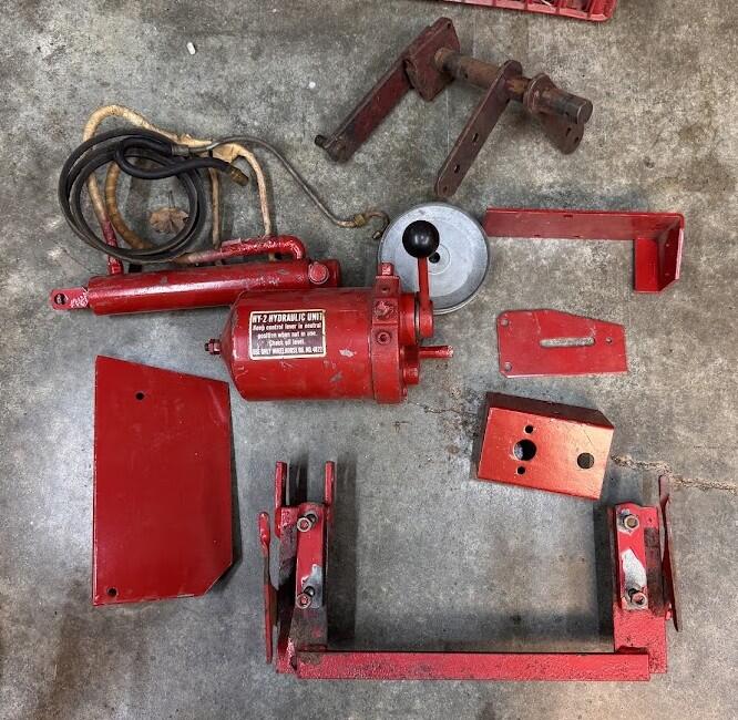

I was able to score a complete HY-2 setup a few years back to be installed on my 502
HY-2

Bar Nuthin
2 minutes ago, ri702bill said:
To use the HY-2 setup, you hould need the hoodstand from the earlier 701 or 702.
Well that certainly changes things.
Teh bellcrank and axle mount I could deal with, but I'm not interested enough to swap out the original tower.

My intention was to mount the HY-2 setup on my 854.... but with the necessary changes required to do so, it was a no-brainer to go with the 502.
Bar Nuthin
Thanks for the great pictures. I purchased the items in my photo pretty cheap, so I can always recoup if I decide to sell.
I'm not sure where the hoodstand comes into play, since the HY-2 and the HY-3 both use the same mounting bracket, WH P/N 4816. The mounting bracket, however, is one of the parts I'm missing.
Worst case scenario for the lift quadrant is I fab one from a manual lift lever (easier to find).
I have the correct snowplow bracket with the tabs for the cylinder.
I believe I can fabricate a box for the ignition switch and ammeter.
Lastly is the pully for the crankshaft (2 1/4" dia.) part number 4811

The manual lift levers are different  - 1961 and 1962 models used a thru shaft that had a square key - a real PITA to remove the assembly after it has had a chance to rust.
The 1963 models introduced the rectangular block on the lever end that was easily removable. Since you do not have the HY-2 bellcrank - looks like you need to fabricate one that fits your hoodstand...

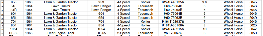

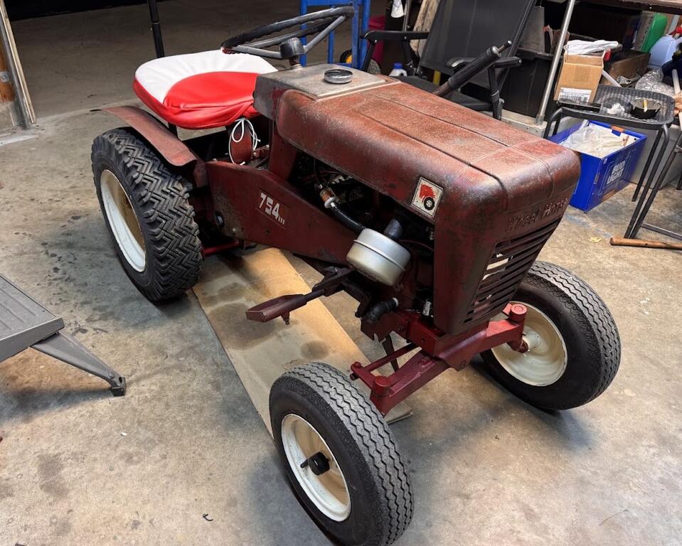

Nuthin wrong with a 754 either. Just don't see them often enough since a 754 is not listed. You sure it's not a 704?
Bar Nuthin
Serial number falls right in with the 421 reported 754 builds. 854 frame, K161 engine. Everything seems to jive.
58cf7c7ae674e_Tractor1964754FlyerSS.jpg.d15e756bafe7ad4248014ac3dcac2c22.jpg.da7d1abe664a35276422a9619f502f66.jpg
