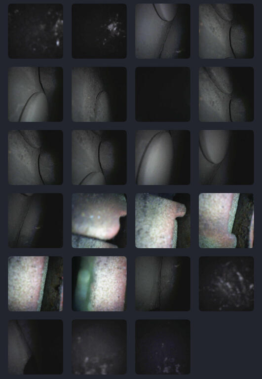

FLtractor 253 #1 Posted September 24 (edited) Evening, Used cheap phone borescope first time ever looking at cylinder … to look into 856 K181 cylinder to see condition.. terrible quality but can someone tell me what I’m looking at? Worth keeping this engine based on these pictures if able to even tell that? Edited September 24 by FLtractor Share this post Link to post Share on other sites
Achto 32,962 #2 Posted September 24 (edited) Really hard to tell through the spark plug hole, mainly because you can't look into the cylinder. A better way to know is to take the head off. This allows you to inspect and measure the cylinder bore. 45 minutes ago, FLtractor said: Worth keeping this engine I have not encountered too many K model Kohlers that were not worth rebuilding yet. Engine not worth rebuilding - 1 - There is a window (hole) in the side of the block where insides exited. 2 - The bore is more than .030 over sized already. 3 - Water intrusion has rusted the insides beyond repair. Get the bore and crank pin measured before ordering any parts so you know what you will need. One source for parts https://www.ebay.com/itm/143366218290 You will most likely pay about the same amount for machining as you do for the parts listed above. The Kohler manual does a great job of walking you through the rebuild process from start to finish. https://resources.kohler.com/power/kohler/enginesUS/pdf/tp_2379.pdf Edited September 24 by Achto 5 1 Share this post Link to post Share on other sites
FLtractor 253 #3 Posted September 24 1 minute ago, Achto said: Really hard to tell through the spark plug hole, mainly because you can't look into the cylinder. A better way to know is to take the head off. This allows you to inspect and measure the cylinder bore. I have not encountered too many K model Kohlers that were not worth rebuilding yet. Engine not worth rebuilding - 1 - There is a window (hole) in the side of the block where insides exited. 2 - The bore is more than .030 over sized already. 3 - Water intrusion has rusted the insides beyond repair. Get the bore and crank pin measured before ordering any parts so you know what you will need. One source for parts https://www.ebay.com/itm/143366218290 You will most likely pay about the same amount for machining as you do for the parts listed above. Oh I read online that the cylinder can be looked at with borescope through spark plug hole … so then what am I lookin at.. the combustion chamber? Was hoping didn’t have to take Head off engine. Gonna have to research how to do so as never done on any engine 1 Share this post Link to post Share on other sites
Achto 32,962 #4 Posted September 24 (edited) 11 minutes ago, FLtractor said: Gonna have to research how to do so as never done on any engine I added the Kohler manual to my post above. This manual has great step by step instructions for disassembly and assembly. 11 minutes ago, FLtractor said: Oh I read online that the cylinder can be looked at with borescope through spark plug hole When you look through the pug hole on a flat head engine, you are looking at or between the valves, you can not turn the camera enough to see down the bore. Look at the pic below, the plug hole is over the two smaller holes for the valves. Under side of the head. Edited September 24 by Achto 8 1 Share this post Link to post Share on other sites
FLtractor 253 #5 Posted September 24 16 hours ago, Achto said: I added the Kohler manual to my post above. This manual has great step by step instructions for disassembly and assembly. When you look through the pug hole on a flat head engine, you are looking at or between the valves, you can not turn the camera enough to see down the bore. Look at the pic below, the plug hole is over the two smaller holes for the valves. Under side of the head. Oh ok that really helps understand what I was looking at in comparison to the cylinder.. thank you 1 Share this post Link to post Share on other sites
adsm08 5,247 #6 Posted September 25 On 9/23/2026 at 8:56 PM, FLtractor said: Oh I read online that the cylinder can be looked at with borescope through spark plug hole This is true of AUTOMOTIVE engines. I usually do it a few times a month at work. It doesn't really work on single-cylinder engines. Somewhat relevant to this discussion, but also just a cool video in general: 1 Share this post Link to post Share on other sites
