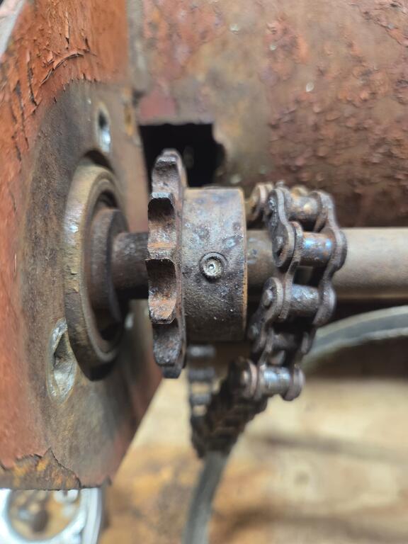

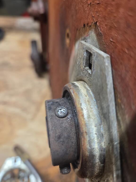

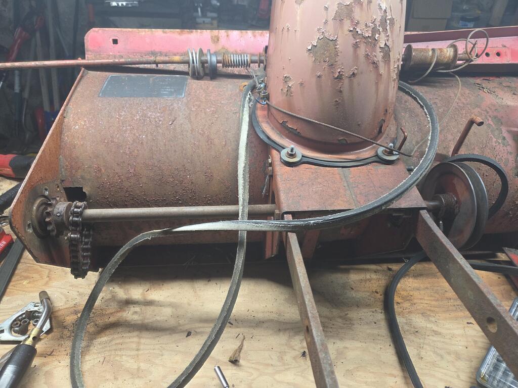

Fighthouse 1 #1 Posted September 23 Hey All, it's been a number of years since I was last here. I still have a 312-8 that was left to me, and have used it for a number of projects over the years. Most recently I picked up a 42ST02 snowblower to help with snow removal off of facebook marketplace. It had obviously sat outside for a long time, but the auger spun and I was looking forward to fully rehabing it. I started to take it apart slowly last week, and came up against an early roadblock. The set screws on the collars and pulleys on the back end of the attachment seemed pretty stuck. I treated them with PB blaster multiple times over the course of a few days, and then set into them with some heat and tried to work them out. There are a total of 8 set screws for 4 items, and I have only been successful at working 3 of them out so far. The big issue that I have that I caused for myself is that I have broke two allen/torx bits off inside of two of the screws trying to work them out. I'm trying to see if there is any advice on how to get these out that I haven't thought of. Drilling the bits out didn't work because the allen bits are harder than my drill bits. I know some people weld a nut or something on top of them, but welding is one of the things I have never gotten into or bought for my shop. Share this post Link to post Share on other sites

Fighthouse 1 #4 Posted September 23 1 hour ago, ri702bill said: The collars are short money to replace - why not carefully cut a slot thru it (them) parallel to the shaft? that allows you to spread it (them). Heat may help loosen the fasteners too.... Also, using a left handed twist drill can sometimes free them up once the penetrating oil has done its job.... Where in RI are you? Bill I used to live in Foster, but moved right over the border not too far away in CT. How would I cut the collars without damaging the areas around it? An angle grinder wouldn't have enough clearance to cleanly cut most of them. A dremel might do it, but I'd probably go through a lot of cutoff wheels. Share this post Link to post Share on other sites
ri702bill 13,389 #5 Posted September 23 A reciprocating saw (Sawzall) with a new 18TPI metal blade. Variable speed control is a must. Wrap the underside of the blade once or twice with Gorilla tape to space the blade up off the shaft. Slow controlled guidance of the saw.... in an area that does not have the setscrew. Share this post Link to post Share on other sites
Fighthouse 1 #6 Posted September 28 If I am able to cut the collar in the closeup pick I provided, I think I can get the shaft out and potentially be successful at getting the pulley on the other end off. But since the collar is almost flush with the sidewall, there isn't any space for the reciprocating saw to reciprocate! I could potentially angle the sawblade so it isn't perpendicular to the collar, but I'm not sure that would give me enough room either. Share this post Link to post Share on other sites
Fighthouse 1 #7 Posted September 29 Great, seems like the collar might be hardened steel - my sawzall with a metal blade is barely touching it. Cutting the rod and replacing most of the parts on it seems like a reality I might need to accept at this point. Share this post Link to post Share on other sites
