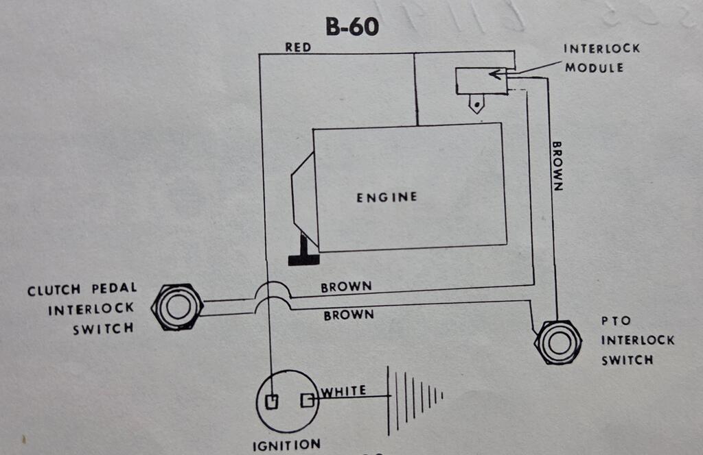

Hi I am looking for info on b-60 interlocking system. If anybody has this model with experience do you really need those interlocking switches? I’ve had this for a couple months, but I never really took a look at it to see if the switches are actually there. It’s pretty dirty so I clean this over the winter time.There is no engine on it know. The tranny has blown out seals. So that will be first. then disassemble the rest. Hang frame a clean every inch. That way I can see what is there.  I found a switch for it but no key. Thanks for any help.

You didn't mention what year but they are likely the same. It couldn't get much more basic other than an older model with nothing. Here's the wiring for a 76 B.
