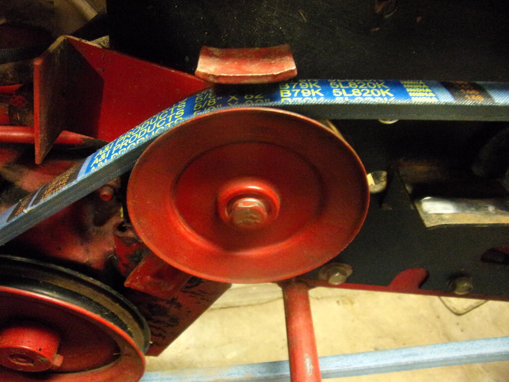

ri702bill 13,303 #3 Posted September 21 (edited) Does it go cleanly into all the gears with the engine off? If so, your problem most likely stems from the drive belt not being stopped with the clutch pedal fully depressed. Easy enough to see (at least on a C series) - while off the tractor, start it in neutral, depressing the clutch fully by hand. Look across the battery area to find the drive belt - it should be stopped. If not, try adjusting the pedal back towards you for more throw. The belt guard MUST be installed, and correctly, for proper belt control. Most guards have tabs inside to aid in stopping the belt.... Edited September 21 by ri702bill 1 4 Share this post Link to post Share on other sites

squonk 48,314 #6 Posted September 21 (edited) 2 hours ago, cafoose said: My 953 has the same problem. It almost always wants to grind gears when trying to go into gear from neutral. I never shift while in motion. It goes into gear cleanly with the engine off. If you have it in gear and go to shift, The brake usually stops all of the shafts so you can shift cleanly. Say Reverse to 2nd. If it's in neutral or you pause in neutral during your shift, the trans shafts "disengage" and the input shaft is free to turn with the belt. I have a similar issue with my Power King. They are notorious for grinding gears from neutral. I partially solved it by using heavier grease in the trans to slow the free wheeling shafts down. Edited September 21 by squonk 1 Share this post Link to post Share on other sites
953 nut 70,262 #7 Posted September 22 19 hours ago, cafoose said: My 953 has the same problem. It almost always wants to grind gears when trying to go into gear from neutral. I never shift while in motion. It goes into gear cleanly with the engine off. I've gone to a 1/2 X 83 belt on the 953 which eliminated the problem. Share this post Link to post Share on other sites
