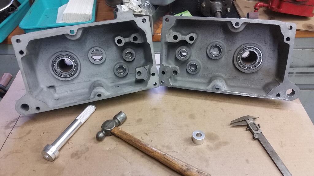

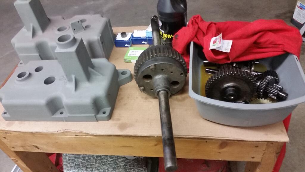

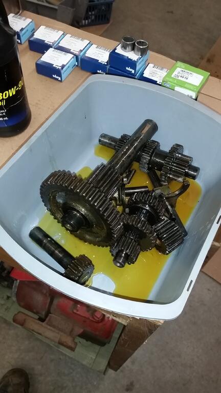

Mike and I have rebuilt 2 maybe a couple of years ago.  And they can get pricey, depending on what they need. Well worth it though, cause it will last longer than you :teasing-poke:
It's really not as difficult as you might think. The worse part is the cleaning.

WHX??
12 hours ago, ineedanother said:
That'll buff out :lol:
Not too far from the truth ... was picking rust boogers for a week tho ..  :lol:
