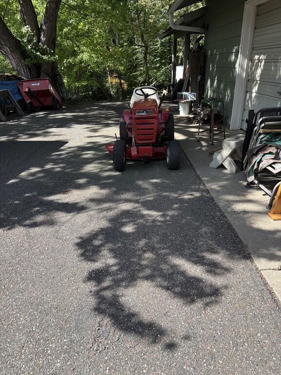

953 nut 68,661 #26 Posted 5 hours ago 7 hours ago, slk said: Wow would have never guessed that. I tried to loosen it with a pair of gloves on and it would not budge. It is so buggered up it would cut you if not wearing gloves. Turning the mule drive belt tightening in a clockwise direction will loosen the belt. The only time I have had steering that far out of line it was caused by a driver backing over the front wheel with a 4000 pound SUV but we are still married. Replacement spindles are rather easy to come by since most are interchangeable over a wide range of years and models. from the '70s to '90s. 1 1 Share this post Link to post Share on other sites
