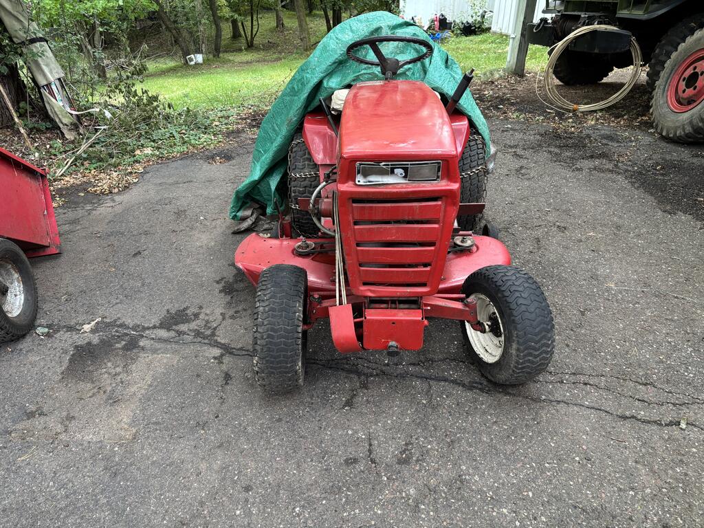

slk 38 #1 Posted September 17 I have just acquired this wheel horse C120 8 speed. I noticed that the front wheels do not sit straight ahead. You can get one straight then the other one is at least 4” turned out. I do not see any adjustment that can be made to correct that unless I am missing something. Share this post Link to post Share on other sites

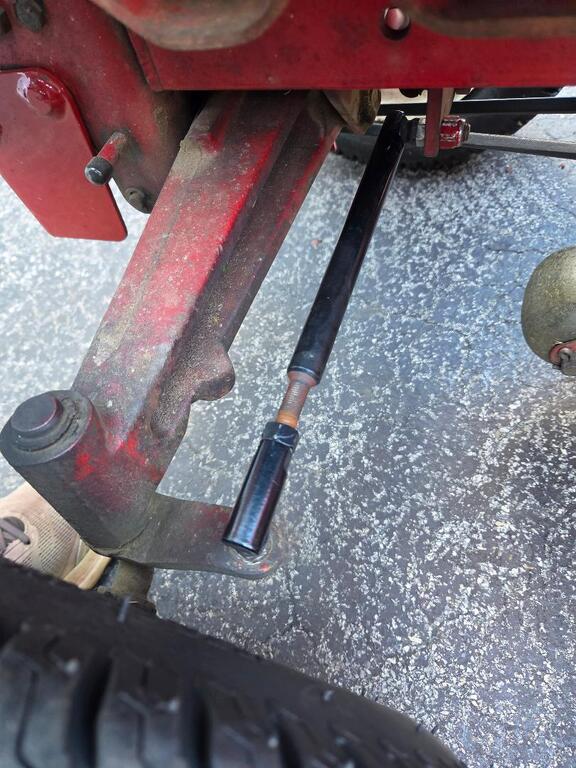

ri702bill 13,389 #3 Posted September 17 A couple of pictures would help. A bent spindle will severely change the toe-in of the front axle. Also, excessive wear in the front axle bosses & similar wear on the spindles will drastically change the toe-in. Jack the tractor up under the front of the frame to allow the axle to hang free with both wheels off the ground. Try to shake each wheel to check for play. Up and down play in the spindles, not the wheels, is to be expected. Bad wheel bearing(s) have the same bad effect on the toe-in. It may be a combination of little things that add up..... A worn out center pivot will throw the steering off, but not so much the toe-in as the others mentioned. 1 Share this post Link to post Share on other sites
slk 38 #4 Posted September 17 (edited) If ya get one wheel pointed straight the other one will point outward. It is crazy. The sight will not let me post another pic of the other wheel. Says i can only post 15.57 meg. But if ya put the left wheel straight the right will be pointed outward just as much. Edited September 17 by slk added info Share this post Link to post Share on other sites

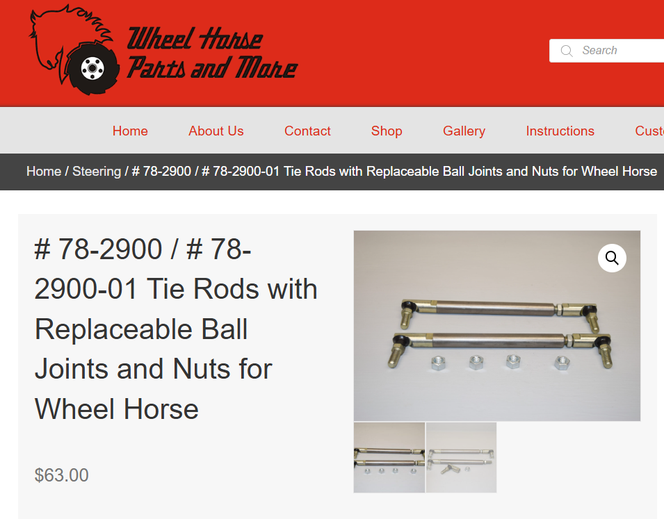

Brockport Bill 2,553 #6 Posted September 17 what about adjustable tie rod - or am i mis-understanding the problem? 1 Share this post Link to post Share on other sites
ri702bill 13,389 #7 Posted September 17 A bent or loose steering arm needs to be fixed / replaced before throwing good money at it buying adjustable tierods with replacable joints. Note the relative placement of the rh and lh outer tierod joints - they look about the same - yet the lhe slindle IS damaged. Note the damage to the upper hood - looks like a vehicle backed into it - a coincidence that the spindle took a beating too???? Methinks a LOT more is bent / busted / broken here than meets the eye. 2 1 Share this post Link to post Share on other sites
slk 38 #8 Posted September 17 I have not taken anything apart yet. When I do I may see the problem but was hoping there was some sort of adjustment. 1 Share this post Link to post Share on other sites
lynnmor 9,081 #9 Posted September 17 1 hour ago, slk said: If ya get one wheel pointed straight the other one will point outward. It is crazy. The sight will not let me post another pic of the other wheel. Says i can only post 15.57 meg. But if ya put the left wheel straight the right will be pointed outward just as much. If you become a supporter the restriction on posting goes away. Join here. That wrecked front end is way more than an adjustment, it should be obvious as you inspect the parts. 2 2 Share this post Link to post Share on other sites
wallfish 20,744 #10 Posted September 17 Something is broken or someone put on the wrong tie rod(s) 4 Share this post Link to post Share on other sites
Ed Kennell 47,937 #11 Posted September 18 (edited) I'm guessing here but did the previous owner buy new tie rods that were too short. to the Edited September 18 by Ed Kennell 4 Share this post Link to post Share on other sites

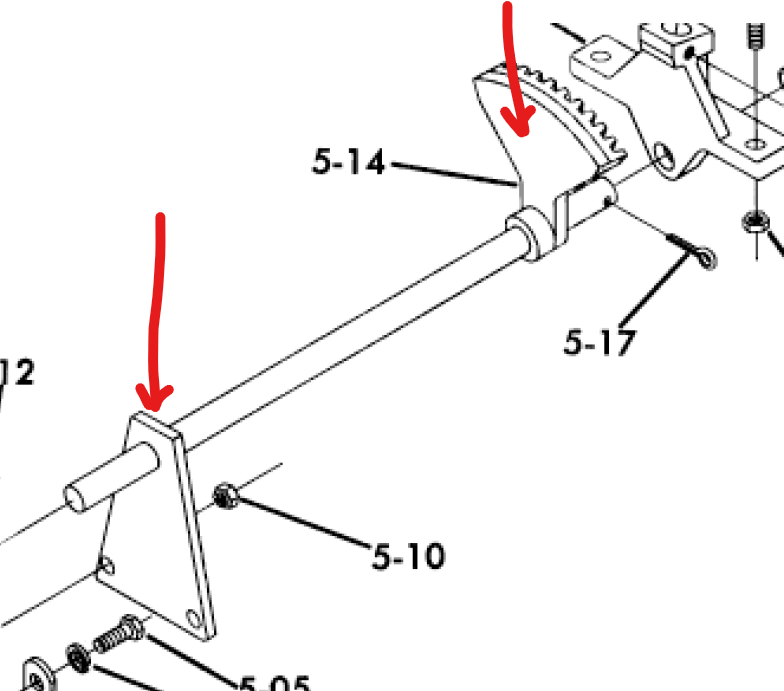

Bar Nuthin 3,639 #14 Posted September 18 Move the steering wheel until these two parts are vertical, then take a look at the front end. It may provide clues as to where the problem is. 1 1 Share this post Link to post Share on other sites

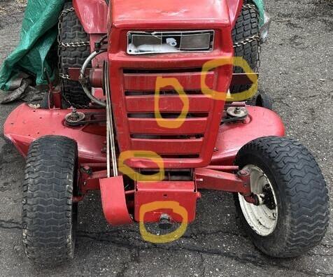

ineedanother 2,885 #15 Posted September 18 3 hours ago, ri702bill said: A bent or loose steering arm needs to be fixed / replaced before throwing good money at it buying adjustable tierods with replacable joints. Note the relative placement of the rh and lh outer tierod joints - they look about the same - yet the lhe slindle IS damaged. Note the damage to the upper hood - looks like a vehicle backed into it - a coincidence that the spindle took a beating too???? Methinks a LOT more is bent / busted / broken here than meets the eye. I agree with @ri702bill about it being backed into or something similar. I think the mule drive has been injured as well... 1 Share this post Link to post Share on other sites
slk 38 #16 Posted September 18 There is not any dents in the hood at all in the front. What you see are the lights that are bowed from someone not knowing how to put them back in. Share this post Link to post Share on other sites

lynnmor 9,081 #18 Posted September 18 9 hours ago, slk said: There is not any dents in the hood at all in the front. What you see are the lights that are bowed from someone not knowing how to put them back in. Just some minor causalities. 1 Share this post Link to post Share on other sites
