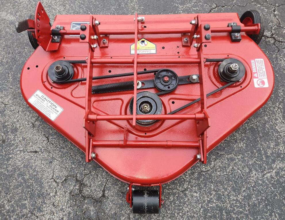

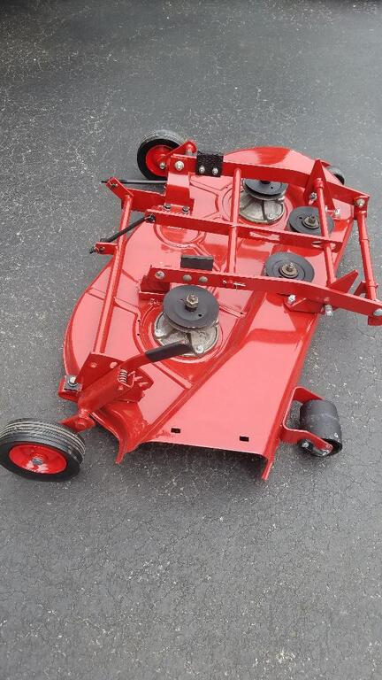

5151 18 #1 Posted September 16 Deck roller needed. Not finding one like was on there. It is 4+" high and my other tractor (and replacements) has 3" high. Both 1/2". No part number, no deck number. Tractor is 310-8. Deck is 37" OUTSIDE, 3 spindle, only 1 roller it's in front, 2 wheels in rear. And is pretty beat but has new paint lol. Got a part # ? Is it supposed to be 4"? Share this post Link to post Share on other sites
Rick3478 478 #2 Posted September 16 Those are usually called 36" decks (the cutting width). All of them I have seen had a 3" roller on the front. It may have been a user improvement. On my 3-blade decks, I've gotten in the habit of putting cheap 6" ball bearing mower wheels on a long 1/2 inch bolt. Rolls over tree roots and such better than the little rollers, and I don't cut real short anyway. 1 Share this post Link to post Share on other sites
5151 18 #3 Posted September 16 Thanks. User improvement or that's what he had maybe. This deck did get hit hard or repeatedly in that area. I have another deck from smaller briggs tractor but that is another time. I'll finish this one first. 3" it will be then. Fixing the fixes is ok with me. Share this post Link to post Share on other sites

Brockport Bill 2,553 #7 Posted September 17 the 36 deck is rear discharge with spindles below the deck - the 37 deck is side discharge with spindles above the deck - either deck could be on a 310 tractor? If i understand your post -- you need a front roller -- the part numbers should be on partstree.com site, or toro parts online - unless when you say roller you mean the rear axle wheels -- they are commonly found online many sources including vendors listed here on R.Sq. - As you can see from photos i attached ------ the front rollers and rear axle tires are shown for the 37 side discharge or the 36 rear discharge Share this post Link to post Share on other sites
5151 18 #8 Posted September 18 Thanks Bill. I have both those decks. The one I was working on is in your second or lower picture. It had a 4" high roller on the front. That roller is junk. I could not find a 4" high roller and posted such here. It now has a 3" high roller on the front thanks to these guys. I really appreciate those pictures and your response that both decks will fit. I suspected such. Next shift, (later today) I will compare my decks to your pictures and report back. Maybe with more questions. Thanks Rick, Peter, Bill, and R SQ. 1 Share this post Link to post Share on other sites
5151 18 #9 Posted September 18 I dragged out my extra deck. The number is g5378 or 05378 or gone. Share this post Link to post Share on other sites
