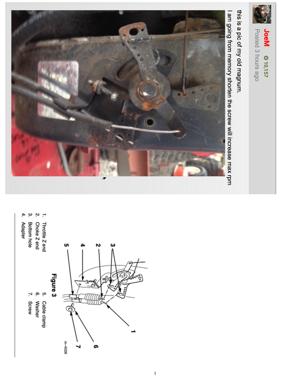

JoeM 10,318 #3 Posted September 12 this is a pic of my old magnum. I am going from memory shorten the screw will increase max rpm Share this post Link to post Share on other sites
bradleydavidgood 46 #4 Posted September 12 Thank you both for those. I put them next to each other and there are several things different but I think one is the same. And I see that my screw is not upside down, but I don't see how that screw contacts anything. I'm going to take a picture of mine today and put all three next to each other. I'm also going to set up 3 cameras and do a video showing the linkage moving while running and moving the throttle. Share this post Link to post Share on other sites
702854boy 1,245 #5 Posted September 12 20 minutes ago, bradleydavidgood said: . And I see that my screw is not upside down, but I don't see how that screw contacts anything. It looks like there is a little bent out tab at the bottom of the throttle pivot that would hit against the screw to prevent over revving the engine 1 Share this post Link to post Share on other sites

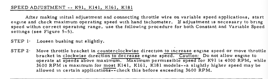

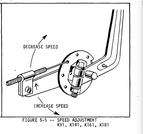

bradleydavidgood 46 #8 Posted September 12 (edited) Thank you for the other manual. While it is not the same engine or linkage, it is helpful. See below screenshots. It also has wording confirming the ability to increase engine speed by adjusting, which is my question. And I will try the adjustment method below. However, I'm first more interested in the linkage on the front right side of the motor, where the high speed adjustment screw is as in post #4. I think my linkage is different than both in that post. I don't think we have established the correct initial linkage setup for that front right side and I'd like to do that. Thanks! Edited September 12 by bradleydavidgood Share this post Link to post Share on other sites

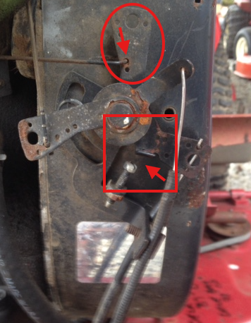

JoeM 10,318 #10 Posted September 12 Need to make sure the tab contacts the head of the screw when throttle is in max position. Also, need to move the governor spring to the hole circled. Share this post Link to post Share on other sites

JoeM 10,318 #12 Posted September 12 4 hours ago, gwest_ca said: To increase engine speed adjust the throttle cable casing by pulling it away from it's mounting point on the engine and retighten. And have the throttle lever in the high setting, the tab should contact the screw head. Your governor spring is defiantly in the wrong hole and will not react well under a load. It will way to stiff if left in the existing postion. Share this post Link to post Share on other sites
bradleydavidgood 46 #13 Posted September 12 (edited) Thank you guys! Two videos of what I did this morning. First, moved the linkage per JoeM. Thank you JoeM! But after moving it, the governor still pushed it back to the idle stop when the throttle lever at the dash was fast. Edited September 12 by bradleydavidgood Share this post Link to post Share on other sites
bradleydavidgood 46 #14 Posted September 12 So then I went back to the governor shaft and readjusted that and that allowed the engine to run at higher RPMs. What do you think of this level of RPMs? Tomorrow I get a tachometer so I'll be able to better set the high to 3600. 1 Share this post Link to post Share on other sites
