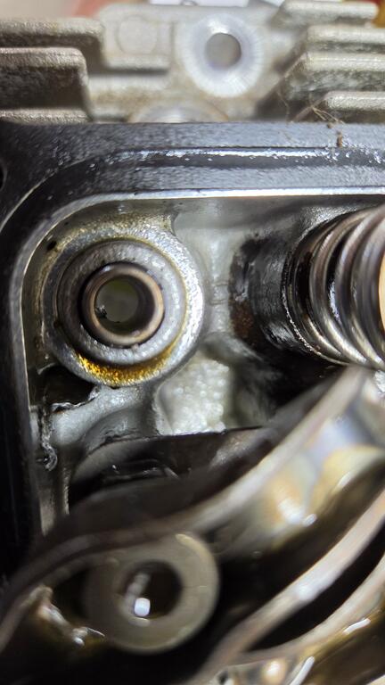

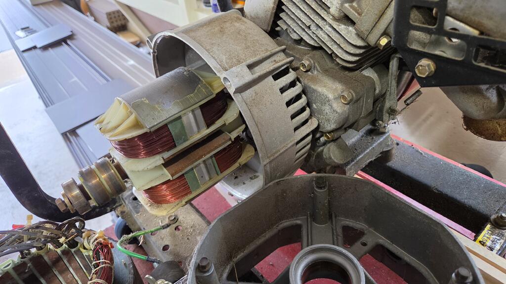

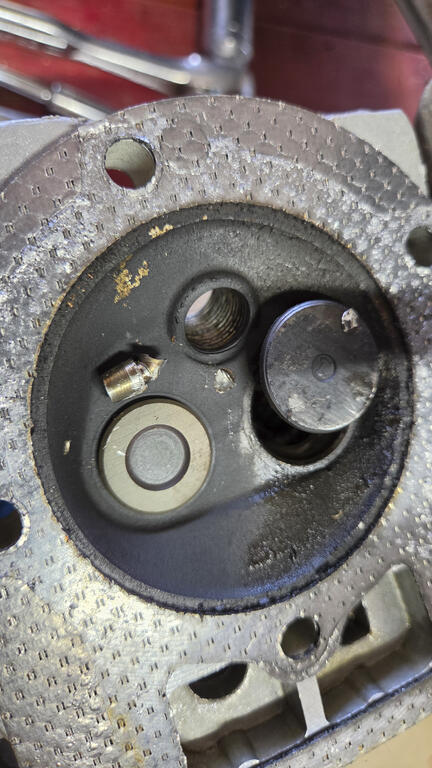

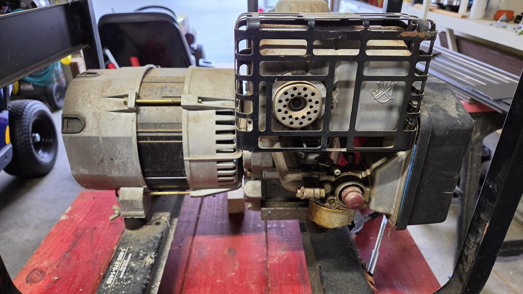

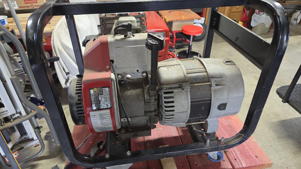

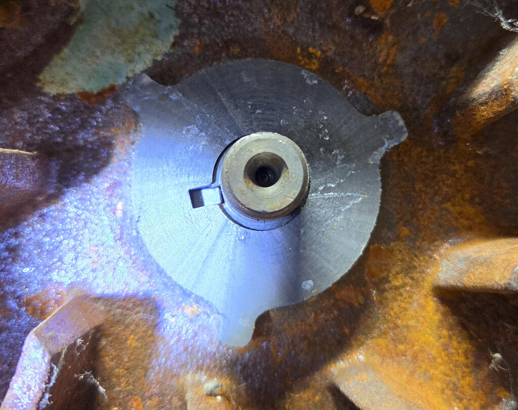

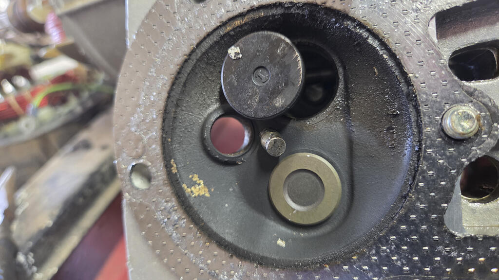

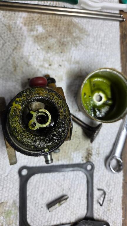

Racinbob 13,095 #1 Posted 45 minutes ago (edited) I don't need the generator and I certainly don't need another project but the price was certainly right, free. It's dirty from sitting but clearly there's not many hours on it. It was locked up tight and I couldn't be sure if it was the engine or generator head so I opened things up. Once I got this far I found that it would rotate just shy of one turn before stopping solidly. It was definitely in the engine. I kept going and found this. Apparently the spring retainer left home and the valve dropped into the cylinder. It completely punctured the head and was jammed tight. The head is toast. The piston wasn't hurt and I think the pushrods are fine but I'll check them better today. I first assumed that a new head would end this project and I'd just salvage the power head but I found a used head complete with the valves, springs and rockers for 40 some bucks so now I'm pondering. It's not worth putting a lot into it, especially for me since I don't need it, but I would a reasonable amount. I figure I'll scrounge up a service manual. I didn't see one here for the overhead valve models What would you guys do? This unit will clean up to near new condition and could be a nice little generator. Edited 44 minutes ago by Racinbob Share this post Link to post Share on other sites
