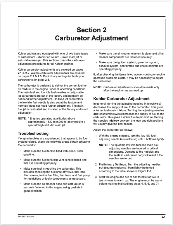

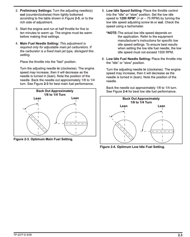

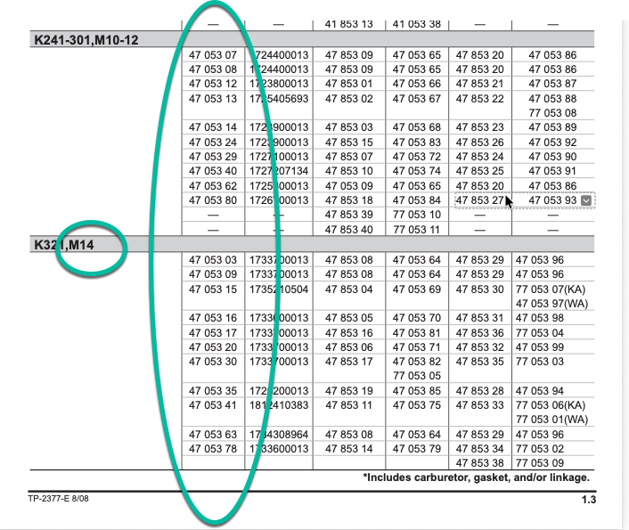

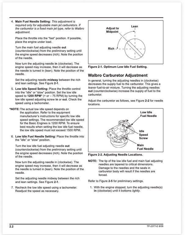

On another note, the Kohler service manual (found on this site) I was looking at before for initial carb settings seems to be a Kohler made carb and looks different than my Walbro carb.
I found this other carb manual that is for Walbro carbs with the same prefixes as mine of 47 053 XX.
Mine is 47 053 95 and not listed in the manual but many others with 47 053 are listed and the drawings look exactly the same as mine.
So I'm going to use this manual.

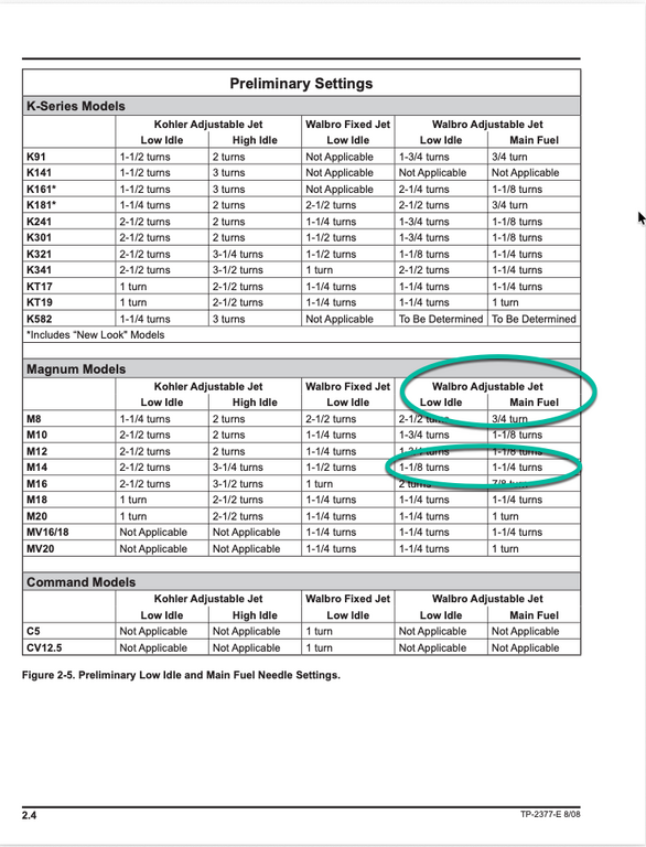

I think I have a Walbro adjustable-main-jet carburetor.
Because:
  • An adjustable Walbro has three external adjustments:
    1. Idle-speed screw
    2. Low-idle fuel needle
    3. Main/high-speed fuel needle
  • The main-fuel needle has a tapered tip and spring and can be gently turned clockwise until it seats.
  • A fixed-jet Walbro has no external main-fuel needle—only the idle-mixture needle and idle-speed screw. Its main jet is a calibrated, nonadjustable jet inside the carburetor.
bradleydavidgood
My Main Fuel was set to 3/4 turns.  Spec above is 1-1/8 turns.
My Low Idle was set to 1 5/8 turns.  Spec above is 1 1/8 turns.
Keep in mind that these are for stock carbs and are “get it going” settings.
Once running and following the guidance for adjusting, you might see up to ¼ turn difference.
When buying used all bets are off.  Someone may have been compensating for a partial clogged carburetor or they were running gas with too much ethanol or additives.  Just start with fresh gas and the factory recommendations, then adjust your warmed up engine from there.
