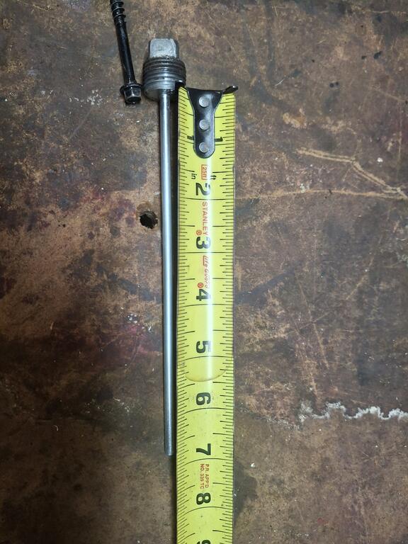

702854boy 1,199 #4 Posted September 6 What is the proper length for the lipstick on these? Mine is 7 inches and the fluid is just barely on the stick after putting 4 quarts of atf in 1 Share this post Link to post Share on other sites

squonk 48,314 #9 Posted September 7 (edited) @702854boy Wheel a Matic dip stick length is 7" Edited September 7 by squonk 3 Share this post Link to post Share on other sites
702854boy 1,199 #10 Posted September 7 So I need to add more fluid even though the manual said 4 quarts? Share this post Link to post Share on other sites
squonk 48,314 #11 Posted September 7 Clean ATF is hard to see on the stick. I think @Achto paints his sticks white. I usually take a Q tip and starting above the full mark, dab the stick until I see fluid on the tip 1 Share this post Link to post Share on other sites
702854boy 1,199 #12 Posted September 7 I had laid the stick on its side one a clean paper towel and nothing was on the rag 1 Share this post Link to post Share on other sites
squonk 48,314 #13 Posted September 7 1 hour ago, 702854boy said: I had laid the stick on its side one a clean paper towel and nothing was on the rag If you stick is the correct length Add a little at a time until it shows full 2 Share this post Link to post Share on other sites
